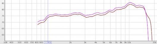

Here are sound output measures of a single Dayton-Wright cell with two levels of voltage, 1500 and 3000 v. Mic about an inch from diaphragm.
The output to the DW cell from a DW transformer appears as the yellow curve. This curve was taken (1) with no ESL load on the transformer and (2) may not correctly represent the top frequency drop-off since the load presented to the transformer by the REW test set-up does not present a very high input impedance.
Changing bias on this rather widely spaced, high diaphragm resistance cell from 1500 to 3000 requires about 20 minutes to reach close to maximum output.
Ummm, looks like ESL bias theory is roughly correct.

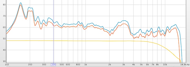

And with the same set-up using a Dayton-Wright transformer (with the output curve as shown in the previous post... this is with a quite flat curve for input to the transformer to roughly 15 kHz), again about 1 inch mic spacing, a single Dennesen tweeter cell (4 used in my curved tweeter array).
Curves are 750 v versus 1500 v bias. This cell gets to full bias charge in a few seconds.
Ben
Ben

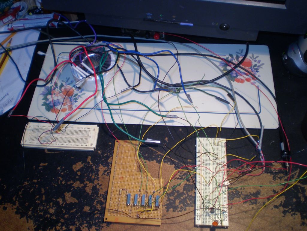

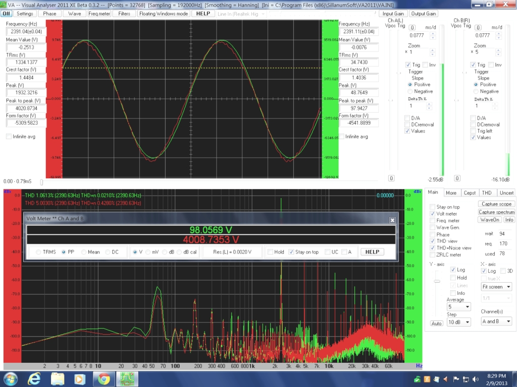

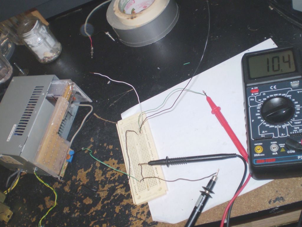

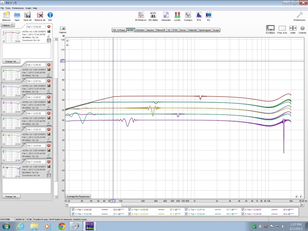

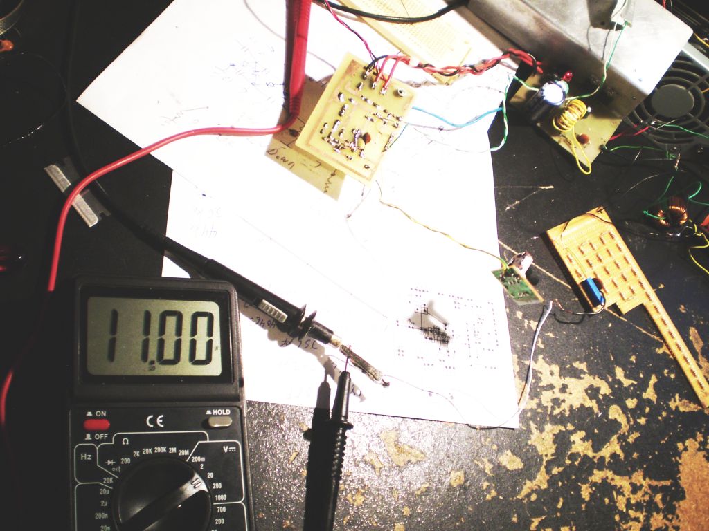

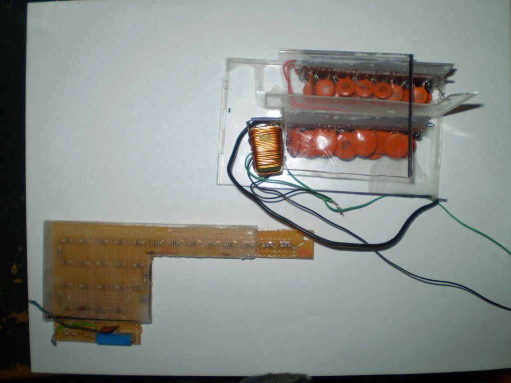

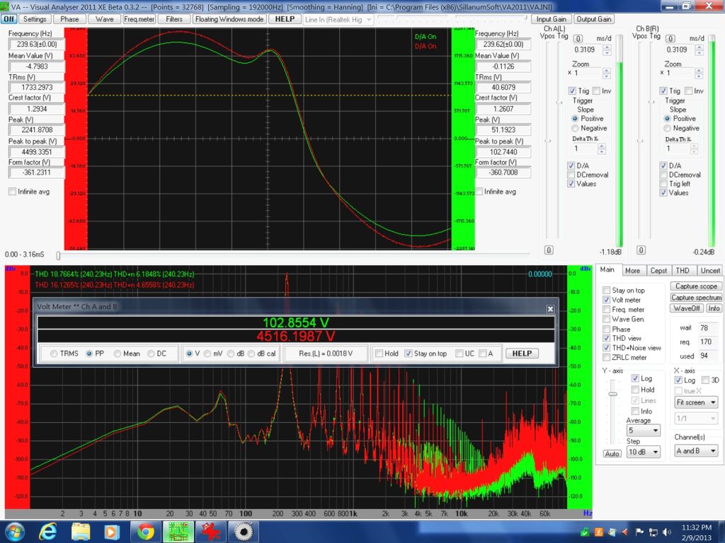

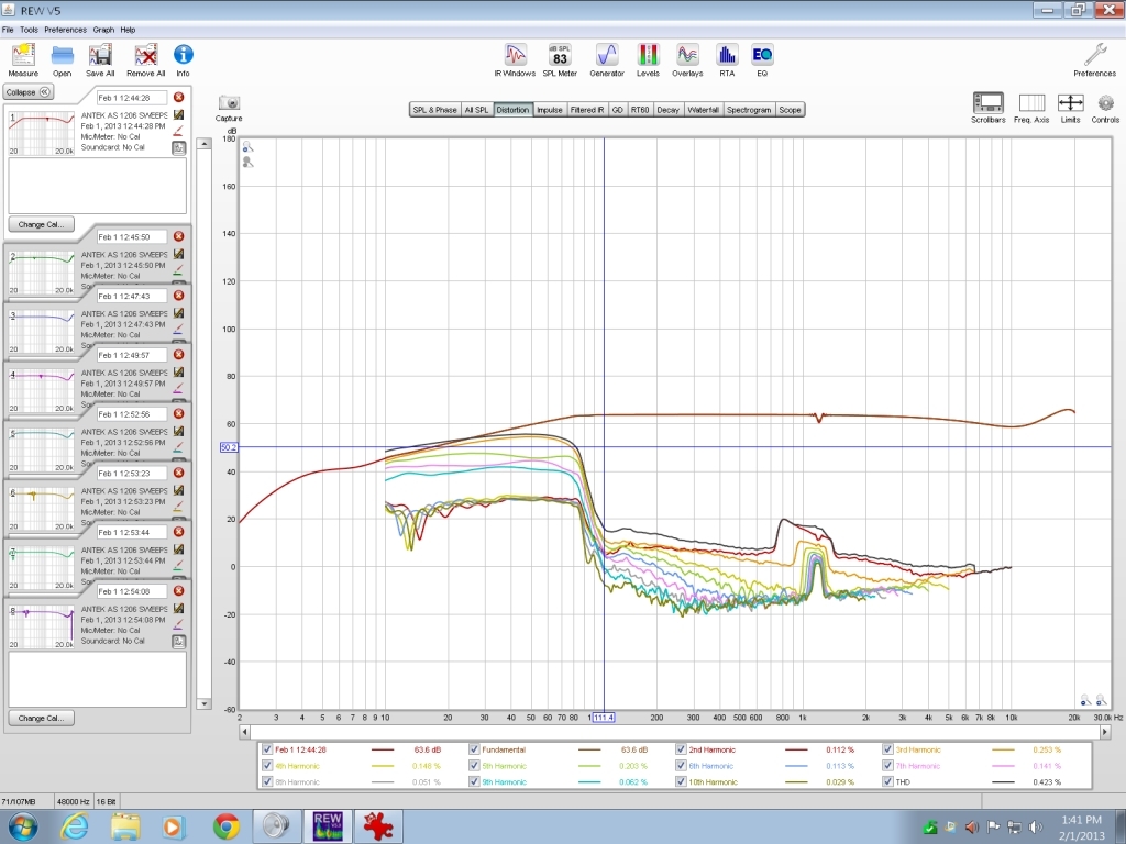

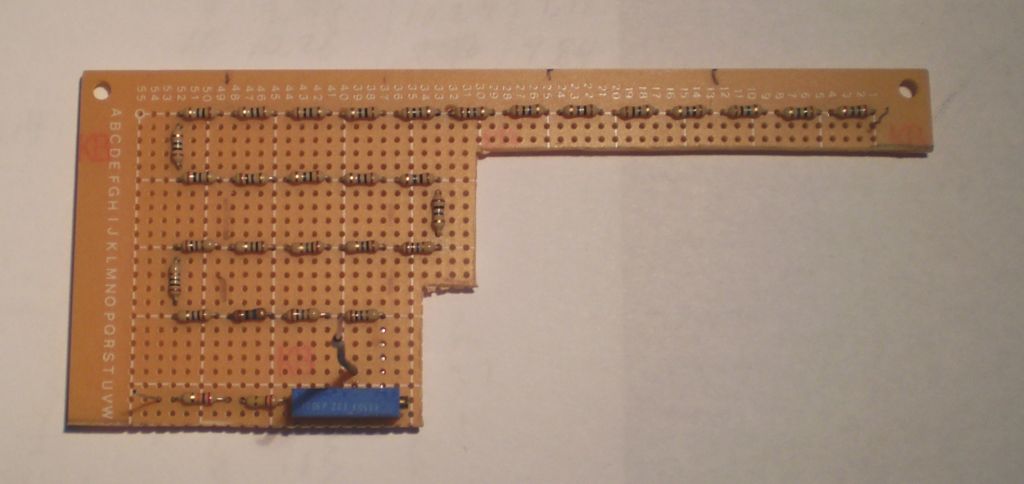

You might want to build jig like the one I have presented before
in order to get some very accurate measurements,
A TEST JIG FOR FINDING ESL STEP-UP TRANSFORMER PARAMETERS
It has been well worth the $5 or $10 investment for me!!!
You can build the divider with a higher resistance if you like, I just happened to only have enough resistors on hand to make this 20Meg version after building one for my variable HV supply.
I can measure the output of the step-up directly into the computer using REW or any other RTA, FR, or FFT program with extreme accuracy!!
And it also provides for highly accurate DC measurement's with your simple average DMM as well! 😉
Here are some pictures of the two versions I have made and some sample measurements.
The values on the DMM are in KV.
Do, use an opamp buffer in order to isolate the meters impedance form the output of the voltage divider, the result will be the most accurate measurements you can get for AC and DC measurements.
These where actual measurements from the out put of an Antek AS-1206 as a step up transformer and the 8th photo shows what happens to the voltage coming fromit at the onset of core saturation.
The glitches you see in the REW graph's were caused from my onboard sound system and my add-on sound cards don't not do this.
Enjoy, FWIW !! 🙂
jer 🙂
AS 1206 Saturation at 20v-10v-5v peak input 6v and 12v primary.jpg278.1 KB · Views: 136

Good test design for the audio interface. But the input side of the transformer shouldn't need high input impedance test instruments (because it is driven by a low output impedance amp).
Till now, I've measured output voltages with a 1(??) megOhm ACVTVM. One megOhm might load a 1:100 transformer, dunno.
To use REW, I'll need to revamp my 100,000,000:100,000 probe (which is a 1000:1 voltage divider) because the computer hardware will be inaccurate when in parallel with 100 kOhms.
More troublesome to me is the question of the location of grounds on the two sides of ESL matching transformers and the possibility of cooking gear when I fail to get the grounds figured out right.
High voltage work is kind of like quantum physics in that measuring stuff can be tricky.
Ben

The board I described and made has provisions for both!
It measures the output of the amp (input to the transformer) and the output of the transformer at the same time, as long as your software allows for recording of two channels at the same time.
Or you can use two meters to verify that your input level is exactly were it should be without having to stop and switch the clip leads for every single measurement.
My divider has a 10,000:1 division ratio in order not to exceed a the input voltage level to the sound card of 1V to 2V peak on AC voltages (and DC) as well for 10Kv and 20Kv respectively.
The bottom resistance of the divider is at 2K and has a trimmer for fine adjustment of initial resistor tolerance errors.
Even with just my DMM the error is not very significant at all with its 10Meg input impedance.
By this calculator the error comes out to only .03% with my DMM and even less with the common opamps that have a input resistance into the Gigaohm range,
Voltage Divider
A common multimeter can have an input resistance as low as 20K and this would cause an error as high as 10% lower than it really is.
As do cable capacitance's as well for AC measurements.
The very high input impedance of your average unity gain FET input opamp eliminates any of this error, and, any loading effects that changes with frequency that occur from the cables capacitance and the sound cards input impedence.
Any measuring device needs to have a higher impedance than the device it is measuring and the higher this is the more accurate the measurement is, for the most part.
Originally I deliberately designed it with a low output impedance of 2K thinking that this would be low enough to not worry about such errors.
But earlier test showed that I was still having a significant amount of error at the high end of the scale with a drooping curve when I knew that my amplifier produced a Ruler Flat FR.
And adding the buffer opamp's fixed this.
You can even power the opamp(s) from a 9V battery if you wish, the circuit is so simple and doesn't require but maybe 10ma to power the opamp(s).
I created this circuit especially for making these types of measurements.
This is a very small investment to have, to get some very accurate measurements easily.
Cheers!!
jer 🙂

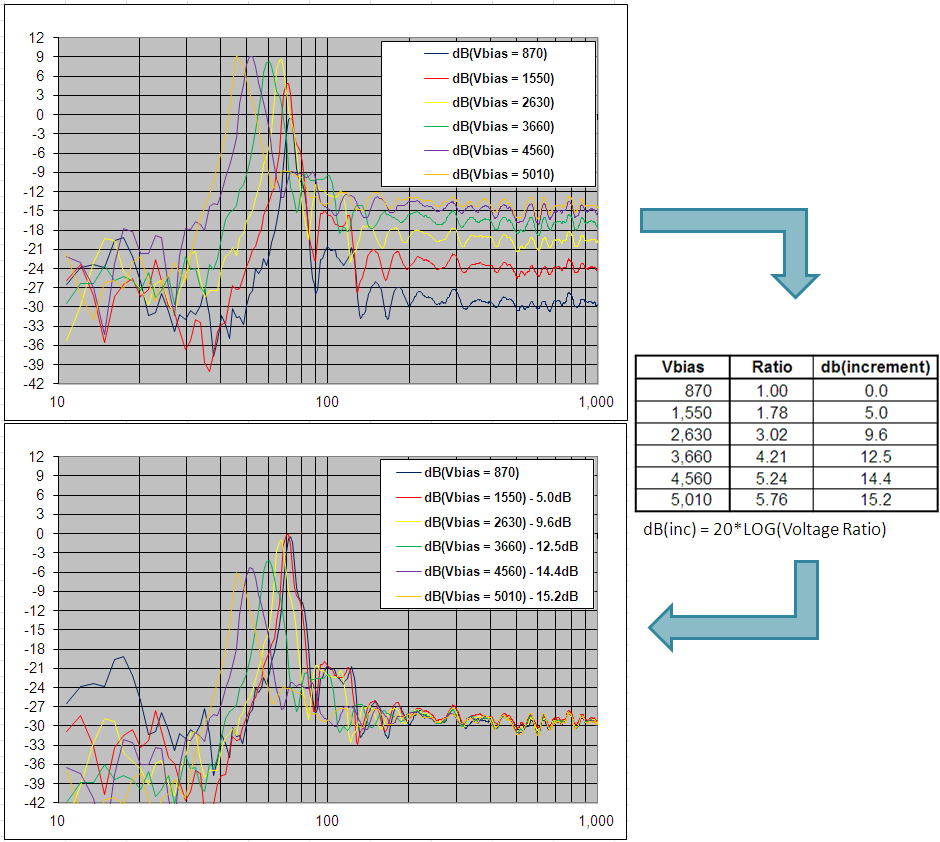

Just curious how you set/determined the bias voltages? Your plots only show a 2dB – 3dB difference in output when doubling the voltage should result in 6dB increase. Did you completely discharge supply and ESL before setting the 1500V level and measuring?…Changing bias on this rather widely spaced, high diaphragm resistance cell from 1500 to 3000 requires about 20 minutes to reach close to maximum output.
SPL-vs-Vbias
Thanks for guidance.
Jer - 10,000:1 probe sure sounds nice.
bolserst - Connecting the probe ground to centre tap does help albeit at twice the effort, if you want to eyeball both sides of the winding.
In as much as my interests were elsewhere last week, I was just in passing noting the crude relationship between crudely assessed bias voltage and crudely assessed sound output. Since I am surprised when I find any regularity in data, I thought I'd create a new thread just to document this.
I "measured" the bias voltage by adjusting the input voltages to my EMCO high voltage black-brick using a $10 VOM (EMCO claims the output is linear with the input). Golly, measuring within 50% of theoretical expectations I consider (almost) a bulls-eye hit. Do you think a guy like me could ever pass an engineering course?
Ben

The purpose of connecting the probe ground to the center tap is to avoid introducing a loading on one half of the winding vs the other. It is the only way I found to get accurate HF measurements with a single ended probe that matched those from a friend's fancy differential setup. You're right though...it is added effort.Connecting the probe ground to centre tap does help albeit at twice the effort, if you want to eyeball both sides of the winding.
Hey wait a minute...with your references to use of Bell Labs equipment, I thought you were an engineer 😉...measuring within 50% of theoretical expectations I consider (almost) a bulls-eye hit. Do you think a guy like me could ever pass an engineering course?
Often just getting data that trends in the same direction as theory seems like a great triumph.
In the case of bias voltage, I have found ESL output to track theory surprisingly closely as shown in the the previous post I linked to.
Just for fun(since I stumbled on the data) I took the NF response sets I collected for the current source thread
http://www.diyaudio.com/forums/plan...rrent-vs-voltage-drive-esl-7.html#post2366501
and compared output vs bias voltage for frequency > 200Hz (ie above diaphragm modes)
Top plot shows response as measured with near field mic placement.
Bottom plot shows overlay if each curve is adjusted down by the theoretical increment for ratio of bias voltage relative to the lowest (870V) curve.
The results were pretty satisfying, with all curves stacking nicely on top of each other.
