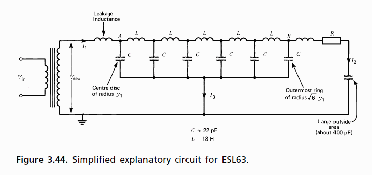

The first attachment shows the simplified ESL63 model that Baxandall provided in his chapter on ESLs.
It uses the unbalanced form of the delay network rather than the lattice form.
There is a fair amount of coupling between the inductors since they are stacked side by side.

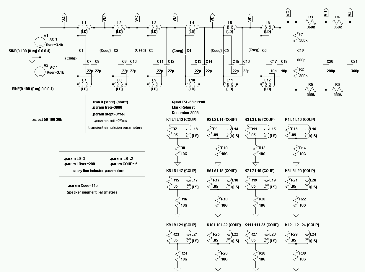

The second attachment shows a SPICE model that Mark Rehorst(diyAudio member I_Forgot) had been working on.
Plotted results and SPICE netlist are currently still available here:
Quad ESL-63

I haven't had time to read it but I will. Perhaps I need not ask this question if I had - but in that first image of the non-balanced all-pass filter are the capacitors actually the ESL stators, or are they physical capacitor components?
18H is massive! I had no idea the inductors were that big... my god!

re ESL -63 inductances: I think you will find that to compensate for the inductor winding capacitance and coupling between inductances, Walker has added a criss-cross network of 22 pF capacitors across each segment (see Mark Rehorst diagram in previous post) , which, in addition to the 22 pF anular capacitance of the stators, means the actual capacitance per section is 3 x the 22 pF drawn in the equivalent circuit. This in turn means only 6 H of inductance per stator segment is required, and this is formed by two 3 H inductors, one in series with each of segment of the two stators. So the actual inductors are 3 H (still big for air cored devices). This means too, that only 1/3 of the stator current is responsible for the acoustic radiation.

...in that first image of the non-balanced all-pass filter are the capacitors actually the ESL stators, or are they physical capacitor components?
Yes, the capacitors in the simplified non-balanced schematic represent the ESL stator rings.
Give the Baxandall text a read, and you will better understand how the lattice circuit relates to the simplified model. He also goes into detail on the purpose of the cross capacitor networks and the shorted turns.
If I recall correctly, Baxandall states the value of the lattice inductors are 3H although the effective value is larger due to the mutual inductance with the other inductors. Still massive though, and they have to be able to handle several kVrms too.
