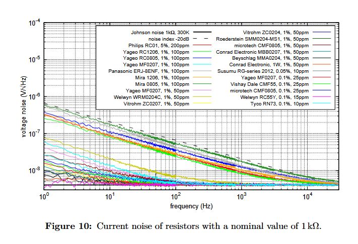

Here is a resistor current noise graph from LIGO (https://dcc.ligo.org/public/0002/T0900200/001/current_noise.pdf):
Current noise of low noise thin film resistors is only slightly above thermal noise with noise corner well below 100Hz. I would assume other factors in DACs produce more 1/f noise than these resistors.

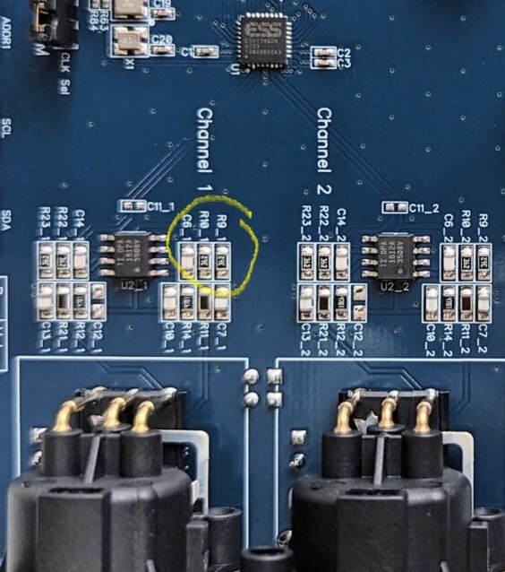

They say the schematic comes from their evaluation board. Could be they just used parallel resistors in case anyone wanted to easily try changing the gain. Maybe they didn't even know when they designed the evaluation board what resistors they would end up using. Wouldn't be the first evaluation board with something like that.

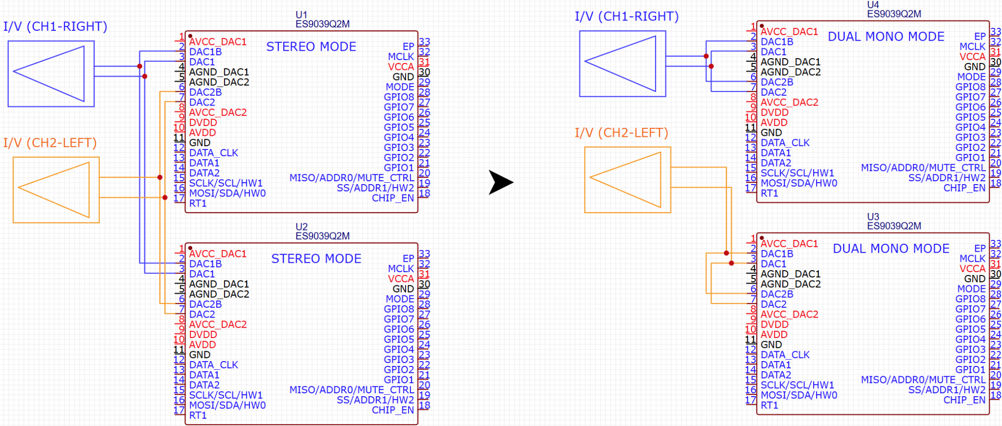

Hi, I have a question. I did not find any explicit registers for the ES9039q2m to switch to DUAL MONO mode, is it possible to configure it to be mixed in this way? REG 34 "DATA PATH CONFIG" 7 bit "MONO MODE" is not suitable - it simply activates one PATH CH1 and the second remains disabled.DualMono3.png
