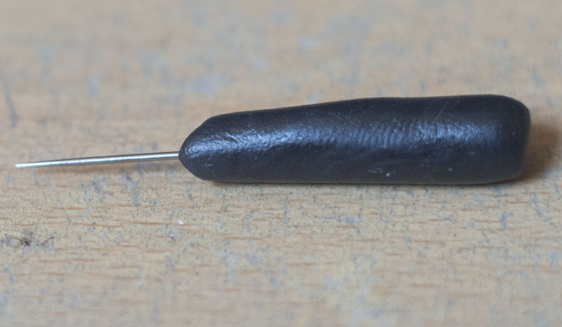

I liked Mark's suggestion to use a stainless steel needle to poke through solder locking holes in the board, so I made a little tool from a needle and some epoxy clay to form a handle:

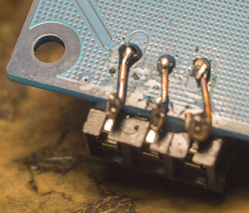

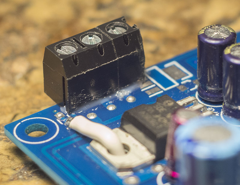

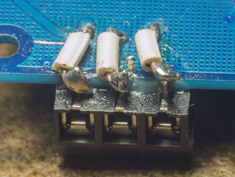

The only progress I've made on my board today is to fit a set of screw terminals in preparation for powering it from an external PSU.
Because this blue version doesn't have holes drilled in it for mounting such terminals I just expoxied the terminals onto the board.
Then I used three little pieces of copper wire to connect the pins of the terminal block to the solder pads on the underside of the board:

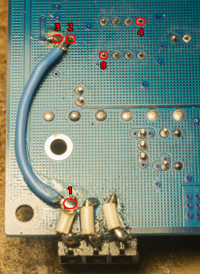

Ian, You have the white wire shorted to ground, it sure looks like. The points on the board you have labeled 1 and 4 are negative power and ground, respectively. The point you have labeled 3 is the positive power. The point 2 would be where the dual supply would connect to ground (assuming you cut the trace I put an X on in the picture I posted. You should be able to check by measuring from point 3 to ground, it should charge up some capacitors so the resistance should appear to climb and eventually stop. It should not be low resistance to ground.
Also, on the bottom of the board where you have soldered on some bare wire to the terminal strip, that crosshatched looking part of the board under the bare wires is the ground plane. There is only a very think layer of green solder mask insulating that area and solder mask is not really intended to be a reliable insulator. So, it looks like a big short circuit waiting to happen.

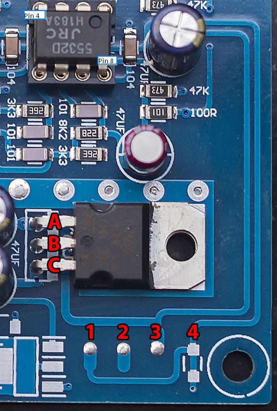

I will post a picture of where you need to measure. You should measure to the power pins on the opamp, pins 4 and 8. 4 is negative and 8 is positive. Obviously they should not be shorted together or measure a low resistance between them.
Also, if you go back to the first picture I posted for you of this part of the board I labeled the polarity of the power pins for you. You remember that, right?

Hi Mark
That's very helpful, I'm understanding now. I connected my repair wire to point 4, so it is connected to the negative power (1) but also to ground because I haven't cut the trace connecting 4 to ground yet. I do indeed remember the picture you posted, I saved it to refer to.
Should I now go ahead and cut that trace between 4 and ground?
I didn't realise that about the ground plane on the underside, I'll have to fix that, I'll replace the bare wires with insulated ones, thanks for catching that error!
So, first thing I will do is replace those bare wires with insulated ones, then I shall make the measurements to pins 4 and 8 on the opamp and report back. Cheers!

I took some measurements with my meter in continuity mode:
pin 4 on the op amp to the negative solder pad I labelled 1 shows good continuity
pin 8 on the op amp to the positive solder pad I labelled 3 doesn't, the meter shows a reading of 1.601 but doesn't beep to indicate good continuity
Might mean the trace under the burned cap lead is also a little burned on top of the board underneath the cap body. Maybe a good idea to get the cap out of there and take a look. I would recommend heating up the lead that is not burned while adding some fresh solder or at least flux and trying to wiggle one side at a time up as much as it will go without excessive force. Once a little gap starts to open between the body and the top of the PCB you can stick a little screwdriver in there a pry while heating and adding solder/flux on the bottom to continue coaxing it out. A small vice to hold the PCB can make it go a lot easier. No doubt the cap can be removed and any trace/board damage repaired. Please ask if unsure about any problems you may run into.

So, I removed the cap and everything looked fine underneath so I threw the cap away, soldered a new one in place and also changed the jumper wire so it goes direct to the negative terminal.
I get a good circuit between 1 and 2, but there is no continuity between 1 and 8. What puzzles me is that there is also no continuity between 2 and 3, which are the two pins of the capacitor, and I do have the cap the right way round, I triple checked that.
So now I'm confused....
I figured out the problem, the cap pin marked 3 on the picture in my last post is somehow connected to the ground as there is a circuit between the ground terminal and pin 3.
