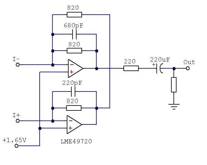

I made a little PCB with the ,,Victor,, I/V
I have not tested it, since my dac fried.
I could post the PCB schematic ready to make your own PCB,if someone is interested.

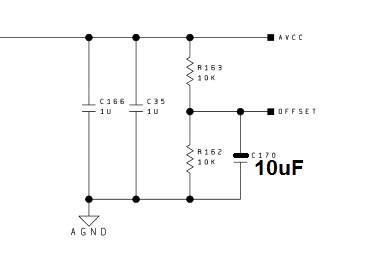

Including this one on the PCB.
The 1,65v out of the 3,3v.
Yes you can always make your own spiderweb.
