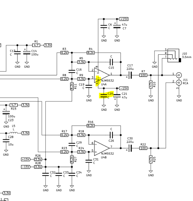

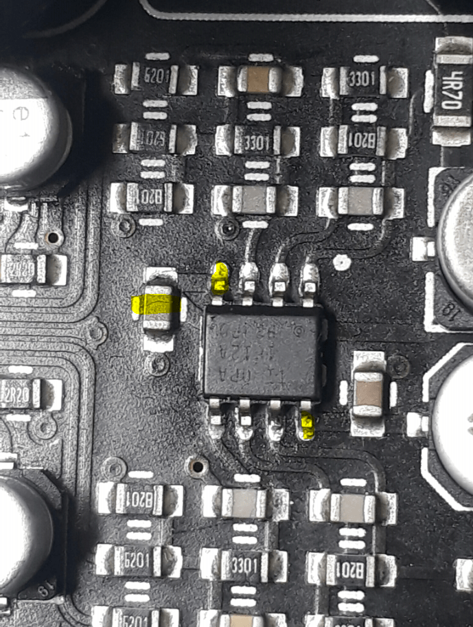

Either the DC/DC converter has failed or the opamp or some decoupling capacitor on the -15V. The measured resistance between pins 2-4 (-15V) is far too low. Since you already replaced the DC/DC converter I would guess the root cause is elsewhere.I removed DAC from Pi and power it on, measure it. Input pins 1, 2 are ok (5vdc and 0v).
Output pin 4 is about -1.4vdc, pin 6 is about 5vdc only. Power it off, and check ohm values from pin 1 to 4, 5, 6 are infinitive. Pin 2-4 are 130ohm, 2-5: 0ohm, pin 2-6: 4300ohm.
Does this indicate that DC-DC converter failed again?
Thank you. The input/output caps are there (SMD).Here is the DS for the DC-DC : note the recommended output caps are rather small values (470nF) :
https://www.mornsun-power.com/html/pdf/A0515S-2WR2.html
That's helpful, thanks. So I take it that the cap you substituted isn't on the output of the DC-DC. Yet the DC-DC powers the OPA1612 and that opamp has local decoupling with a couple of SMD 'lytics as best as I can tell from your original pic. Which almost certainly takes the capacitance on the DC-DC output beyond the DS recommendation. How far beyond though I can't tell but it doesn't build confidence in the design when Mornsun's DS recommendations seem to be being ignored.

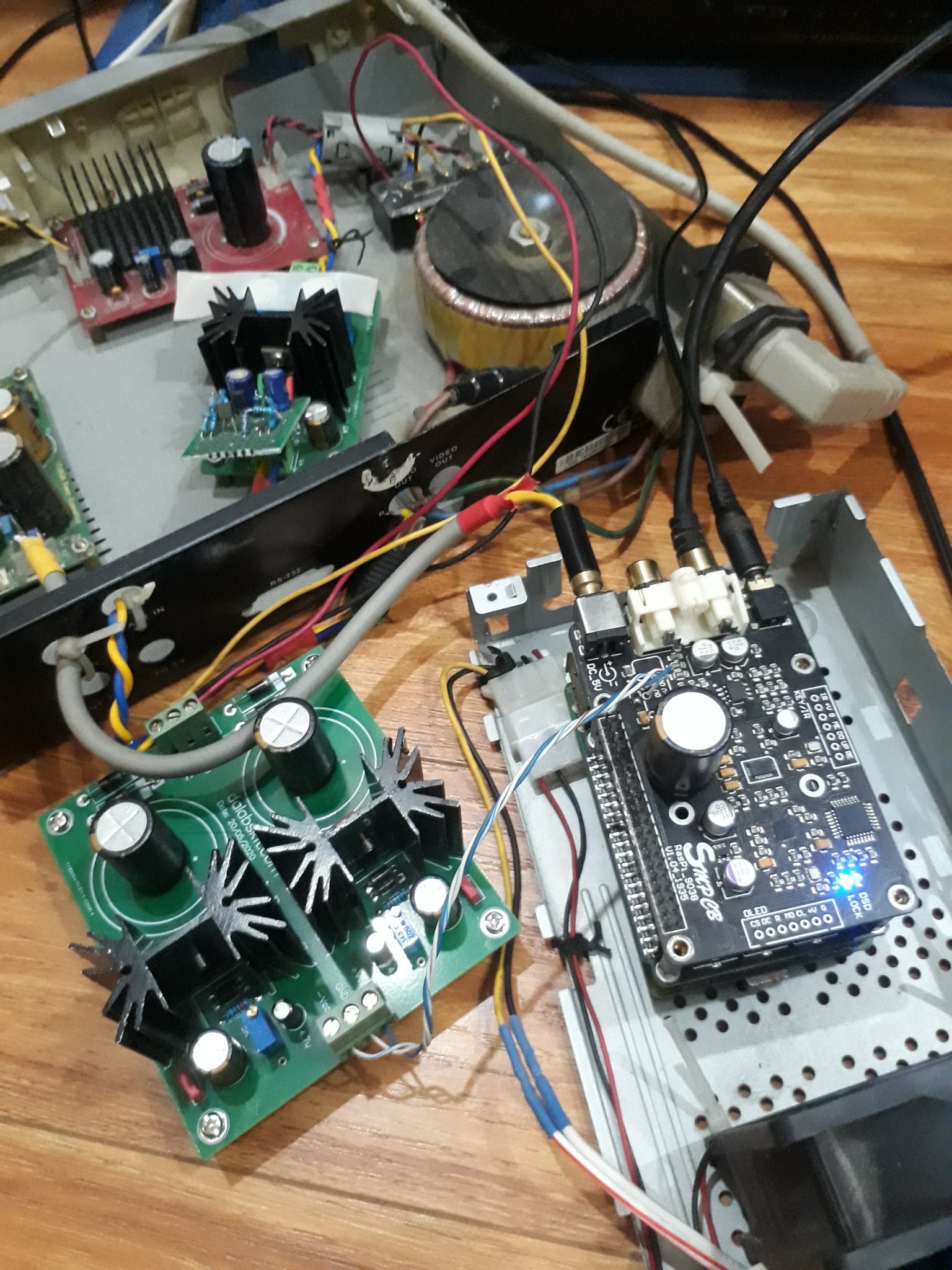

Now I made psu lm317/337, but not yet try to connect.
Disassemble dc-dc converter, power off, but the input and output pin are not isolated. pin 2 and 5 is 0ohm, pin 2 and 4 is 130ohm. 1-4 about 1300ohm (but it's not stable). 1-5 1000ohm. 1-6 infinite. If I connect external psu (+-15vdc), is it safe to pi under?
Thinking to buy new DAC.

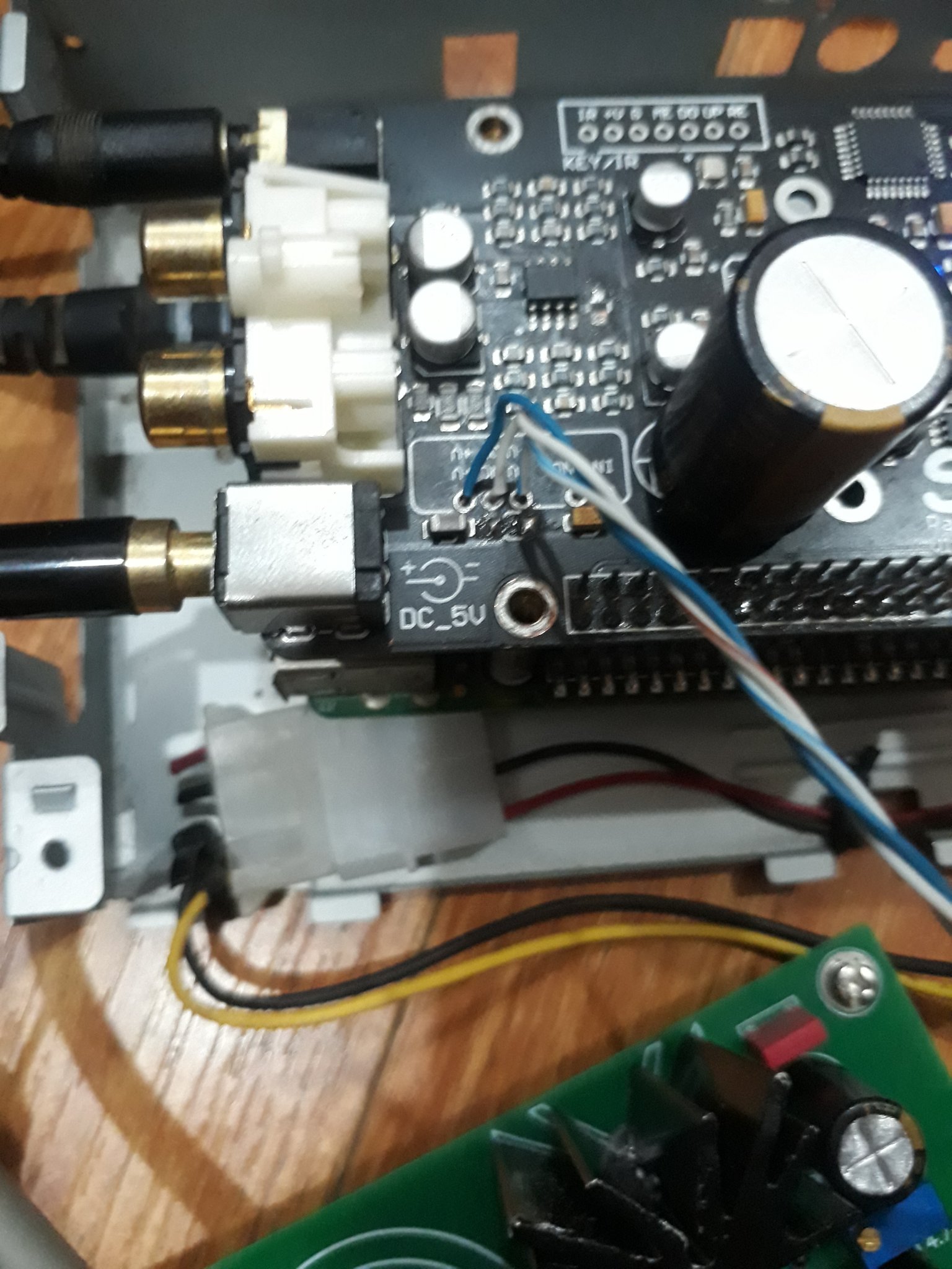

Update: connected ext. psu, negative line (Lm337) was so hot even I used very big heatsink . Do not know why it draws too much current. There were not -15vdc or +15vdc at pin 4, 8 of opa1612
Take a needle and unsolder-lift pin 4 and 8 of opamp and connect the dual power supply. If it is still hot than remove 2 smd ceramic capacitors near 3pins. I had some cases with damaged ceramic capacitors. If no voltage is on opa1612 than check if i see right there ar 2x4r7 resistors...they can be part of a Rc filter and can be burned, if opamp is defect

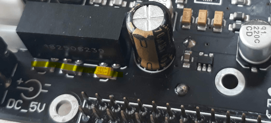

Found a crack on Ceramic smd cap near pin 4 of opa1612. Does anyone know the value of that cap?
I measured from grnd of DC jack, to pin 4 (or upper pad of failed cap) is 6 ohm; to lower pad of failed cap is less than 1 ohm. to pin 8 is about 16k ohm.That crack may be a result of OPA1612 failing. Remove the cap and see what resistance is between those pads. If it is still about 130ohms then OPA1612 is faulty.
From dc-dc converter pin 4 to opa1612 pin 4, and converter pin 6 to opa1612 pin 8 are 6ohm.
I will try to remove failed cap and test again.
I found another failed cap which was near dc-dc converter. It's connected -15vdc to the grnd. After removed it, power on, the DAC working again.
Thank you very much for all of your support. I'm just IT guy without knowledge of electronic world but so happy to able to fixed it.

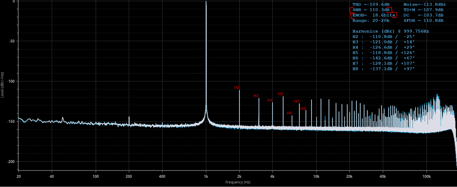

Oooooooh. 1656 as a voltage follower is a hot hot thing. Hot meaning good, appealing, etc.
And even better, 1656 are actually in stock and available from first party distributors.

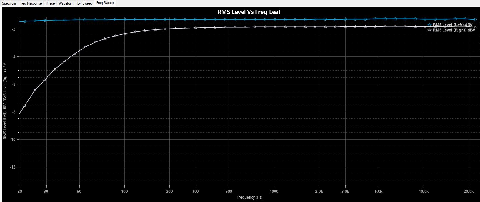

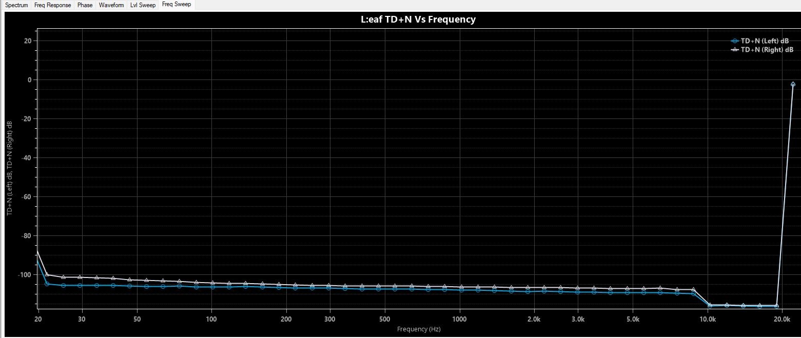

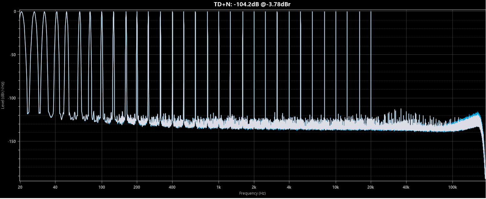

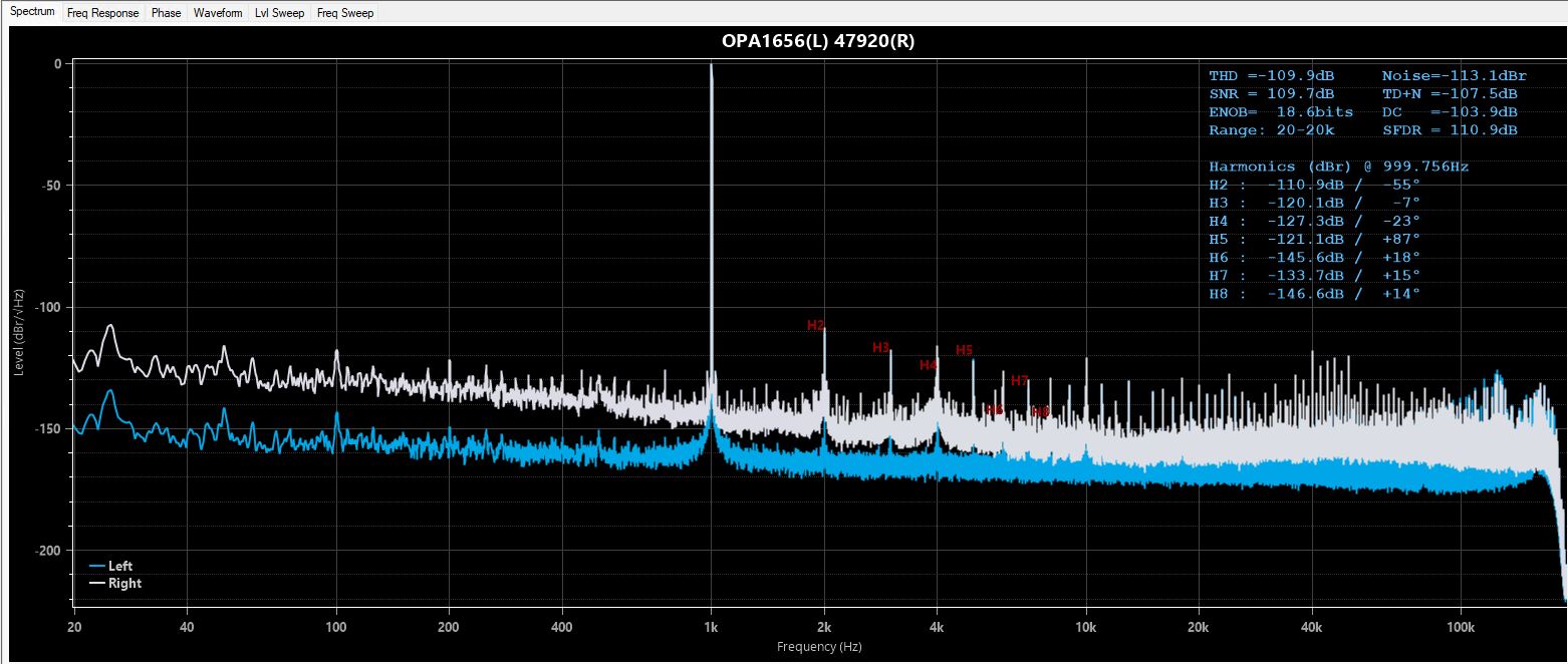

Following up with some more measurements. The OPA1656 is killer in the voltage follower position.
1K FFT: Almost 19 bits of usable range. Nuts I tell you, NUTS. For a cheap DAC anyway.
TD+N Vs Frequency: It measured beyond 20k where the filter wrecks it.
TD+N Vs Level:

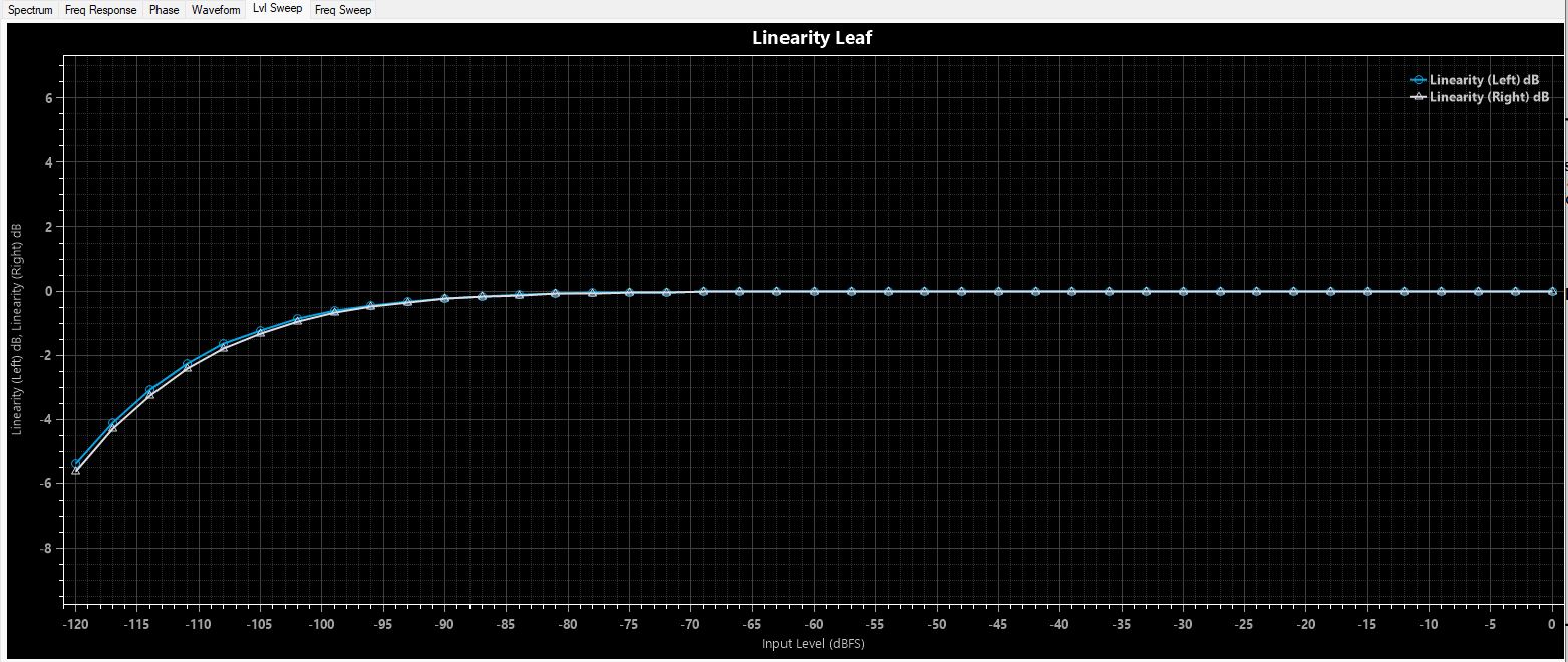

Linearity: Not quite 16 bits of volume control without data loss.
RMS Voltage vs Frequency: I need to re-examine the high pass filter on the right channel. Guessing poor contact elevating the R and lifting frequency while dropping level.

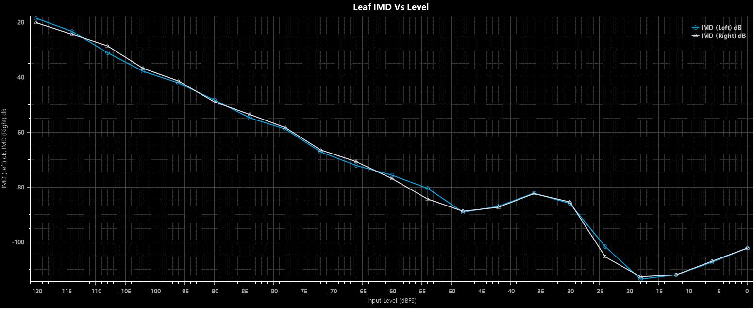

IMD (MASSIVE ESS hump, but TD+N doesn;t seem to care):

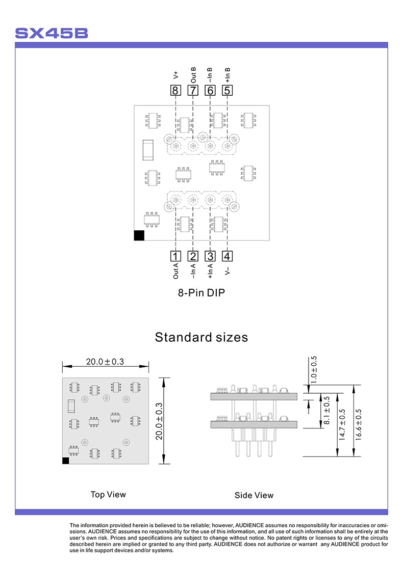

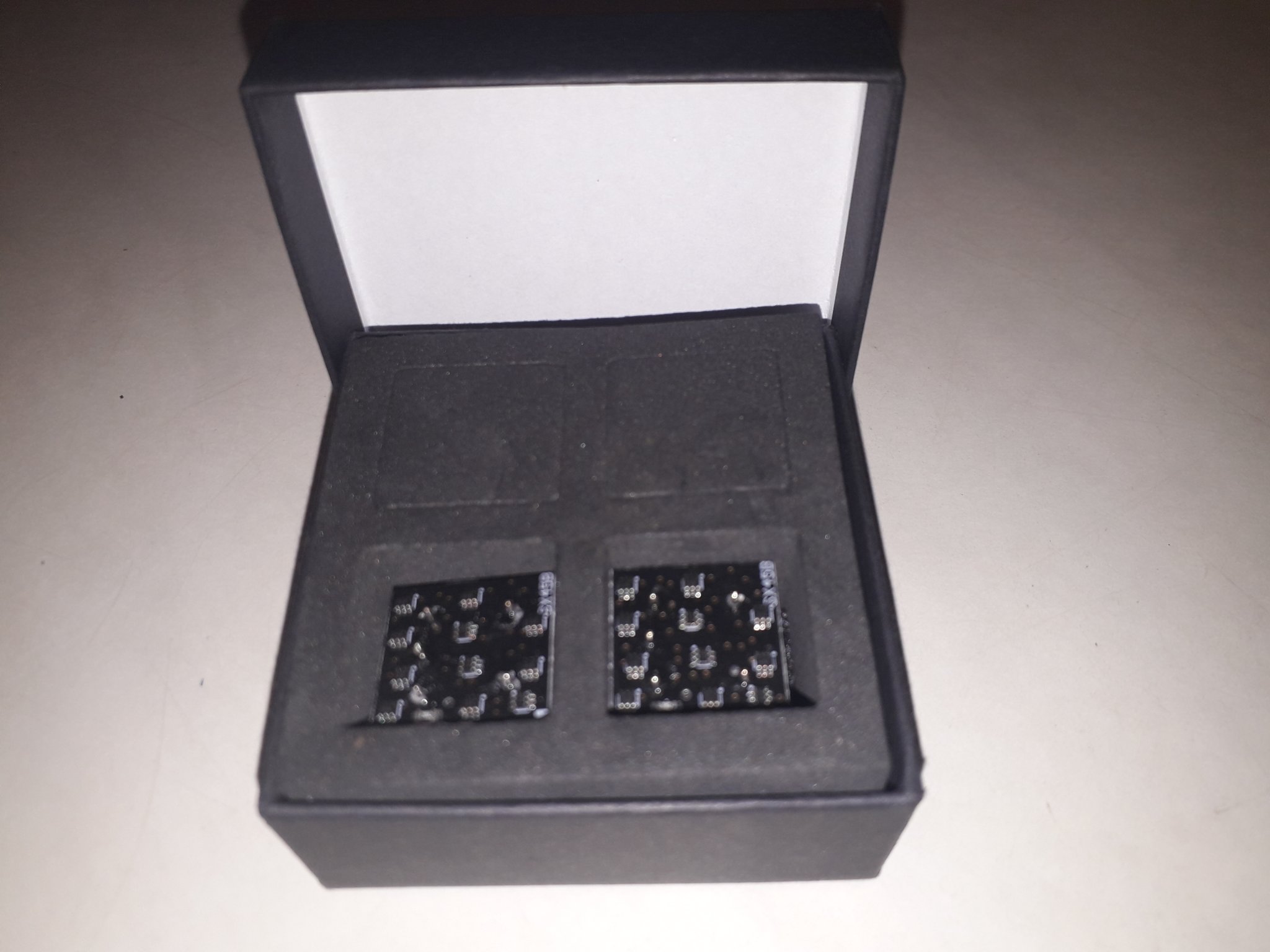

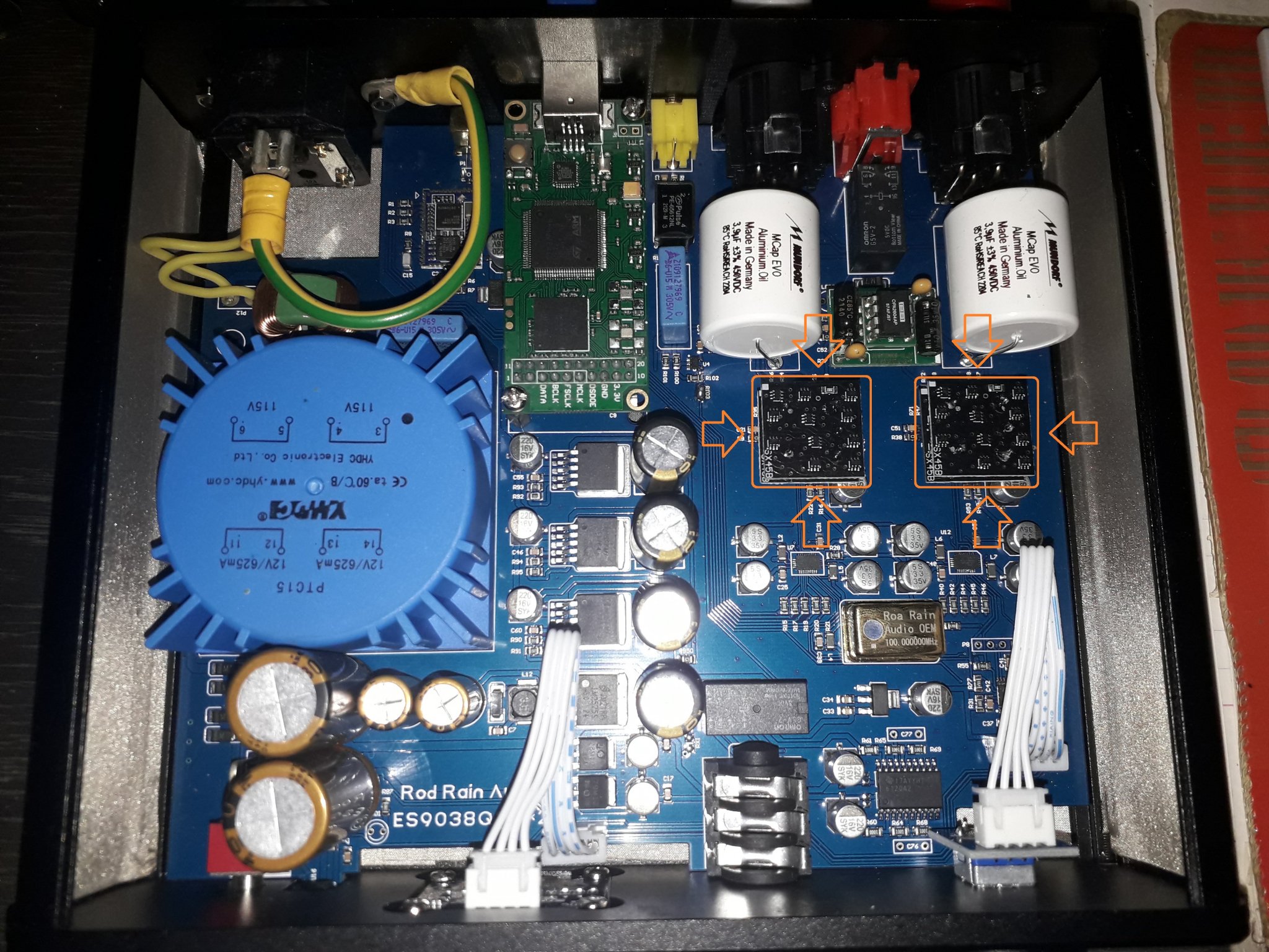

Hello everyone 🙂
Here is a photo of my 'Rod Rain Audio DA10' DAC (dual ES9038Q2M) with its new OPAMPS ->
(other changes are also made)
I still haven't taken any measurements on this device because I don't have the instruments to do so. 🙁
I have tried many OPAMPS and these are what I find the most 'musical', that is my own opinion: this notion is purely subjective since there is no device capable of measuring the quality of musicality...

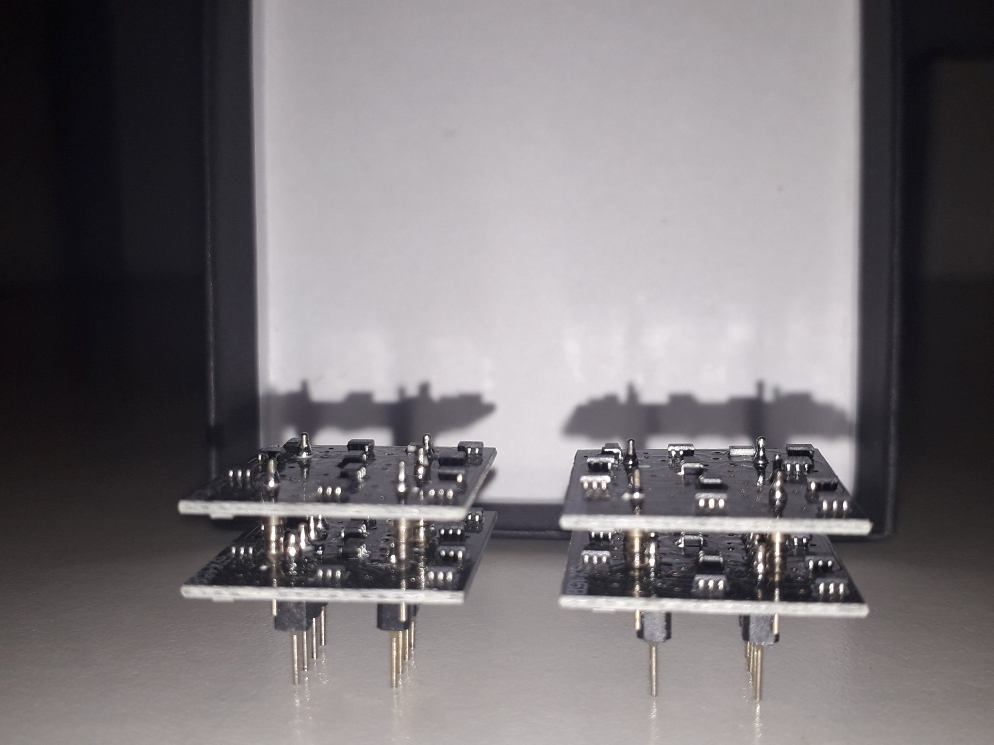

Here are some detailed photos of these OPAMPS and a brief technical sheet ->
Here is the link where you can get his OPAMPS ->
https://fr.aliexpress.com/item/1005..._main.298.41a85e5bptepBB&gatewayAdapt=glo2fra
Regards.

OMG, 230db of loop gain and so HUGE distortions -103db??Hello everyone 🙂

I'm also very curious to know what BJTs can allow 40pA input bias current. Must be something a whole lot better than super-beta devices, they only get into the 1nA realm.
Did you notice that almost all resistors are E48? "Excellent CMRR" really? 😉I'm also very curious to know what BJTs can allow 40pA input bias current. Must be something a whole lot better than super-beta devices, they only get into the 1nA realm.
