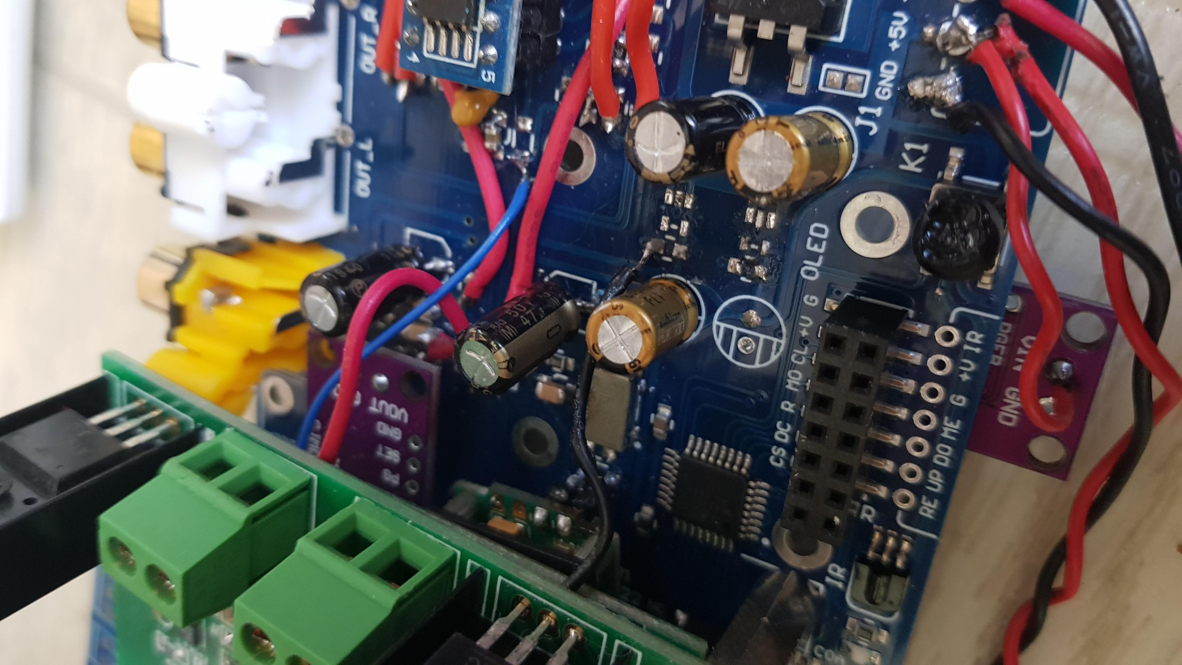

Hi. My job. It's not a finished!
Sound cool.

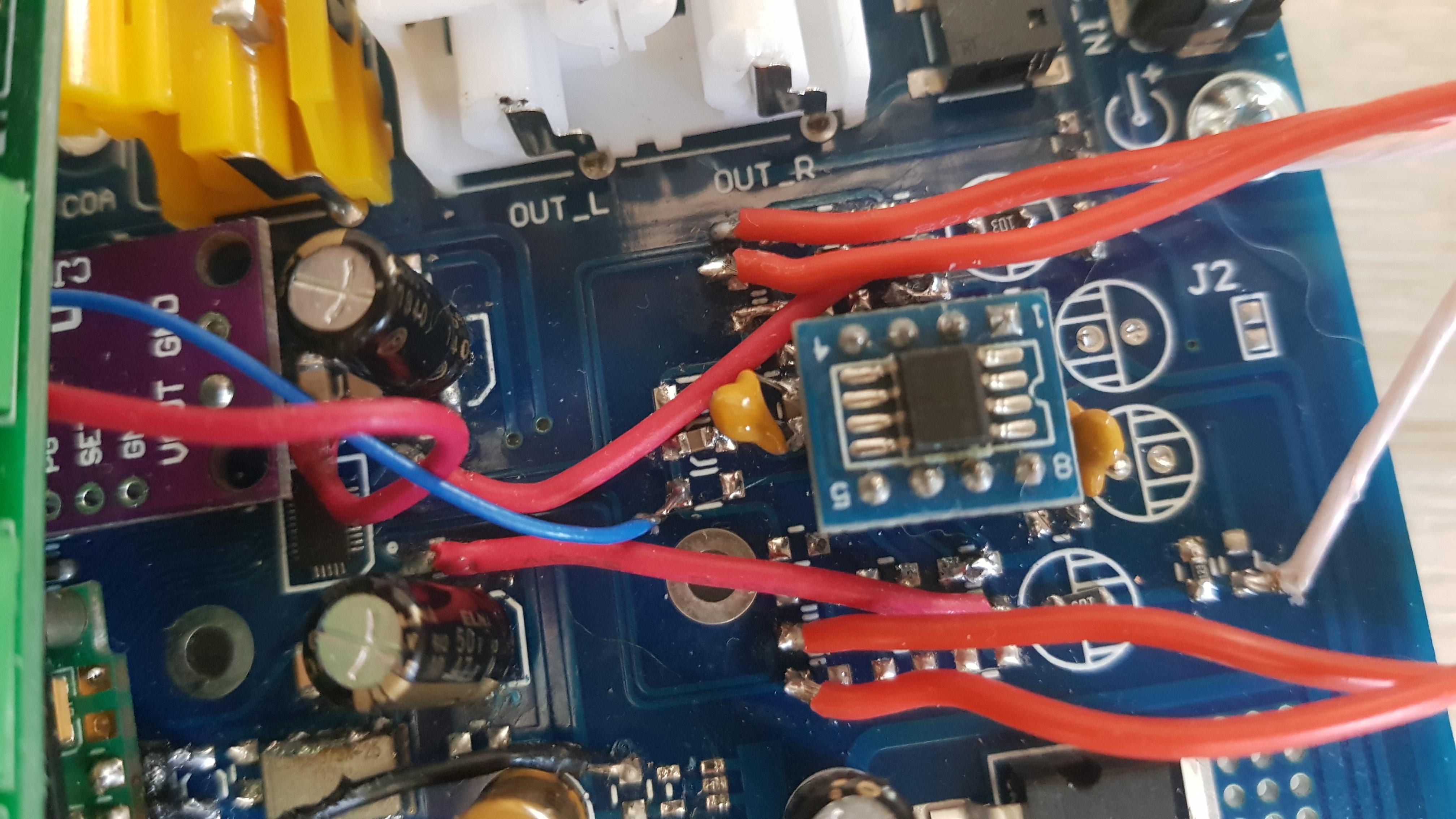

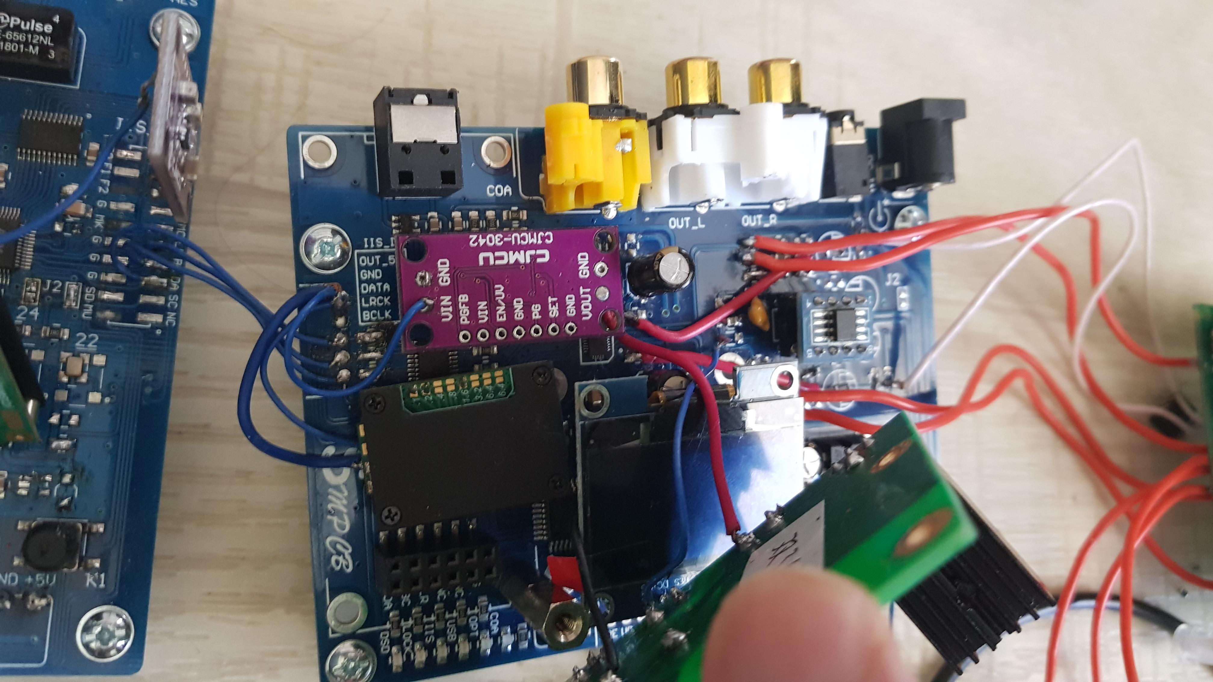

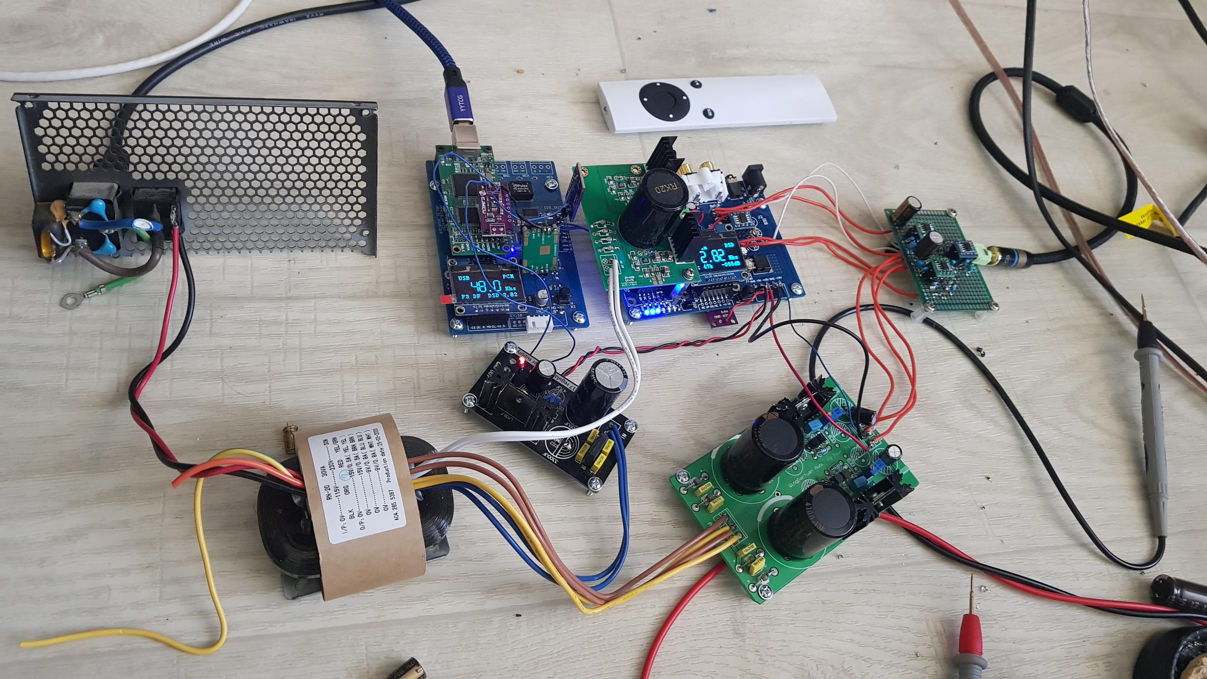

I be happy. A lot of job is finished! I'll replace ldo, not as a picture, for better looking. Everything is fooding of each ldo, with resistors on out. Replace all smd on good quality. I use opa1612. And in avcc opamp too opa 1612, not lm49720. Green board for i/v out and opamp for avcc was remake, now is lm317/lm337. in Ak4137 going 48khz resampling pcm. For es9038q2m signal is dsd 2.82mhz. i have remote control. And have many variables to join my DAC - opt, coax, Bluetooth 5.0 ldac, usb by amanero board with separate ldo. What will i need in future?!)
D50s for me is not interested, very small box. And need money for upgrade. And i'll pay a lot, that in this modification).
Sorry for my English)))

I use opamp for avcc in post 3003. This is talking Mark
Hi 888777,
Looks like you are having some fun there. Good for you!
One thing I did notice is that some of your solder joints look overheated. I couldn't tell if your solder iron has a temperature control? Also, that little sponge that sits at the bottom of the solder iron holder is supposed to be wet with water. Then it will clean the iron's tip much, much better. If you don't want to use a wet sponge, you can use soap-less dry brass pot scrubbing pads or a commercial version such as: HAKKO | Tip Cleaner / Iron Holder | HAKKO 599B
Then of course, always use clean rosin-core solder (or other low temperature electronics solder with flux). If your solder wire is oxidized, you can try wiping with a paper towel or similar until the dark oxidation stops coming off.
Then, strip wires, twist the strands together, and then 'tin' the wire by applying a nice shiny coat of solder to the wire before trying to solder it to anything else.
Cut off any extra length of tinned wire and try to not use any more solder iron temperature than you need. If the iron is too hot it will burn out the flux too fast and the wire insulation with melt back.
My only point is that its worth it to take the time and effort to solder like a professional. It will help you later when you need the skill to do more challenging projects.
Best,
Mark

The problem with OPA1622 is that it is 10-pin device. It has a ground pin that is supposed to be connected to real ground. OPA1622 on an 8-pin DIP adapter is not good. It sorta works, but distortion is higher than it would be with the ground pin properly grounded. Also, its really more of low power, ultra-low distortion headphone amp, its not as good for most dac purposes as OPA1612. It may help to know that both ESS and AKM use OPA1612 on their current-output-dac-chip evaluation boards (all of ESS dac chips, and AK4499).
