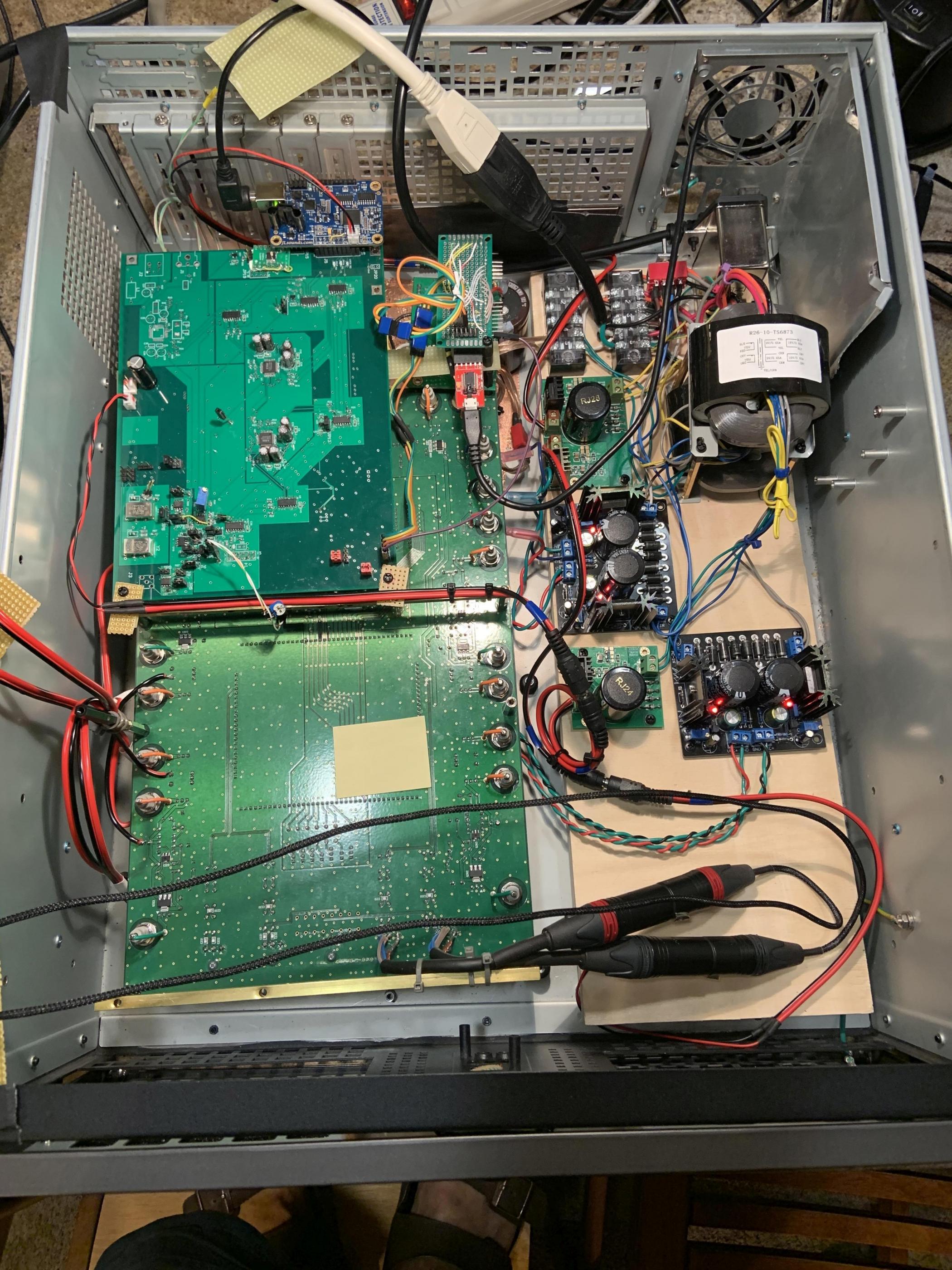

Because things are pretty slow here today, a pic below showing most of the current state of the AK4499 eval board. As can be seen, ebay power supplies work great for everything (except Vref). Easily beats Topping D90 sound. Vocals are not grainy, nor are cymbals. They sound like whatever is on the CD. The eval board itself is upside down and on the bottom. The large-ish green board on top of it is something I made to run some experiments. Some of the circuitry is on the under side. Having acquired some data, a new experimental board is in the works. The Green/Yellow/Orange ribbon cable running around is my color code for I2C bus.

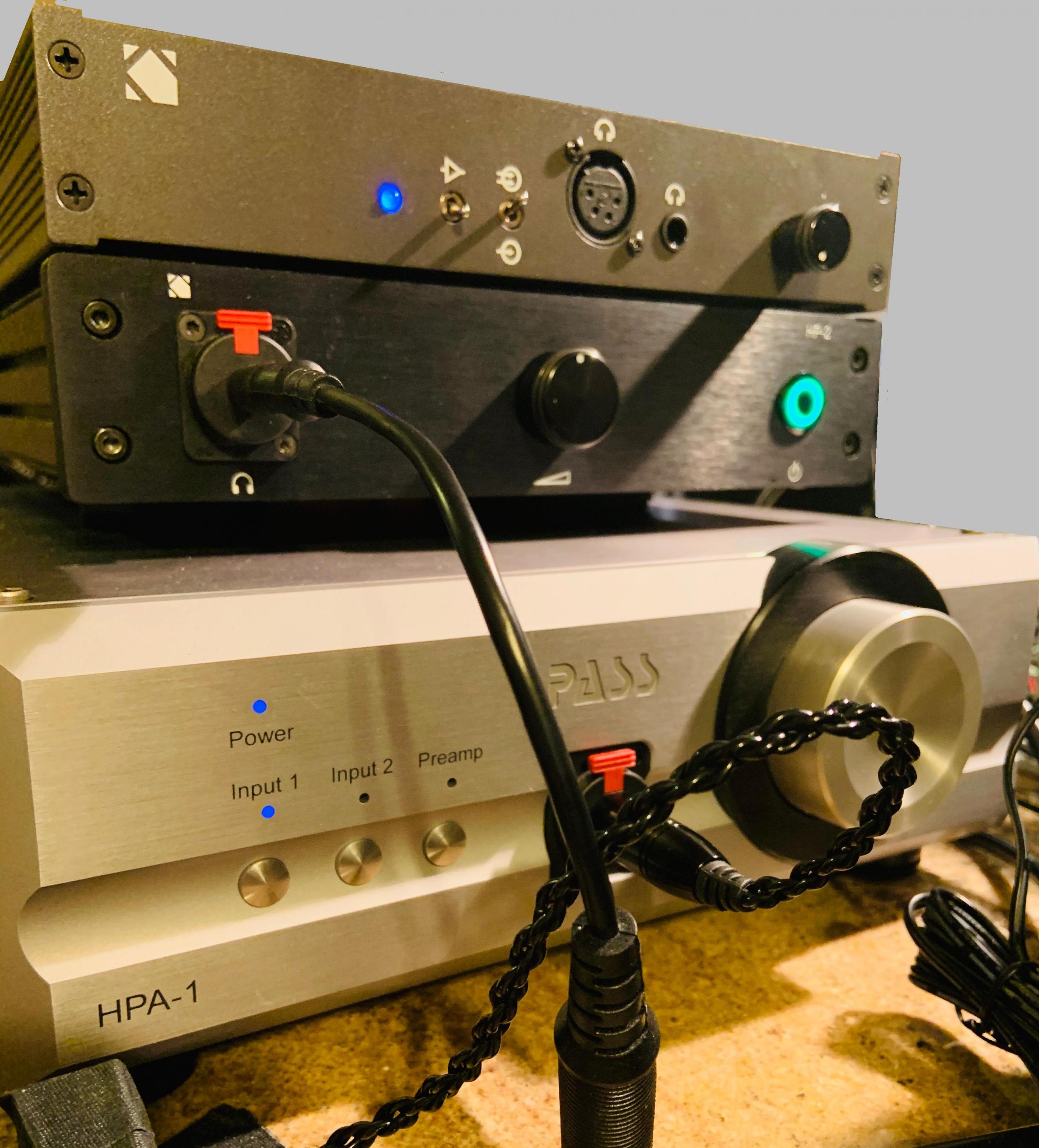

Shown in the second pic is the stack of HPAs used for listening tests. There are two SOA or near-SOA units from Neurochrome, and one Pass Labs HPA-1. They all sound different. Top and bottom ones are my favorites, with the top one getting most of the use by me. When Jam comes over to listen he likes to use the Pass HPA-1, which he knows very well (being the designer of it).

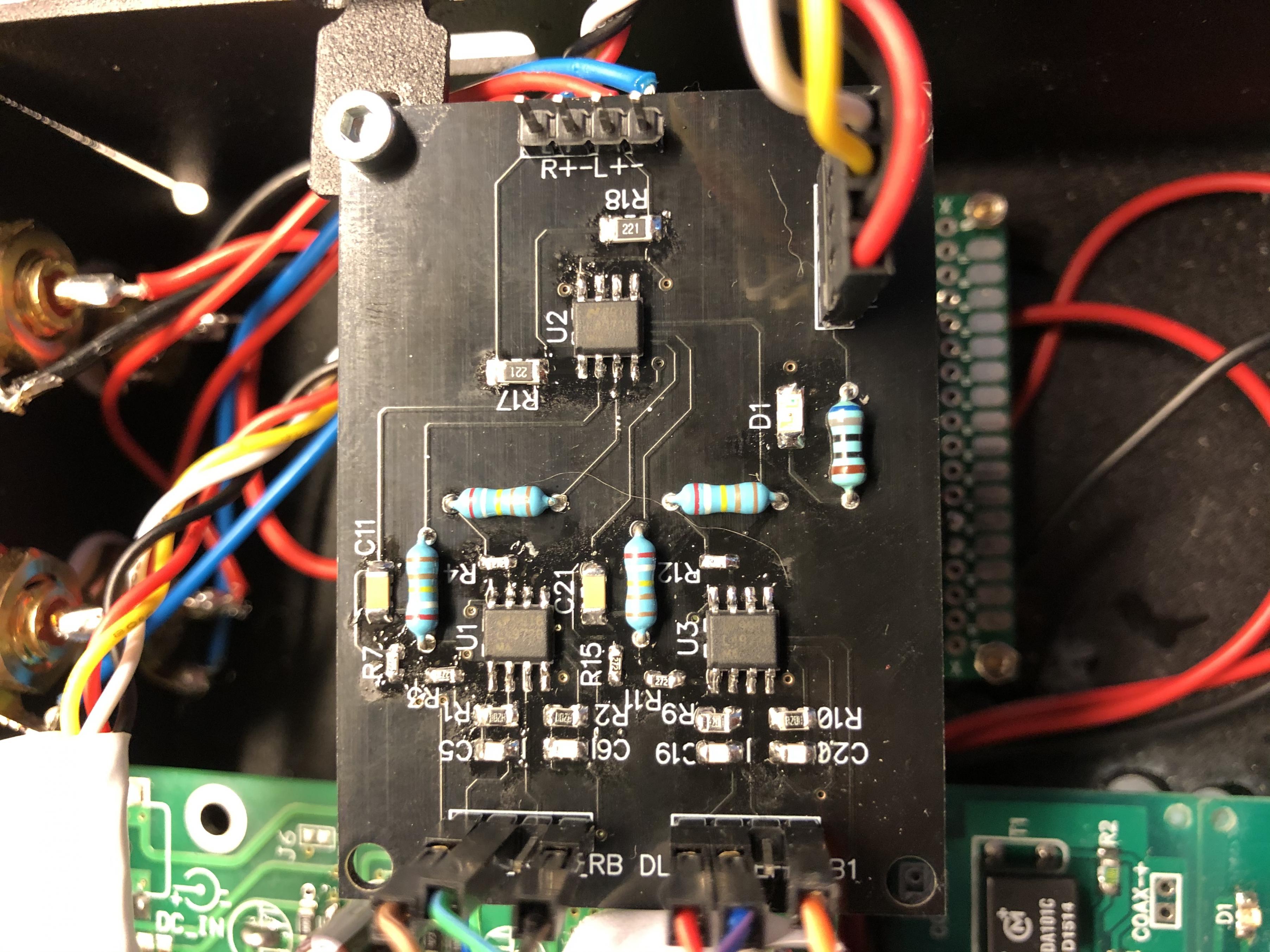

Hi.
Just solder my PCB (not so Nice ) and i think it’s working ok.
I think it’s a big improvment from the orginal voltage mode anyway.
BR//Daniel

Does it has LPF for the 1st stage?
Hello,
Here is the Gerber file for the PCB i use in my dac.
It's from the schematic in post #3003, except that it doesn't have the unbalanced output.
Works for me but can't say for sure that's a correct PCB. And layout are for sure not optimized.
But a nice improvment over the voltage mode OP that are on the orginal dac pcb...
Reason for R13-R16 is throug hole (i put a SMD 1206 in parallel) is that i couldn't find smd parts.
So if anyone want to build this pcb choose either R13-R16 or R20-R23.
D1 and R19 is also an option, i use it to see that dac was on.
BR // Daniel

Daniel,
May I ask what program you used to create the gerbers? If we could look at the source files in the same program then it might be possible to make a few improvements. Hard to say for sure though. Just looking at the gerbers in a gerber viewer is pretty limited.
