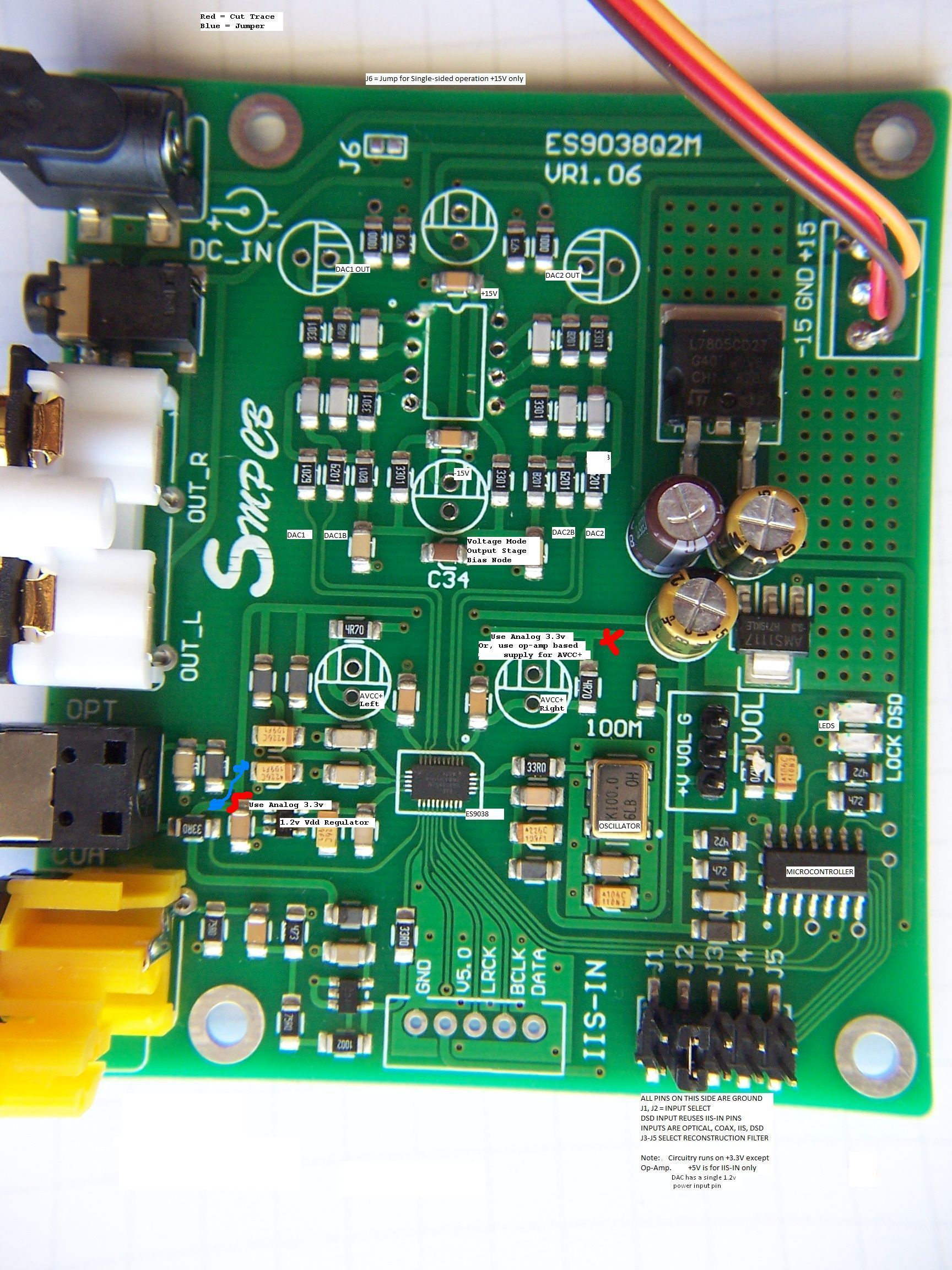

Does anyone know if there is a schematic for the listed 9038q2m?
Never saw a complete schematic for it, but its never been a problem. We could probably draw one up if anyone was motivated enough.
Basically, the PCB is double sided so its easy to trace out the interconnections. I've probably traced out every part of it at one time or another, but usually we only care about one small area at a time.
One thing we do have is a marked up pic of the board with annotations describing items of possible interest. It is attached below. To see it at full resolution so the text can be read, first click on the image to open it, then while it is open mouse down to the lower left corner and click on the white X symbol. That opens the pic at full resolution. You can also right clock and select to download any image.
Thanks Mark, I have one on its way and wondered if a schematic may have been created at some point. it wont be a problem to trace this out myself.
ta
No problem.
