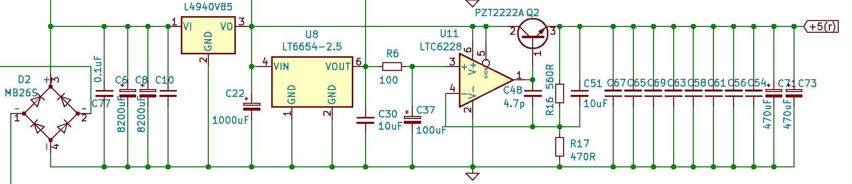

OK, in order to stop all that BS above I would propose to discuss for instance something more relevant. For instance recently ppy (the developer of DSC line of DACs) published elsewhere something pretty interesting IMHO, what could be a great solution for HF load transients, like AVCC. I ordered some LTC6228, let see how it works, but judging from the simulation this opamp allows to get much better response than for instance LT3042.
And Evenharmonics is warmly welcome to express his judgement on this matter, of course!
...what could be a great solution for HF load transients, like AVCC.
Not that optimistic about the prospects myself.
First, if we are talking about literal AVCC, that implies ESS which IMO amounts to beating beating a dead horse.
OTOH, if we are talking about AK4499 Reference Voltage, the eval board uses a passive RC LP filter after the Jung-style regulator. Higher frequency voltage regulator response would not seem to be the goal, just the opposite maybe. Maybe better to increase power supply impedance above audio frequencies, then maybe less RF/HF junk coming out of the dac and into the I/V to then have to be filtered out in further output stage processing. Lot of maybes, I know. Will have to get back to that later. For the moment working on some other things I am trying to get done first.
