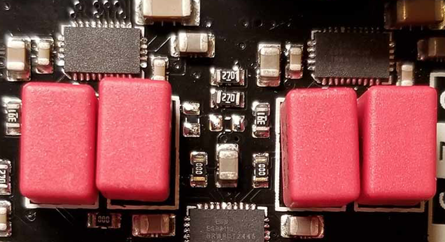

To improve your DAC's sound, I suggest replacing the x2 470pF Wima caps above each DAC (so x4 caps in total) with 1000uF 4V or 6.3V Organic / OsCon type Caps... The Negative terminal of the Cap to Ground (Probe the Ground terminal position with a Multimeter). This opens up the sound stage + deeper Bass etc....
Thanks a lot John! this is really helpful and very much in line with findings done earlier in this thread. I was hesitating to go for deep S2 digital mods because of so nice enclosure and colour display
Just to make sure, are you referring to the caps in the pic attached? Are those for ES9311 voltage reference?
AVCC?
Yep, those are the caps.

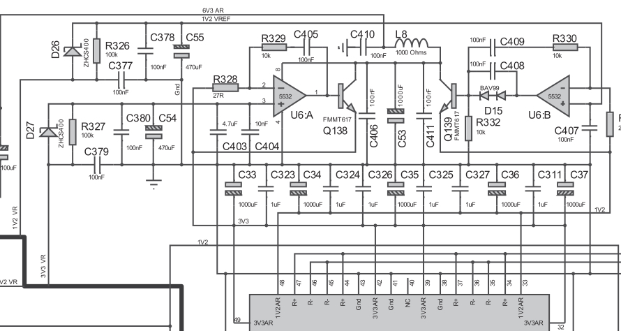

There are two trains of thought:-
1. The PSU impedance seen by the DAC array across the audio B/W is determined by active circuitry (A regulator with feedback). So the impedance (at any particular frequency point) is determined by the Closed loop gain of the regulator (assuming the feedback is correctly sensing the point of load). Once the regulators Gain has dropped to zero, then the idea is for a capacitor to "cleanly" take over....
So the general idea is to have fixed and constant impedance determined by active circuitry across the audio B/W, followed by RF decoupling / filtering determined by capacitors higher up, outside the audio B/W (no regulator can be fast enough at HF / RF frequency).
This is the approach taken with the S2 design - the premise is that the audio quality is not effected by the sound of the PSU decoupling capacitors... (Note I said "premise" - not reality IMHO)...
The second option is to just "slug" the output of the regulator with mass bulk caps. so these bulk caps dominate the regulators output impedance / loop response (or lack off) across most of the Audio B/W... If the total amount of bulk Capacitance is made so large then the regulator cannot oscillate as its unable to "Move" its output fast enough in face of the low impedance presented by these Bulk caps... its output is "Slugged"... Crude, but in realty the most common method of regulator loop control.
The trouble with this method is that the capacitor is very much in the signal path and secondly, the regulator loop dynamics are effected by the Bulk capacitors value & ESR which is highly temperature dependent (operating on a "chemical" process) - hence the warm up period noticed / required by HiFi equipment...
Its now a designers choice between the sound quality of Active circuitry (Option 1) verses passive circuity (Option 2) - Passive is normally the best option, but the quality of bulk capacitors is so far from perfect and thus really has a Huge impact on SQ...
I'm leaning towards option 2, although the warm up requirement is very noticeable (and the trouble of never finding the perfect "Balanced" sounding capacitor) + it smacks of a crude design... but Hey Ho... this is Audio...!
The capacitor location indicated are the OUTPUT of the AVDD regulator - decoupling the CRITICAL ESS DAC Array...
Swapping the 470pF Film caps (Option 1 operation) to larger 1000uF Bulk caps (Option 2 operation)....

I rarely use IC regulators in the audio path thesedays... being impossible to optimise the loop response...
I use a HP 3577A (with LCD upgrade), these are perfect for loop response analyses good to be able to confirm simulation results!
Its surprising how bad MOST LDO's wrt PSU rejection are, not to mention output impedance etc. - they typically have very poor loop gain...
Worst case I use a 5534 as "gain block", followed by some form of OPS.. 5534 are cheap as chips (no pun intended ) and very hard to beat for low noise and "gain" / PSRR...
Where space allows I just go fully discrete - its cheaper and you can optimise the loop gain etc...
Youare correct about the space issue - the ES9311 was developed for mobile phones etc where a bulk cap to decouple the array ids impossible - even if active regulation does not work as well in this application (the ESS DAC array has demanding LF and RF PSU requirements)...

Well the LF impedance "corner" is determined by the capacitance value the regulator will take over output impedance at lower frequency.
Yes, shunt regulators never fail to impress in such applications shame about there "Class A" power dissipation which limits there use in our "Green world"!
As designers, we are now being hounded for low operating currents by the EU etc...
a while ago I was trying to build a reg similar to the one below. I guess it should be pretty familiar to you. nevertheless it was prone to oscillations unless putting some 1-2 ohm resistor between output transistor and a couple of 1000uF low ESR caps. perhaps too little capacitance then?
Yes the circuit needs to be optimized to account for the parasites include the ESR of the Caps. used etc. optimization with R392 / C405.. The values reflected on the schematic might not be production PCB values as I tend to scramble circuits to confuse those who copy designs
