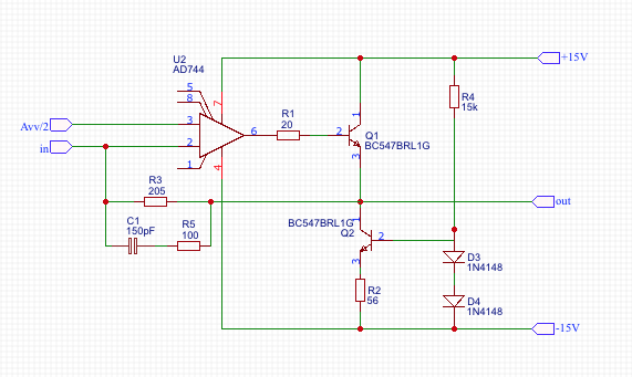

Has anyone bluilt a dscrete iv stage?
Based on current mirror?
Or is it a stupid idea?
Yes, have made a few.
It depends on the DAC output impedance. If you have a DAC that is true CCS
output (very high impedance), the circuit can work very well.
If the DAC has low OP impedance / high current swing, you will end up with too much distortion.
I have spent considerable time on LTspice playing with various open loop, I-V
converters for Sabre DAC. I came to the conclusion that unless you run
absolutely huge quiescent currents, they all just make too much distortion.
TCD

what Is your opinion regarding different output stage to ES9038 like [Resolved] PCM1794A: Mono differential output - Audio forum - Audio - TI E2E support forums or IVY III The IVY Balanced Line Stage Instead of last recommended ES9038Q2M Board
that way there Is no bother with Inserting Vref

The PCM1794 circuit will give more distortion since the I/V output will always be below ground, which gives a common mode offset for the differential summing stage. Ideally, Vref should be adjusted as I described to produce zero common mode offset at the I/V outputs.
The Ivy circuit isn't the best sounding. There are good reasons TP went on to design yet another try at an output stage after Ivy. Not ideal that time either, they don't listen carefully enough, IMHO only, of course.
My recommendations for output stages haven't changed yet.
I built an class a amp and now i like very much is sound so if it can work in class a mode would be the best...
The purpose of class A is to get good sound quality, is it not?
You won't get good sound quality with this dac chip using a class A output stage. The dac chip is not designed to work that way.
Also, I keep trying to tell people there is some low level RF that comes out of the dac chip. It is likely to come out of the output stage differential mode, common mode, or both modes at once. The RF can easily affect sound quality of any amplifier that follows the dac output stage circuit. It can also affect the output stage itself. Still recommended to use the standard 3-opamp output stage and to attend to all the little issues we already know about that can adversely affect sound quality. Then you will have the best results.
With q2m i built the 3 opa ív stage (by freezebox 1294). It sounds ok. Just simple fall in love with the class a voice and this is why concidered if possible to apply it here too.
Thanks i will re thinm
If the 3-opamp output stage with OPA1612 only sounds okay, then it means there are other things wrong with the dac: AVCC power supply, clock jitter, separate VCCA/Clock/DVCC voltage regulators, ground plane, output stage mounting, DPLL not set to minimum stable value, etc. Look to one or more of those things that still hasn't been done. The problem will not be fixed by a Class A output stage since the output stage is not what is causing the problem.

Hi Terry,
Have you tested Pass I/V too?
D1 IV Mosfet
Also an intersting article from Nelson:
http://www.firstwatt.com/pdf/art_zen_iv.pdf
What have you tested?
Thanks,
Sz.
thank you Mark
some thoughts about differential I/V one can find inhttps://www.diyaudio.com/forums/digital-line-level/340331-questions-es90xx-output-stages.html
for PRO chips OPA1632 with an output buffer works pretty well.

OK, so if it has mirrors and has feedback then we are talking about a CFB,
discrete opamp, I think...
We also tried this approach years ago. It did sound good but there are two issues:
a/ The DAC we used it with had fairly moderate OP impedance and not so high current swing
b/ Assuming it's a current FB opamp, you cant wrap a pole of the LPF around it without extra compensation methods. Usually (and the way I solved it) was
adding a resistor from feedback 'node' in series with -IP to lower BW and allow stable operation. This also increases distortion. The CFB topology
already has limited open loop gain by nature of it's design so it will end up being pretty high distortion when used for Sabre, especially the Pro version.
There are some discrete voltage opamps that I believe would be as good or better than the usual OPA1611/2 but they are quite complex and very
expensive. They both use two pole compensation, a 'jensen enhanced' input stage and as usual, high current OP stage. All things that normal monolythic
opamps don't (can't) have.
To brew one yourself would be a massive job and you would need access to a
really good distortion analyzer to track performance.
We sound like we are trying to discourage you... that's not in the spirit of DIY!
TCD
on the other hand the same OPA1612 will sound different depending on their power supply z(f) dependance. here those big film caps Mark recommends matter, or a good shunt reg then. btw I tried some discrete in I/V, but found 50mA quiscent not very practical and the THD still worse than OPA1612.
if the output stage is too weak for an opamp choosen then some buffering like bellow may do the trick
Or you can use something like BUF634 in wide BW mode. It is complementary,
runs quite a bit of quiescent and can do 250mA.
