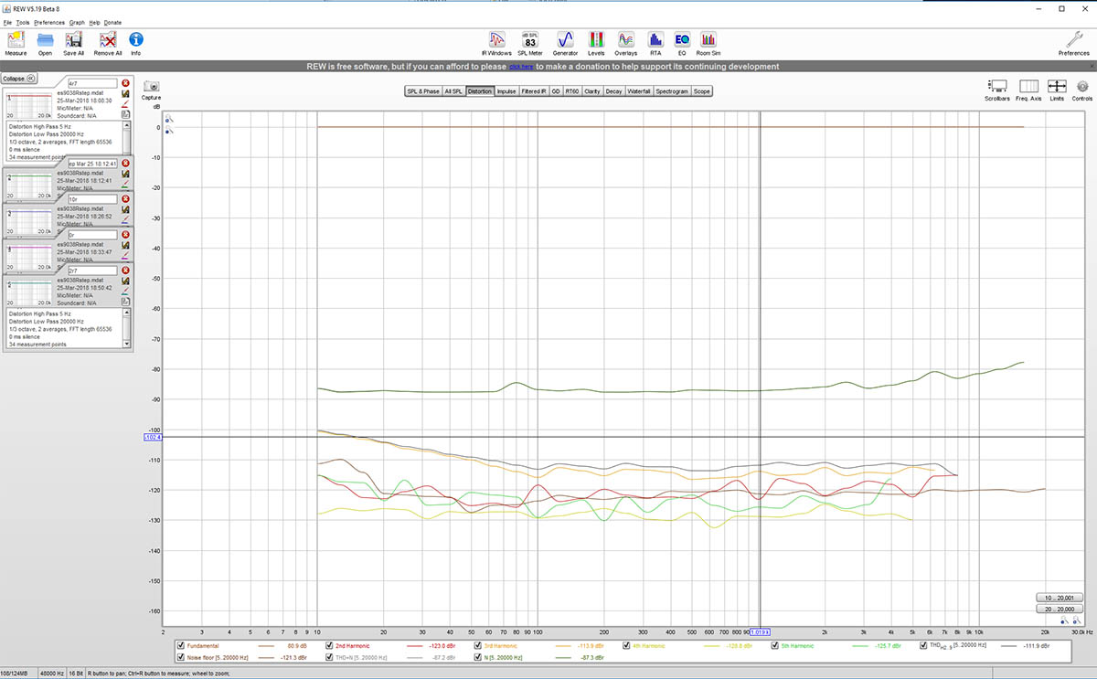

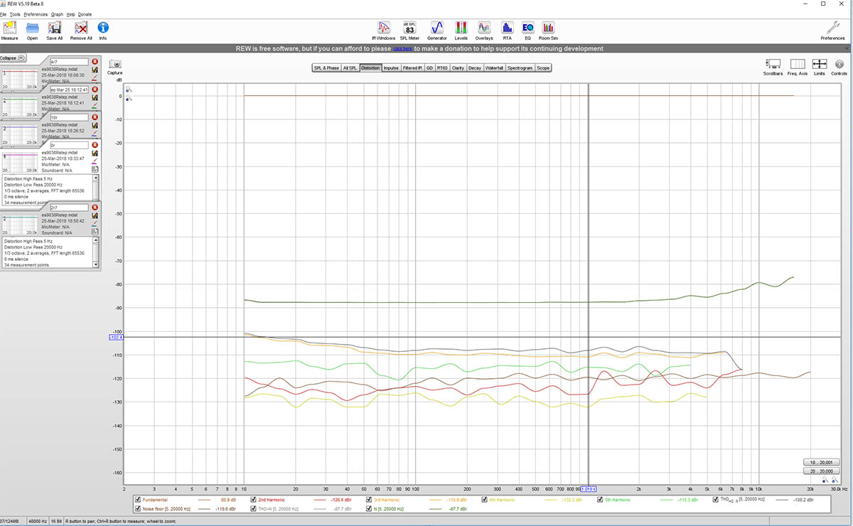

You need i2c to control the thd compensation. Basically you need to measure the H2 / H3 and change settings in a register while monitoring for improvements .
Attached is what I got today as far as harmonics. In the next days we will see how to improve further . View attachment harmonics.pdf
1Khz 0dbfs

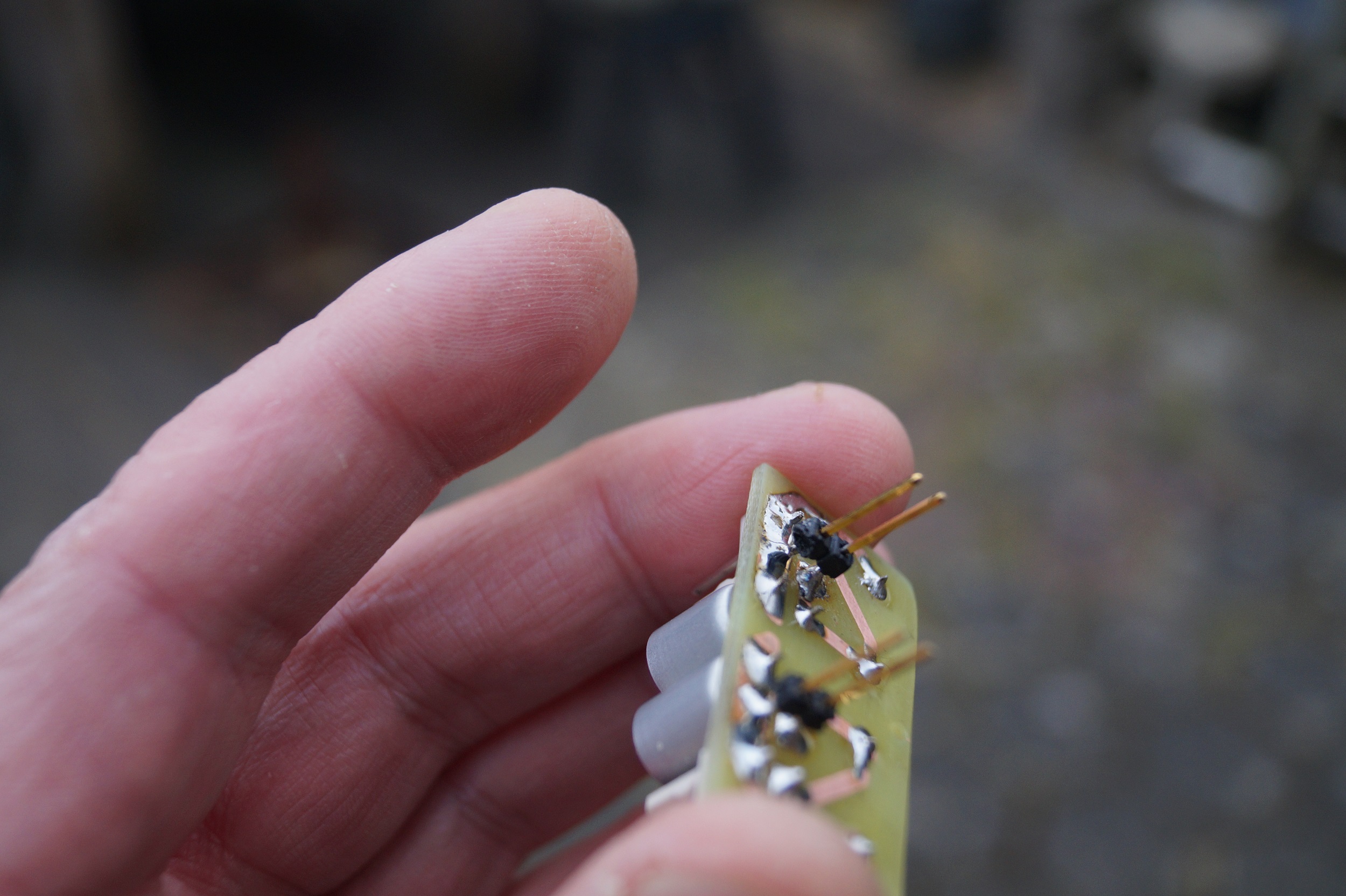

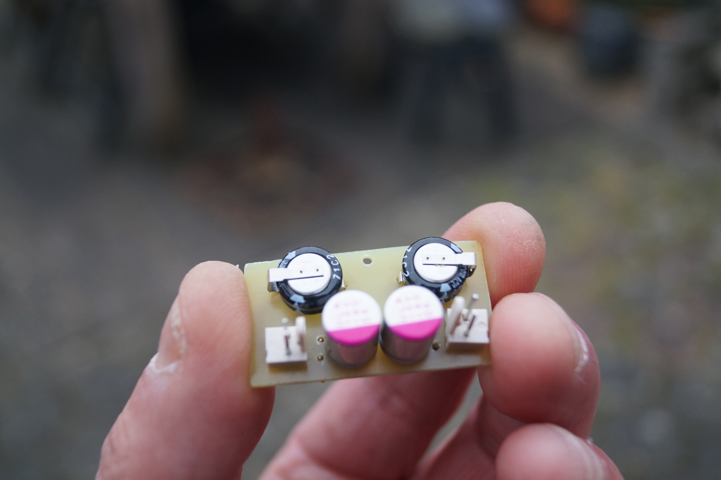

From what I remember the analog stages are about 2ma.Digital is less When you said you were using botton type supercaps , did you also decouple them with film capacitors ? At last , how was the connection to AVCC made... power and ground connection have to be made with traces...no vias

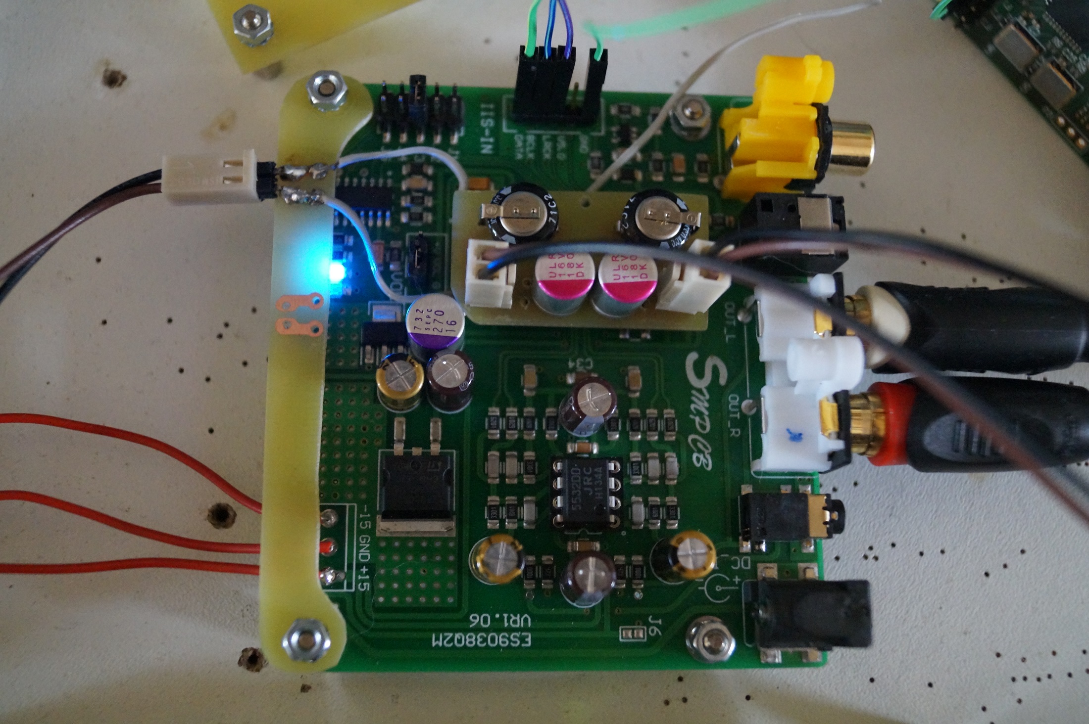

Look wat i dit.
I put in 3 Salas 3,3v shunt,s.
But the biggest improvement came from giving the dac a lot of uF on the
AVCC supply,s.
It went from harsh narrow soundstage to big roomfilling with the biggest base
that wil blow you away.
I am not even thinking about putting in an other opamp,great sound!

Looks great , 2 Supercaps with 2 electrolytic to decouple .
