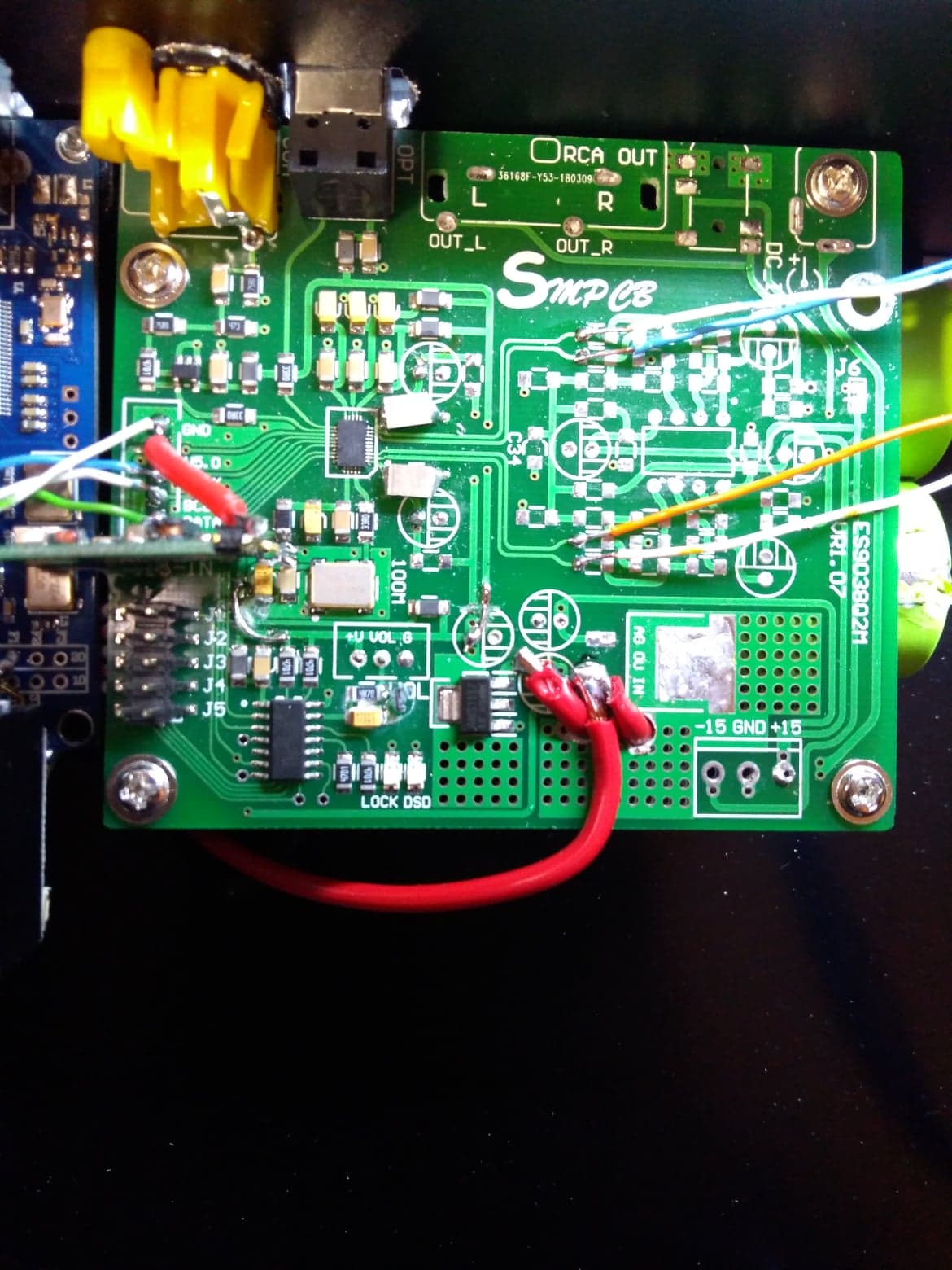

Hi! Just fired up my highly modded 1.07 board and I cant get it to work. Only the display fires up.. I have a few questions regarding the operation of the board.
1. Are the input jumpers necessary when using the rotary switch?
2. Is the optical plugn'n play ?
3. Can I use the original inputs together with the IIS from a Amanero board?
4. Does the Amanero board board work with this 1.07 card straight away?
I also attached a picture of my board. The AVCC gets power from underneath the board(LiFe 3.3V) through the stock electrolytic cap pin holes. If anyone finds any mistakes on the board please let me know. All the new regulators measures 3.3V. Is there any way to find out if the dac chip is fried? Thanks for any help!
Shouldn't be needed, except J1 and J2 installed at the same time may lock up the controller so don't do that unless you mean to.
Don't know myself about that if the display is hooked up. If the display is disconnected then IIRC J1 selects optical input.
Yes. Amanero or other I2S source can be connected while SPDIF and or TOSLINK is connected. Jumpers J1 and J1 select which input will be used if the display is disconnected.
Depends where you bought the Amanero board from. Twisted Pear flashes the firmware for use with external clocks. If you buy directly from Amanero then the firmware uses the clocks on the Amanero board.
If it is a Chinese Amanero clone it uses its own clocks, but can't be flashed with new Amanero firmware or it will become bricked.
Picture is a little blurry. Hard to say much about it.
[/QUOTE]
An oscilloscope would help greatly with determining that. Otherwise, no real way to tell if the dac clock is working, or what input signals may be present.
Make sure you have an output stage powered up.
You might try removing the display and disconnecting any volume pot, just to keep things simple. Then use J1, J2 to select I2S or another input. Before starting playback you should see Vref DC voltage on all the dac outputs and I/V output pins. When you start playback some AC voltage should start to appear on I/V output pins (which would be the audio).
Thanks for for the help Mark!
I now managed to get it to work! 🙂 It was a combination of my optical on my pc not playing along and a cut trace to the inputs. It worked right away on dvd player I first tried before finding the cut trace. It turns out the optical is plug'n play, havent tried the other inputs yet. So theoretically my chinese Amanero board should work native? Is there any leds on the Amanero btw? Do know of any good treads on the Amanero board?
Chinese Amanero boards should work fine for PCM audio. If using Windows OS, then appropriate precautions should be taken to minimize added distortion caused by Windows Sound Engine. Please let me know if you need info on that topic.
