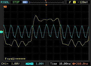

Recently, I replaced some of the LVDS clock cables to and from the clock divider board for modded dac#2. This time best sound quality is with the 12.5MHz DSD clock timing from AK4137 perfectly aligned (as well as my 100MHz scope can show) with the dac 100MHz MCLK (measured at a dac GPIO pin). In this case, perfectly aligned means the same relative clock timing as the dac chip would produce if it were generating the I2S/DSD clocks in master I2S mode. That is a little different from what I found produced best SQ with the previous cables, although it could be there was some jitter or something that caused it to sound best with a little bit different timing. The sensitivity to timing is similar to the effects of other things we try to get right such as distortion compensation, power supply quality, etc. In other words, it is audible and subjectively similar in character to some combination of low level jitter and low level distortion. Adjusted to where it sounds best makes SQ more pleasant, and the adjustment is fairly sensitive. Perhaps 150ps or less change in relative clock timing can produce very small audible changes. 300ps - 450ps change produces more easily heard effects. For me, I don't think I would want it to be off by more than 150ps from whatever produces best subjective SQ. That might amount to something like the difference in timing caused by a 1" change in the length of a piece of coax cable (depending on the particular cable propagation delay, often somewhere around 2ns per foot).
Mark,
I don't know what's going on with you clock signals but they look very noisy, maybe lot's of PS noise or ground bounce.

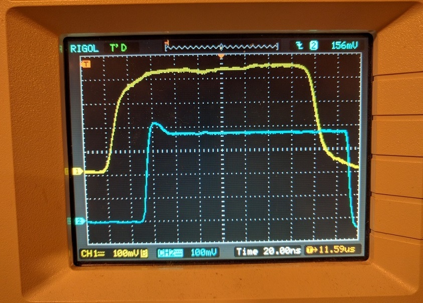

Ref below a pic of bitclock OP of one of my OCXO driven reclocker. The reclocker was implemented with Potato logic flip flop. The yellow signal is the input before reclocking.
The slight overshoot is most likely an impedance mismatch with Cro leads which I could control with OP resistor however I wanted to keep leading edge as fast as possible.
This is only 2.8MHz, however you can still see that it is very well controlled.

Hi Terry,
Yes, we agree you don't know what is going on with the clock signal scope shot I posted. We have already been through this once, IIRC, the last time I posted I picture of the same signals.
Have no idea why you have started talking about clock dividing when there is no divided clock shown at all in the pic I posted.
We probably can agree that taking a nice picture of 2.5MHz (and only one signal at a time) is often pretty easy.
To kind of repeat some of what I said last time, and in case there is unstated concern by others regarding the appearance of the signals in the picture I posted, the picture includes an LVCOMS AK4137 generated DSD clock signal originating on another PCB, traveling through pin headers and ribbon cable and arriving at another PCB where it is used. The other signal shown is an LVCMOS dac chip generated 100MHz clock signal that drives an LVDS converter chip and which was captured with a 100MHz scope. That signal is most likely attenuated and phase shifted due to scope bandwidth limitations, and certainly lacking accurate edge information, unless of course the scope tries to do digital tricks to compensate for those things it might, which seems pretty doubtful.
Regarding the waveform aberrations that can be seen in the picture, they are neither caused by random noise, nor asynchronous deterministic noise (signal averaging was used to minimize possible effects those things). Some of what you see is waveform distortion caused by the cheap probes (their fidelity was compared with a much better Tek probe of the same rated bandwidth, but only one Tek probe and I wanted to use matched probes for the pic). Some aberration is an effect of less than ideal probe grounding since I had to hold both probes in awkward positions down inside a deep shielded enclosure while operating the scope with my other hand. Remaining waveform distortion is largely attributable to impedance discontinuities along the paths where the signals run (including any distortion caused by probe capacitance).
The reason the signals travel around as they do is because the project is still a very early stage experiment. Very different from your case where you know in advance exactly what you want to do.
Also, I wanted to show what someone else modding a dac as I did and using a similar scope might expect to see.
The foregoing having been said, I can see the need for a better scope when working with 100MHz clock signals. Unfortunately, I have equipment budget constraints that limit what is realistically likely to be possible. Nonetheless, I am working on trying to get a somewhat better scope so I can at least take more accurate pictures of what may be slightly ugly looking signals. I wouldn't want signals like that in a finished product or if I thought they were hurting SQ to any significance extent, but for a lab monstrosity, the dac works quite well. Clearly sounds subjectively better and more listenable than a dac that Stereophile not very long ago rated A+ and that sold for around $3,500. And, yes, I recall you questioned the reliability of Stereophile ratings, something that Claude recently talked about at length (Thanks again, Claude!), so we both have the same info there.

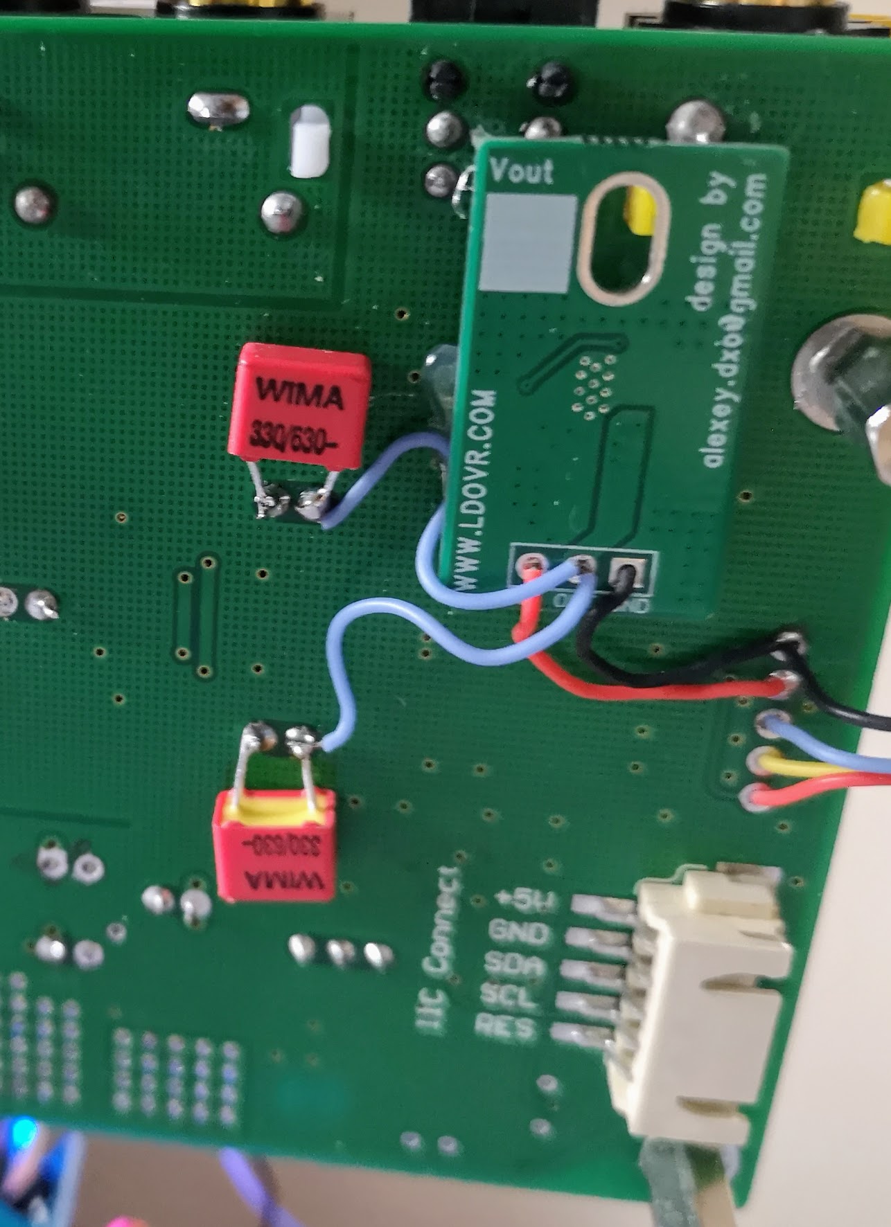

I've started to separate the power supplies for the DAC and the output. Using an existing LM317/337 for the +/- 15V for the output stage. I quickly built a simple regulated 7805 and 2x1117 board to provide a 5V and 2x3V, the 7805 has been replaced with a Dexa NewClass D. The Dexa is feeding the 1117s as well as the 5v for the board.
I've got a couple of Alexey's LT3045 low noise boards, one is currently supplying both AVCC, should I use the second to split this? Are the Dexa powered AMS1117s sufficient for the clock power or should I look at using a higher quality reg? I have some TPS7A4700s arriving at some point.
Thanks to all, especially Mark!

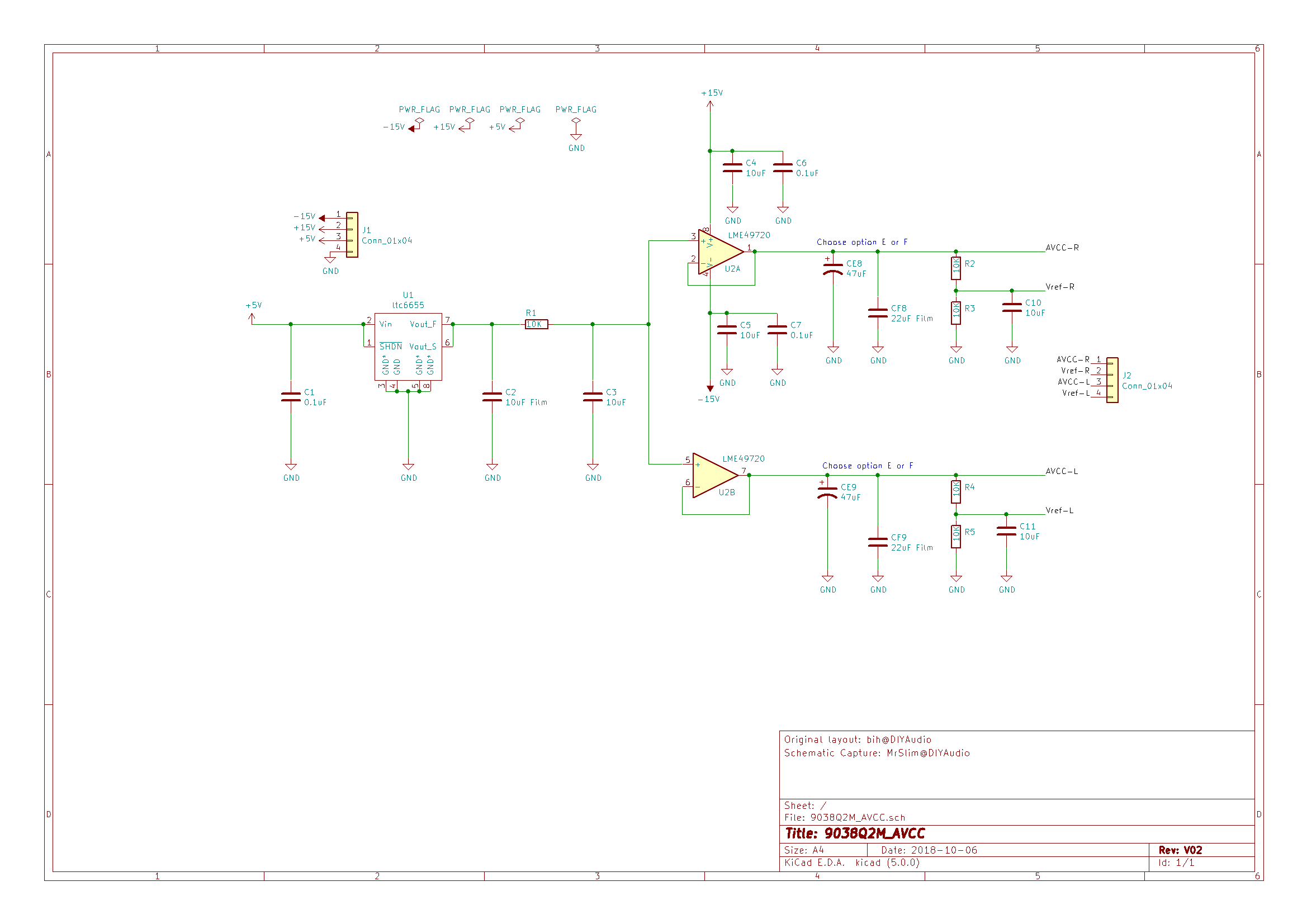

@daminagt3,
We specifically don't recommend using LDO regulators for AVCC (with a possible exception for ADM7150, in at least some implementations). Opamp regulators are better for that. However, you could use one LT3045 regulator as a clean 3.3v reference voltage source and then use a dual opamp as a buffer to provide a separate 3.3v supply for each AVCC channel.
EDIT: Keep any wires from opamp outputs and opamp grounds very short when connecting AVCC power to the dac chip.
In other words, if you look at the AVCC schematic attached below, you could use an LT3045 3.3v regulator instead of the LT6655 if you want. Just don't use that LT3045 for anything else, it needs to stay very clean.
Depending on the state of your +-15v power supplies, you may find LM49720 or OPA1612 dual opamps to sound better. With a really low impedance +-15v supply most people find OPA1612 to be superior for both AVCC and for the output stage.
Since you are using LM317/LM337 +-15v regulators, you will probably get some low level power supply ripple intruding into your +-15 power. Using two sets of LM317/LM337 regulators in series can fix that. Each set of regulators needs need probably a 3v or more of headroom since they are not LDO types. Depending on your +-15v transformer and how much voltage it puts out before the existing LM317/LM337 regulators drop it down, you may have some wiggle room to work with.
Also, if using LM317/LM337 +-15v regulators, it sure helps to add some film capacitors filter caps from +15v to ground and from -15v to ground. Some people have started trying Kemet DC link film caps for that because they are low cost. I use about 100uf of film caps for each of the +-15v rails, which can get expensive. Maybe someone can post a message to let us know if the DC Link caps are working out okay.

What's the Vref used for? Also what's the difference in option E/F or is that simply a electrolytic/film personal choice? I should be able to put something together, I have a spare LM4562NA that should be more than sufficient for this task.
Vref is there for if and when one gets around to building a proper 3-opamp output stage. The one-opamp output stage that comes with the dac board is there only because it is cheap. Unfortunately, it makes THD *much* worse than it should be. Recommended output stage instructions here: Dropbox - Output Stage Instructions.zip
Regarding the E/F opamp output caps, film caps were an experiment that worked okay, but not clear how much they really help. I think 47uf cheap electrolytics are probably fine for most users. The dac would need a lot of other improvements before film caps there matters much, if at all (I think).
Regarding 3.3v regulators, any regulators would be helpful to get the dac and clock loads separated out from each other and from the MCU regulator.
The clock and VCCA can be on the same regulator except maybe in the very best implementations. DVCC should be separate from VCCA and Clock. MCU can stay on the original regulator. Please see dac chip pinout diagram below. Note there are two VCCA pins, one on each side.
For best results with the DVCC, VCCA, & Clock loads, probably better to use a good LDO for each one of those if budget allows (3 regulators in total). LT3045 is used by some. I have used LT1763 mounted dead bug style under the bottom of the ground plane. Pics posted in thread, please let me know if any trouble finding what you are looking for.
At some point the clock should get an upgrade. We usually use 100MHz Crystek 575. Some people have reported satisfactory/good results with NDK NZ2520SD 80Mhz clocks (available from diyinhk for low cost). Either way, replacing clocks can be a bit tricky since there are four solder points for removal and again for replacement. A number of posts in this thread and some in another thread cover most of the details. Again, please ask if interested and any trouble finding things. Personally, I usually tend to do clock replacement very early in a project to get it out of the way.

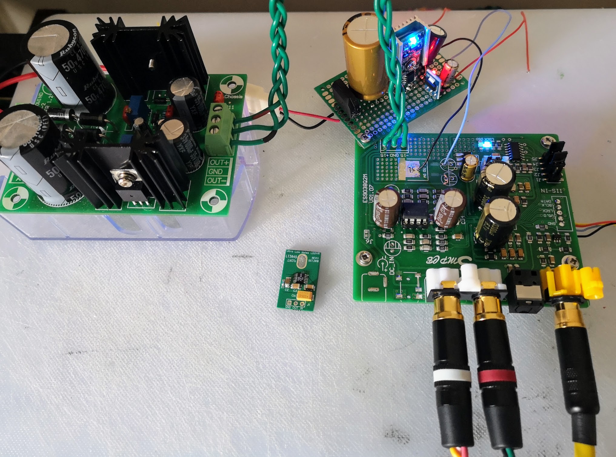

After modding all power supplies and voltage regulation, replacing clock, and building output stage, the next thing I usually try to get people interested in doing is tweaking dac chip registers. Once that is pretty well understood, one could move on to phase-locked AK4137 clocking.
The more I think about AK4137 and what I have learned from clock division experiments leads me to suspect that a much simpler divider and perhaps a yet to be determined reclocker could possibly be an easy solution. One thing we don't know when running the dac at 100MHz and AK4137 at 25MHz is exactly when the best time for DSD signals to be stable for input by the dac for best resulting sound quality. When MCLK edges occur, when the dac itself indicates it wants to see DSD signal edges, and what relative timing results in best SQ is still less than fully sorted out. Probably, another set of experiments is in order. However, not sure I want to do them with modded dac #2. Maybe I will play around with another dac to see if I can finish settling the matter in a way that would be easy and low cost for prospective modders to implement. However, right now there is no pressure on me to work fast, since pretty much everyone stops working on the dacs when the prospect of register tweaking looms next.

+/-15 filter capacitors

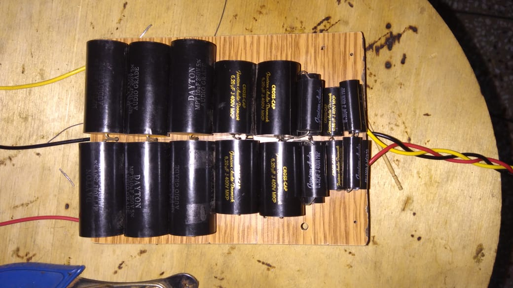

Hi Mark & others,
Finally finished assembling filtering caps for the main op amps power supply. The caps are from previous crossover builds detailed as below:
dayton audio grade(250v) 10uf 3+3
jantzen crosscap MKP(400v) 6.2uf 2+2
" 1.10 1+1
" .45 1+1
" .68 1+1
" .82 1+1
" .39 1+1
Total 91.68uf (45.84uf per line)
These filters and feeds the 4 1612 op amps, one avcc and 3 output stages from a 317/337 board.
My word! What a difference it makes. The sound has become so good that it matches or sometimes seem to surpass what comes to my headphones(using aune t1 mkII amp) for dsd, flacs and good quality youtube videos like vevo etc. Of course my rig and point of reference are modest. But considering that listening room has no room treatments, small, concrete, lots of outside noise and all kinds of wrong by acoustic standards, I find it hard to believe the sound I am hearing.
Thanks especially to Mark for his guidance and encouragement.
