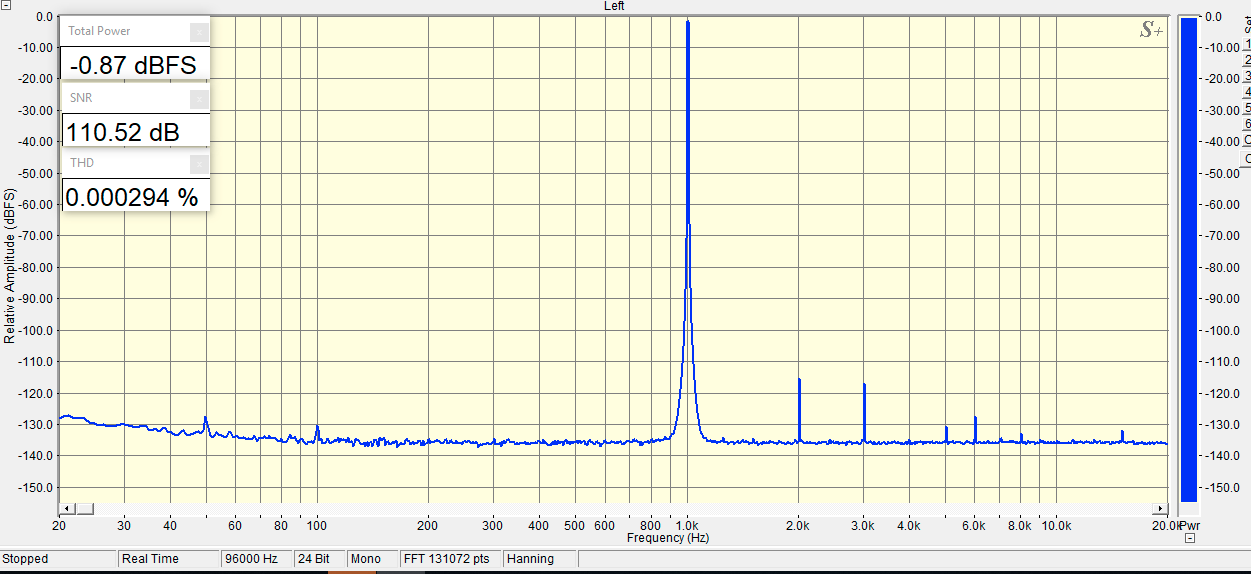

typically ESS: lows and "musicality" a bit tiny. mine measures basically like reviewed one: Review and Measurements of WesionTEK Khadas Tone Board DAC | Audio Science Review (ASR) Forum
parts used are "cellphone" targeted. good smd skills and microscope indispensable for modding.
anyway, the sound is really clean, and one would need to spend at least twice as much to get to this level with the board discussed.

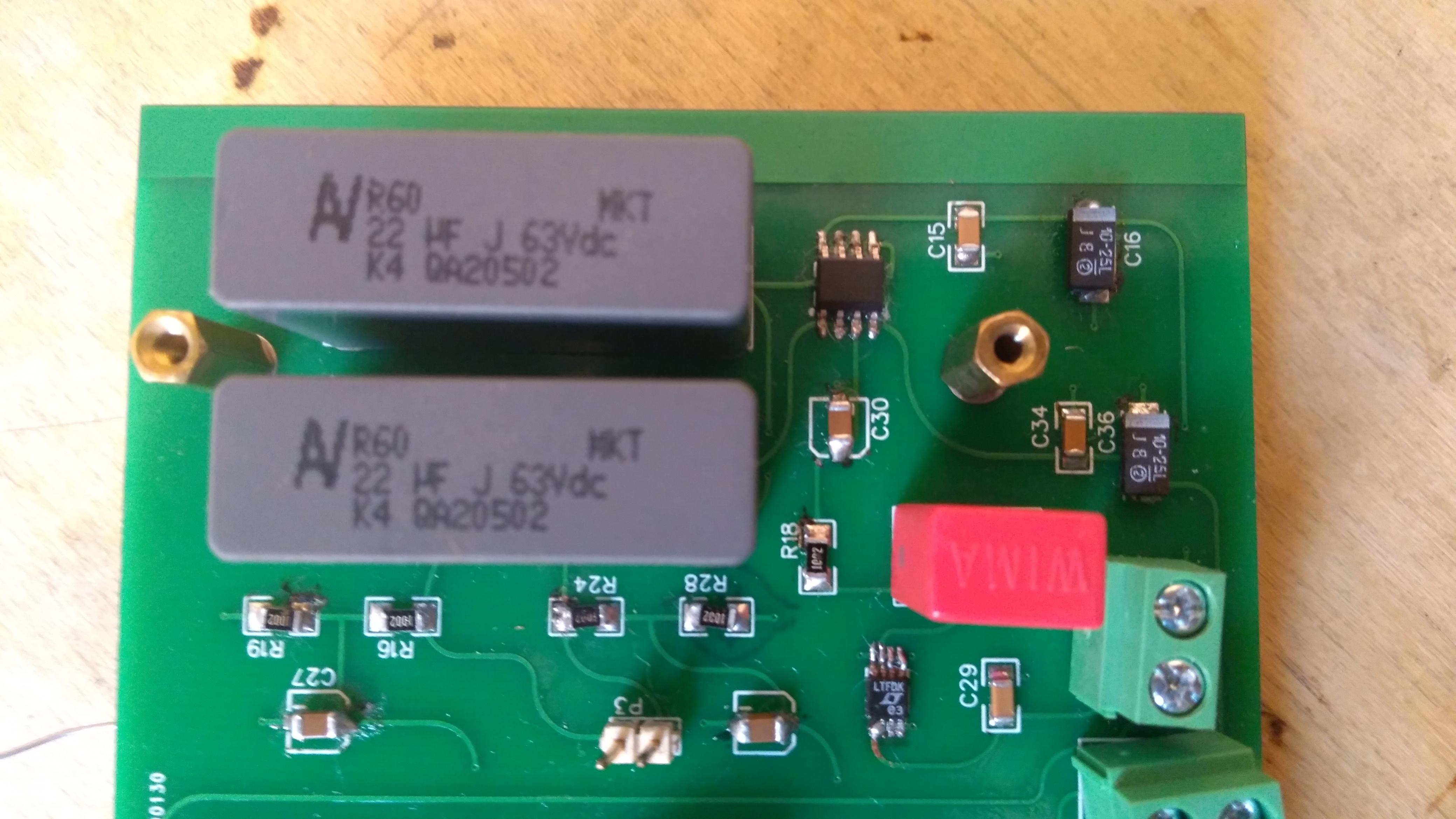

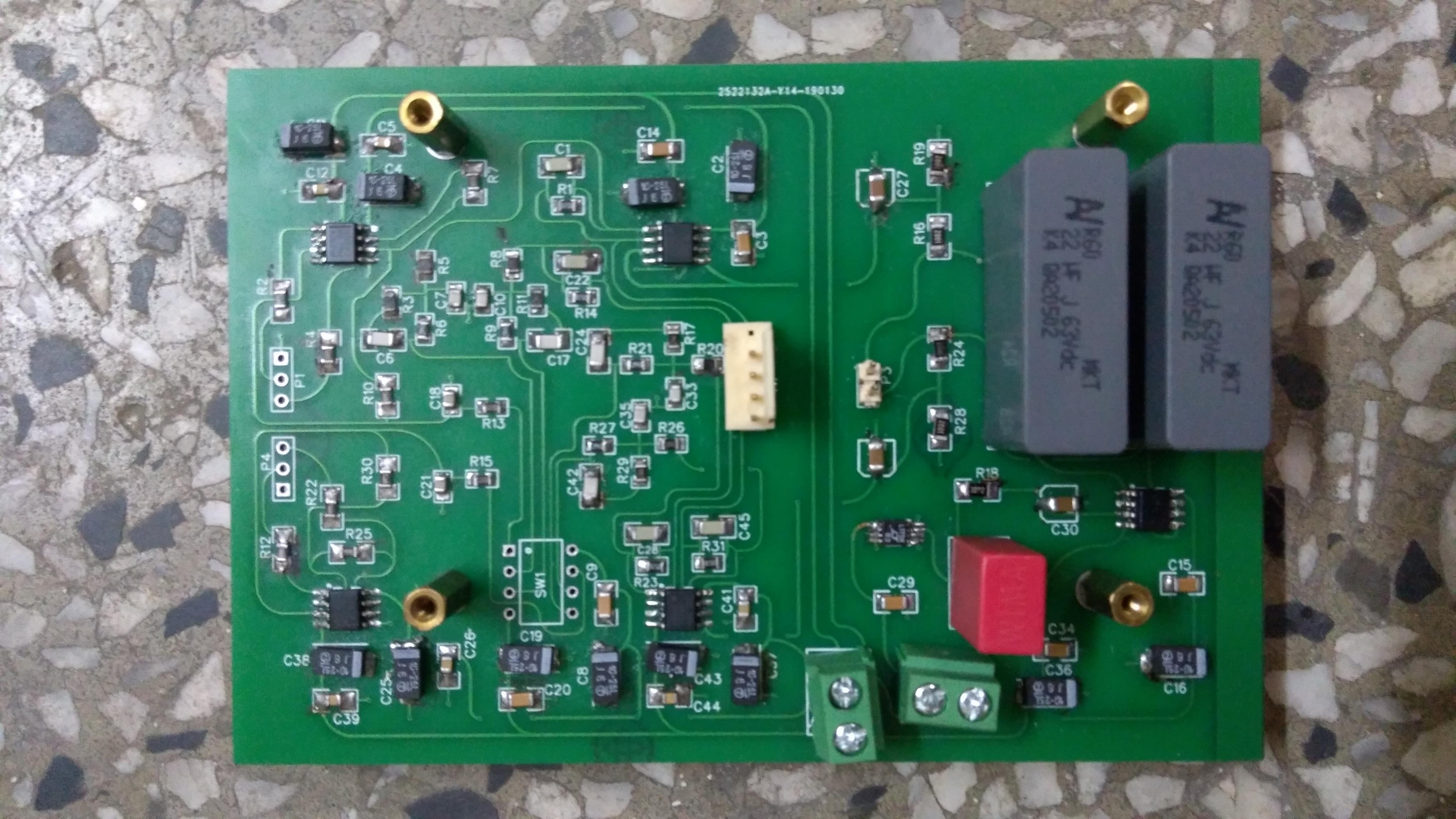

Hi Mark,
I did both avcc and output stage on the same board with differential output. Pics attached below.
Just finished so did not have the heart to attach them yet, so still don't know if it works. I followed the schematic you(and Mr. Slim) did for both OP and differential. As it is my first pcb design, many things I would have done differently if I design it now. For one I forgot to put ground line connections for avcc and output.
I still also have to modify the green board v1.07. My blue board and another green board was destroyed because of silly mistakes.

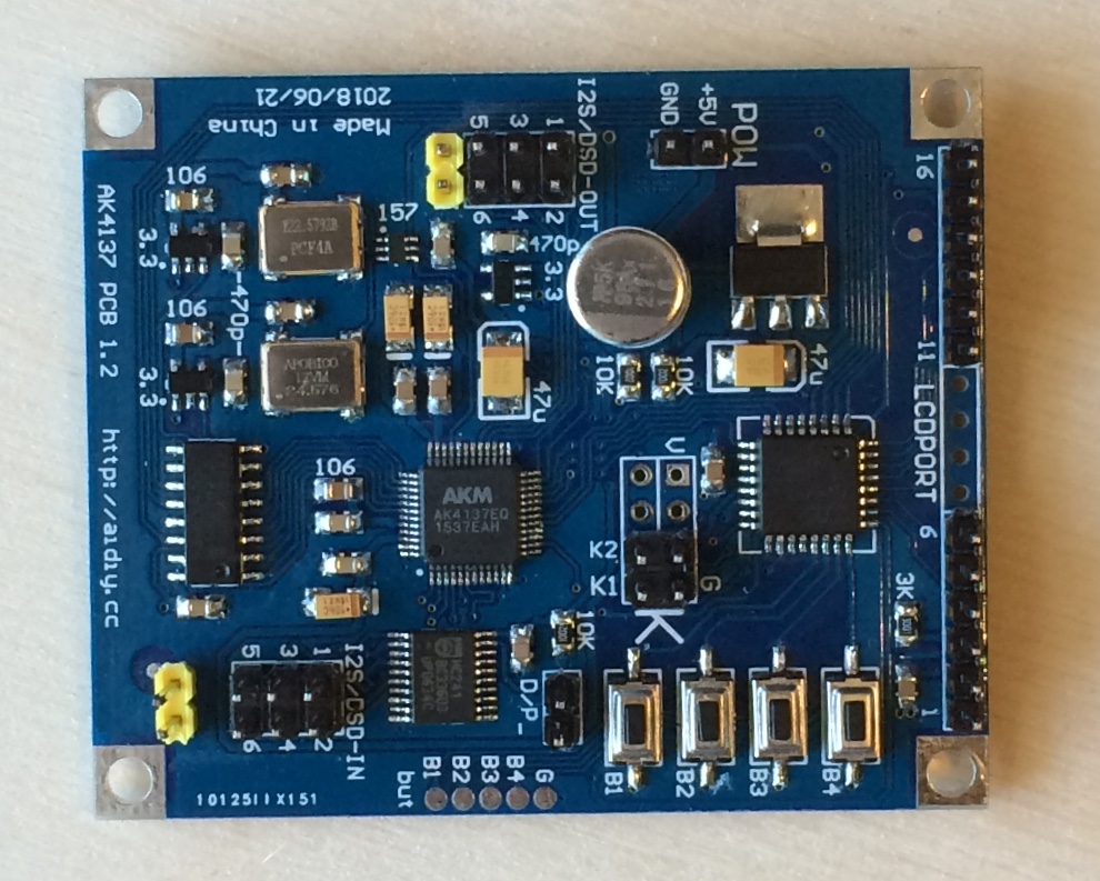

I tried connecting the both i2c and i2s to the board using rpi, but could not get it working as per eslei's instruction using volumio driver and plugin.
I am now using xmos board with my pc, with ak4137 upsampling board in-between. Still learning how to set up the up-sampler. Got it working in pcm mode with jumper connected on D/P. Would appreciate it if you could advise me on the settings you did.

Hi Mark,
Its the standard version of this one: AK4137 I2S/DSD Sample Rate Conversion Board Supports PCM/DSD Interchange Supports DOP Input for hifi amplificatore-in Amplifier from Consumer Electronics on Aliexpress.com | Alibaba Group
Kay
Kay

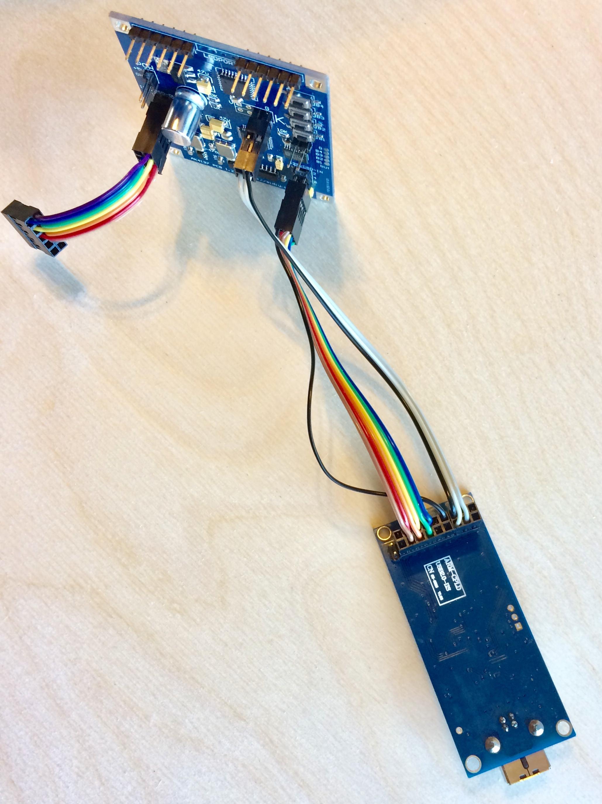

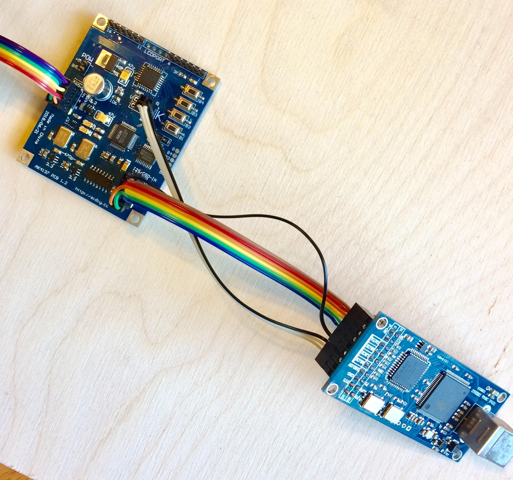

Actually, I posted picture before of how to wire it up. The AK4137 board should have some extra ground pins added (yellow color in the pictures) and the I2S output connector should be replaced with high quality gold flashed or gold plated pins, or ribbon cable wires should be soldered to the bottom of the pins on the ground plane side of the AK4137 board to minimize jitter. Any connectors at the ends of ribbon cables should have high quality gold connections. The D/P jumper should be removed to prevent damage to any boards, and the wiring to XMOS or Amanero board should be as shown below. At the dac end of the ribbon cable, either high quality gold pin headers should be used for I2S and DSD to help minimize jitter, or the ribbon cables should be soldered to the dac board. Try to keep the I2S cable between the AK4137 output and the dac board input as short as possible. A few CM is okay. (If you open the pictures then click on white X in the lower left hand corner they will blow up to full size so you can see the wiring better, or you can right click and choose to download the pics.)
