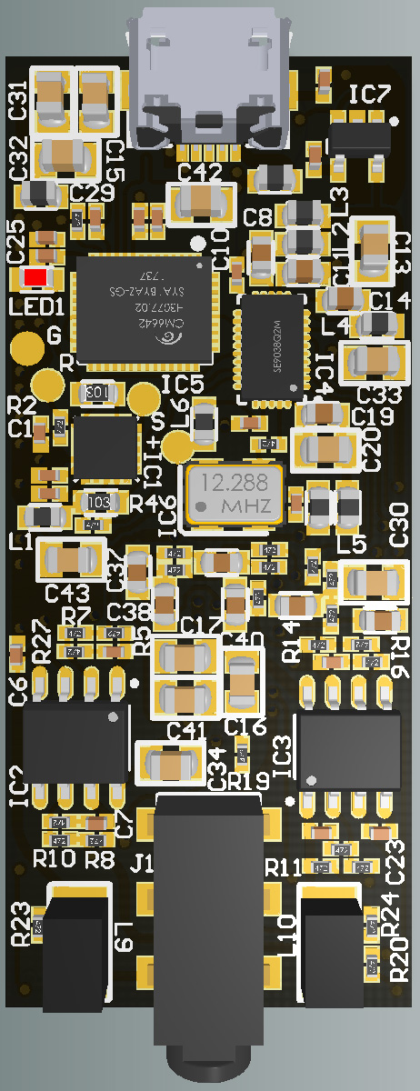

888777, it is not an upgrading project, I design dongle-like USB DAC+HPA for 4-wires headphones(only balanced output) from the scratch. As usual, a tiny sized device is full of compromises, in case of soundkey(which is just an example) it is too much compromised to me. My target is a tiny dongle with outstanding performances for that class devices: -120dbA S/N and THD+N .0005% at 1/2 max power or better. If I going to use simplified LPF, I can omit 2 opamp gates, and for 20x40mm PCB it's a big deal. Otherwise, I have to use these two opamp gates and surrounding parts, so my PCB could be 20x55mm, that's not so sexy as 20x40mm right? This is why I've interest regarding SE9038Q2M's out of band noise performance. Currently on my bench ak4490(simple 1st order LPF) USB DAC+HPA with 1.3MHz boost converter (4-5V in/5.5V out) and 5x1000uF Low-ESR solid-polymer caps + lots of X7Rs + beads, and I got S/N near to -121dbA, THD .0005%@-3db, however it is really bigger than typical USB flash dongle, and same sized as my PowerDAC YouTube

Well, It's not easy to keep these two options simultaneously on a tiny 47x20mm PCB, especially after adding 3ord LPF over there 😉
NZ2520SD 3.3V 20ppm 80.0000MHz (size 2.5mmx2mm)
was the best so far tested with ESS chips in asynchronous mode
