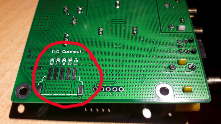

did you acheive to connect an i2c oled panel to the 9038q2m card?
no, unfortunately not by now..came it by chance as said, from this hungarian-based site->audiodiyers.hu • Tema megtekintese - ES9038Q2M panel a ringben
i oversaw it first..these connectors must be only on the "Green"-ones, V1.06 and up..i have the "Blue"-one..there is none of these connectors on the back..
but thx for asking; i will post here some info asap 🙂

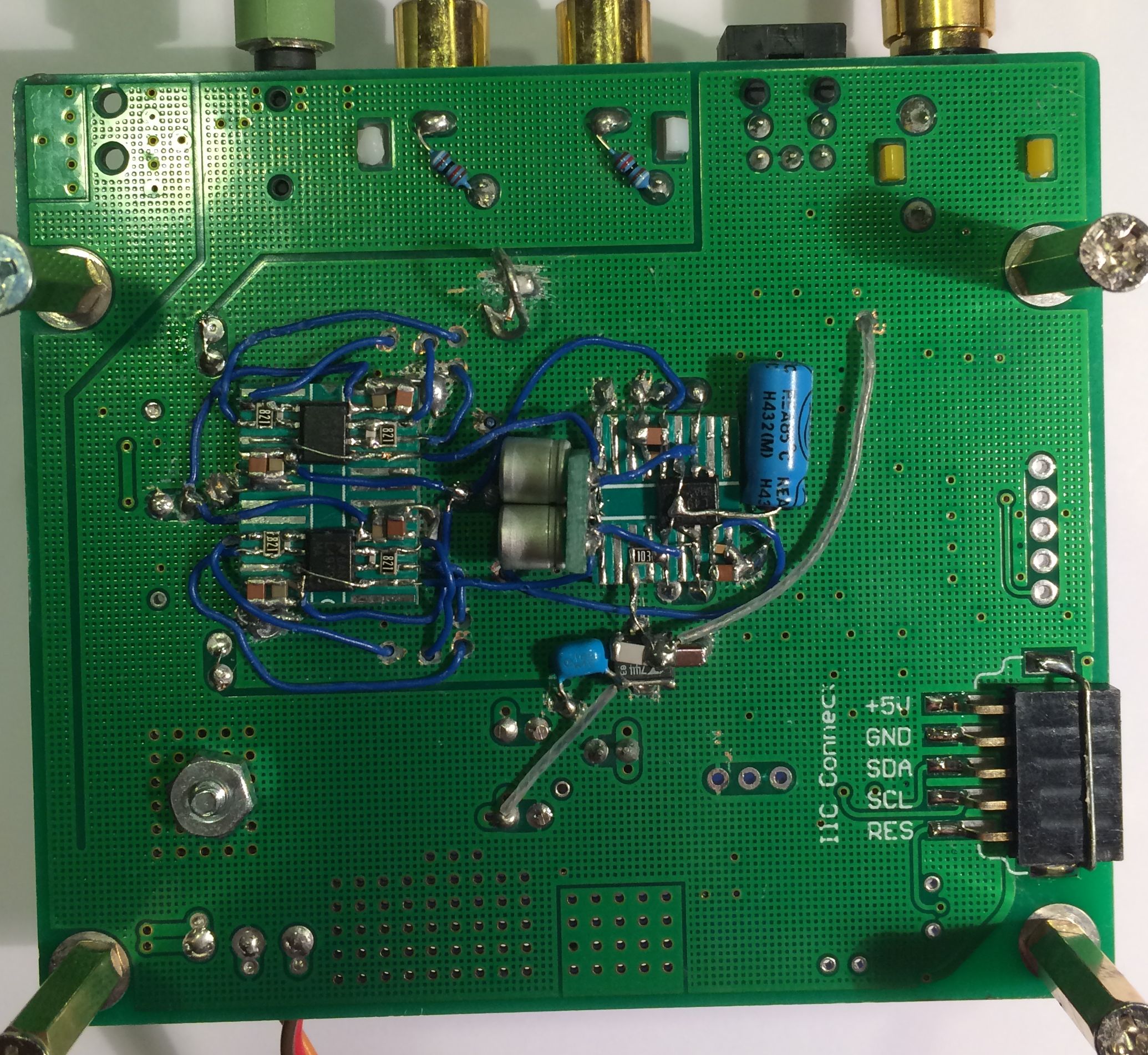

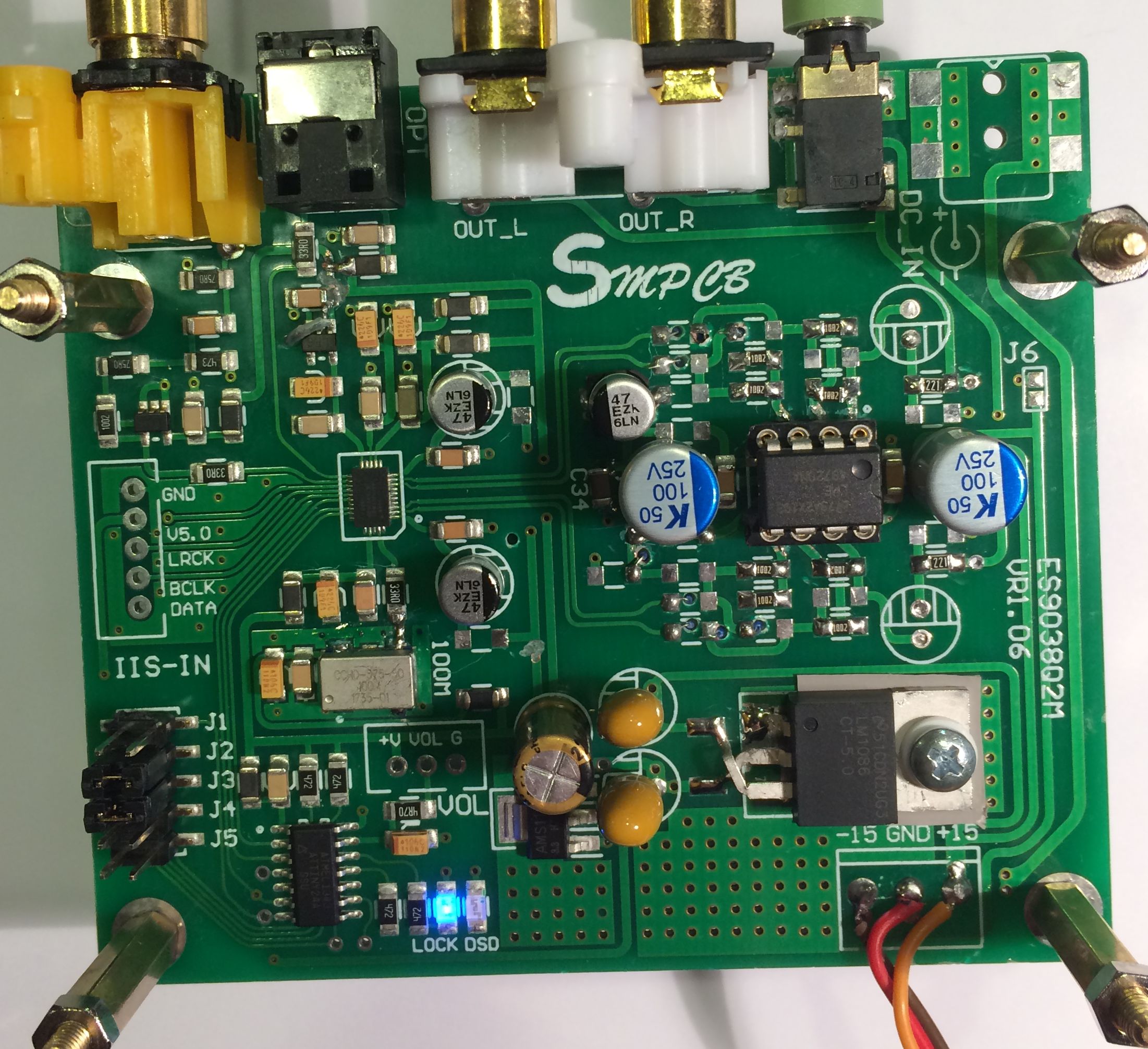

For some time I have wanted to see how far I upgrade one of the ebay Sabre DAC boards to sound as close to a Benchmark DAC-3 as possible. I'm getting pretty darn close, but I think there is a little more that can be done. More on that later, but for now a couple of photos attached below. As can be seen, output stages are fully balanced IV, power supplies are considerably cleaned up, and a low phase noise oscillator has been fitted.
Why nobody replace,split redesign, that very poor supply for dac. It will be step further.
I have split the supplies into digital/oscillator and analog for my board. The analog supply 3.3v regulator is mounted on the bottom of the board. It feeds the AVCC+ supply amplifiers and the 1.2 volt stepdown regulator for the DAC chip analog Vdd supply. Don't know why more people aren't choosing to do something like that.
Also, the +5 volt regulator that feeds the 3.3 volt regulators has been upgraded to an LM1086-5.0.
Mark you did quite a lot... but still room for improvement.
I would*t press whole dac on that board...if you will measure gnd you will see that is very dirty... i will move analogue stage on another board, supply it independently maybe gnd filtered...maybe also cut some gnd that digital gnd not completely polute the analog dac gnd and power lines...
But if it is worth ...i can*t say.
