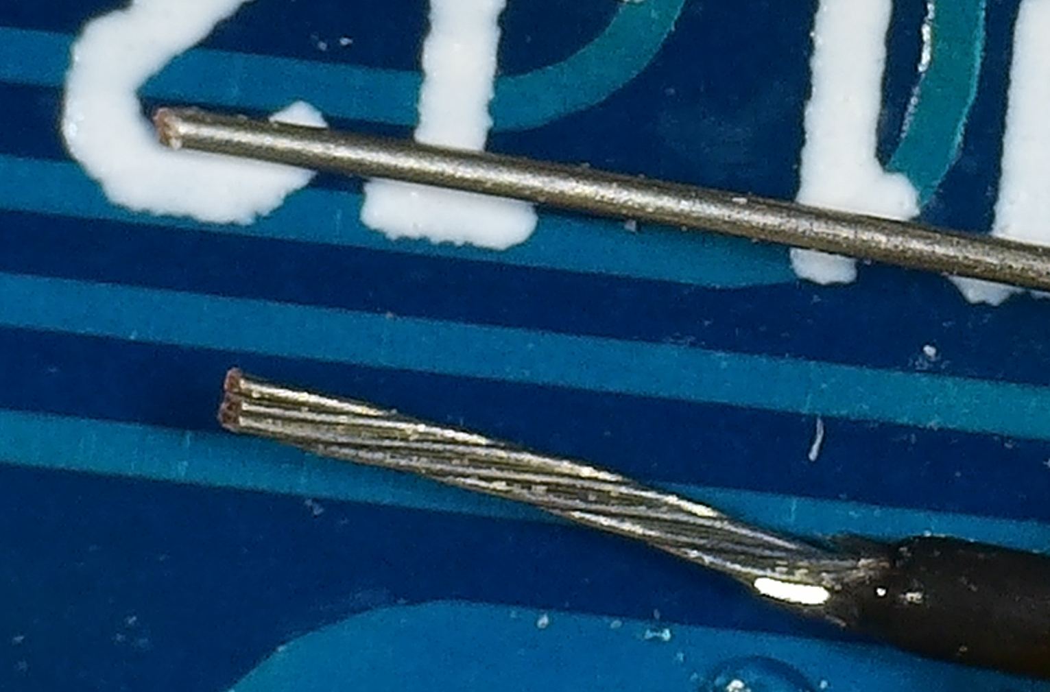

I think we should be able to do meet those requirements. We can cut traces between the dac chip and the MCU and attach wires there. 30-gauge wire wrap wire would be doable, as would any smaller wire. The traces look pretty close together, but if we ruin a short section we can always trim it back a bit more and try again.
How do we keep from getting solder bridges to adjacent wires? So long as we leave the solder mask on them solder won't stick. If we accidentally scratch off some solder mask, we can cover traces we don't want to solder with thin high temperature Mylar tape so solder won't stick.
Easy to do, but the wires will be a little delicate and could get damaged later. What about that? Probably if we strain relief the area where the wires attach to the traces there won't be any damage to traces from accidentally snagged wires or something of that nature.

For some more ideas about tapping into the I2C traces rather than pin lifting, some pics below show the ends of a 30 gauge wire wrap wire and 32 gauge stranded wire next to the traces.

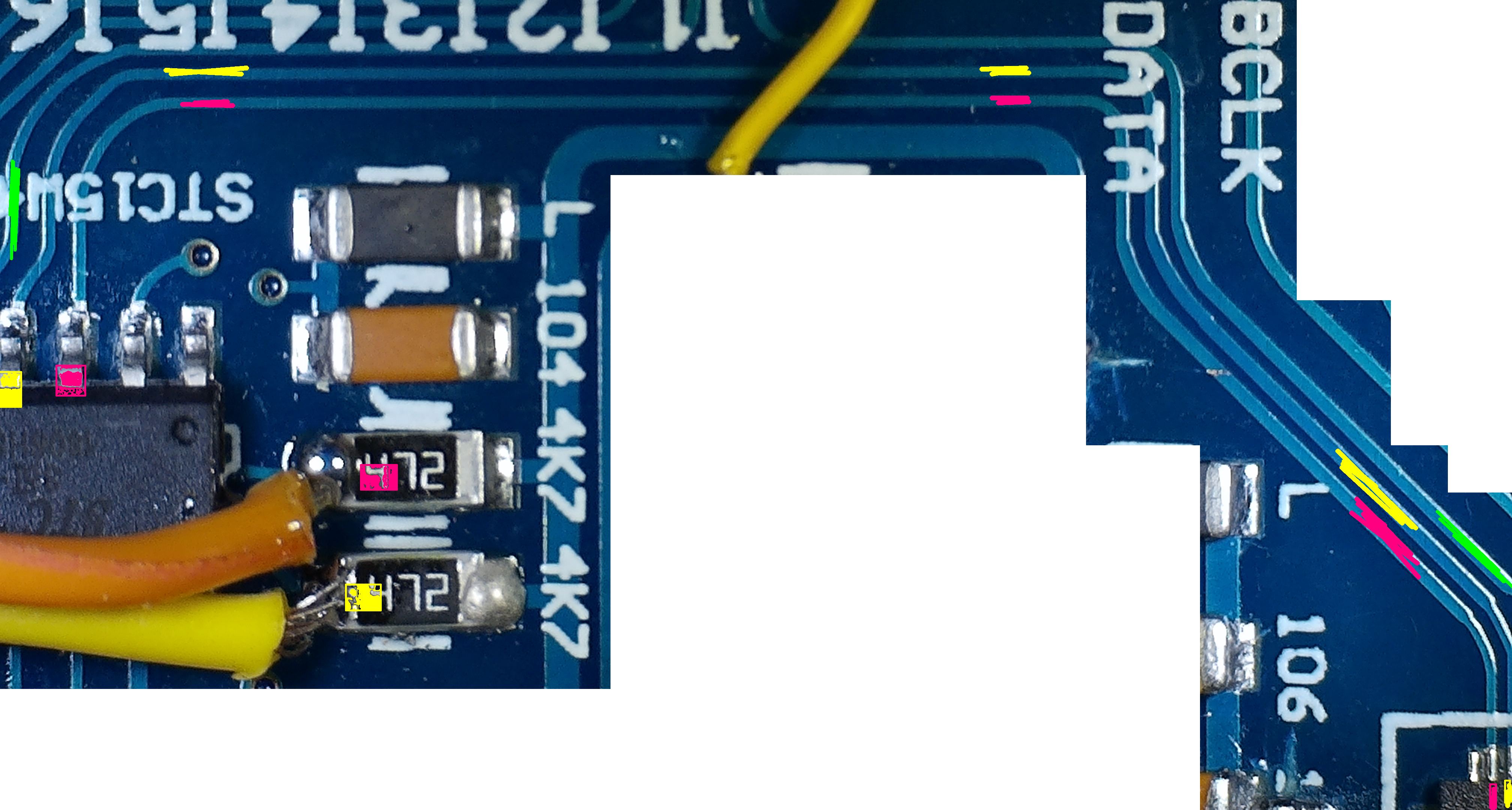

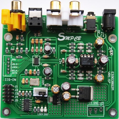

Hi eslei,
Looks like you posted two pictures of smpes v1.07, one of them with AVCC and VCCA power connections outlined. Is that what you intended?
Also, I think it would be okay for you to tell us how you configured your RPi to work with the dac board so far. I think it is relevant to the thread and would be on topic.
Just one thing I tried and can confirm its function is Raspberry Pi + Hifiberry DAC+pro HAT with its own master clocked I2S output. This outputs connected to I2S input (only GND, BCKL, LRCLK, DATA) of the es9038q2m board works well and drivers of each SW for this DAC HAT can be used.
This Setup has 2 advantages compared to I2S Output from RaspberyPi GPIO:
1) the signal is of much better quality regarding jitter as the HAT is the master clock with its own clocks and not the Pi with its jittery on board clock
2) most SW has drivers for this DAC as sometimes it is a problem to get the raw RasPi working in just streaming I2S without any HAT on it.

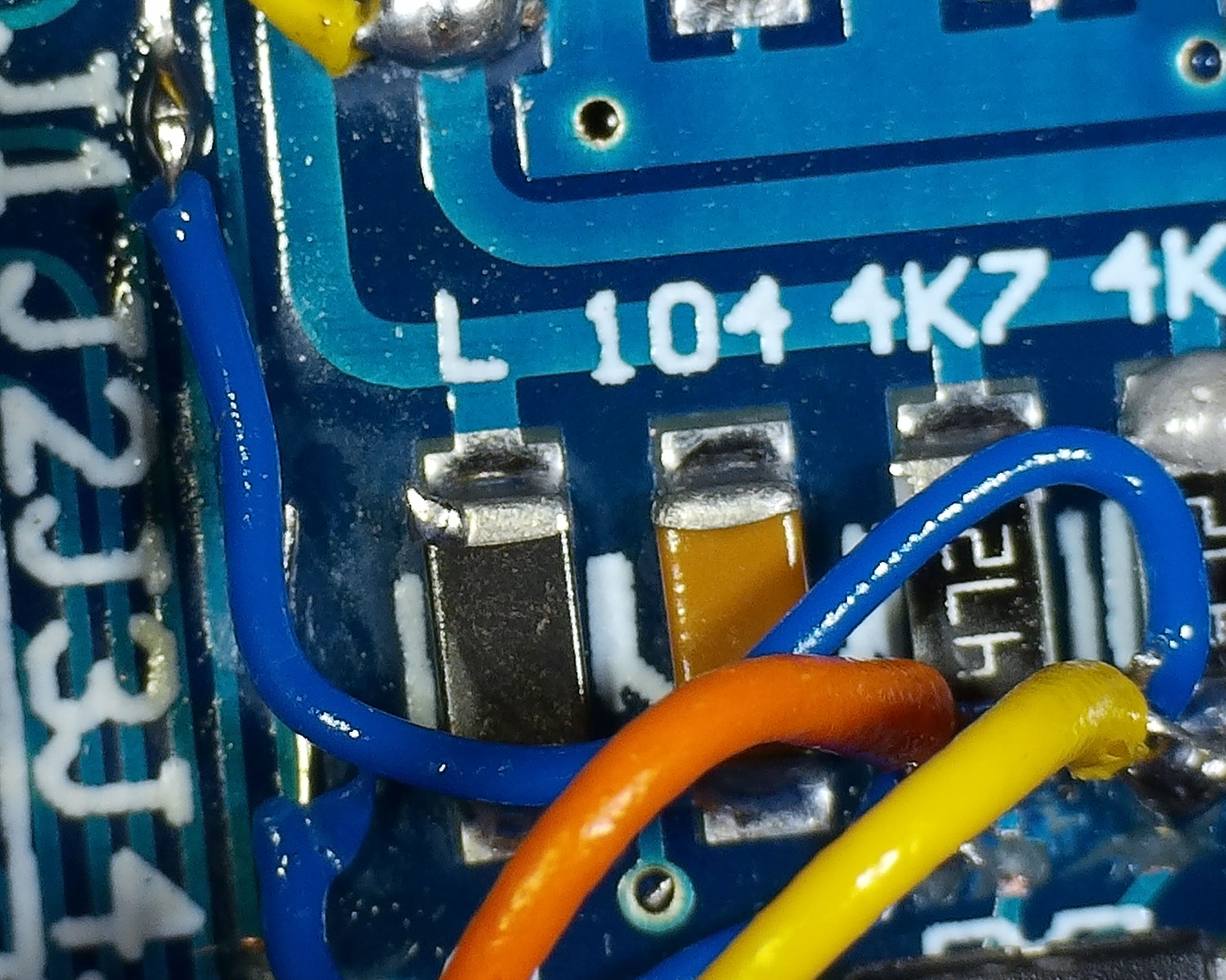

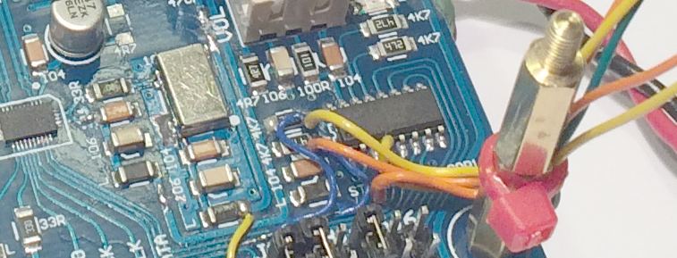

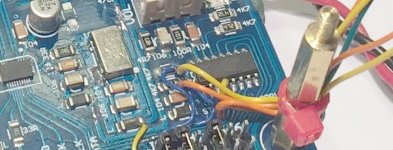

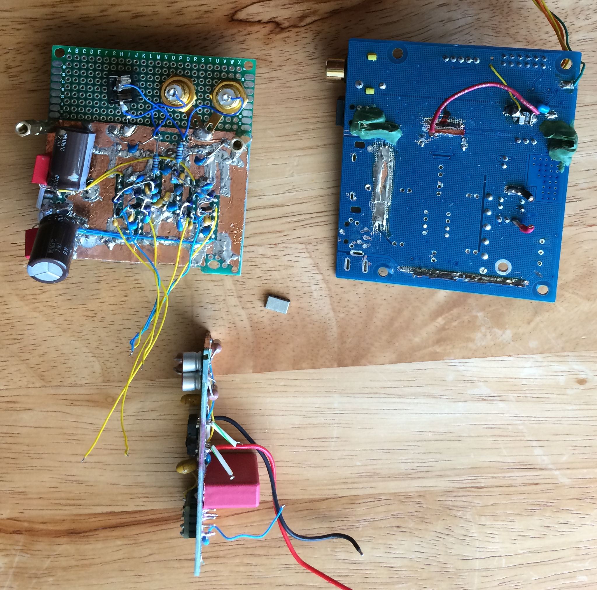

It appears that blue board microcontroller I2C clock signals operate more or less continuously regardless of J1, J2 jumper settings. There are some pretty short gaps that occur periodically and independent of jumper settings, but they are only maybe 280us long.
Therefore, I will plan to do PCB trace mods on this one instead of pin lifting. Maybe it will look more appealing than pin lifting for any blue board modders.

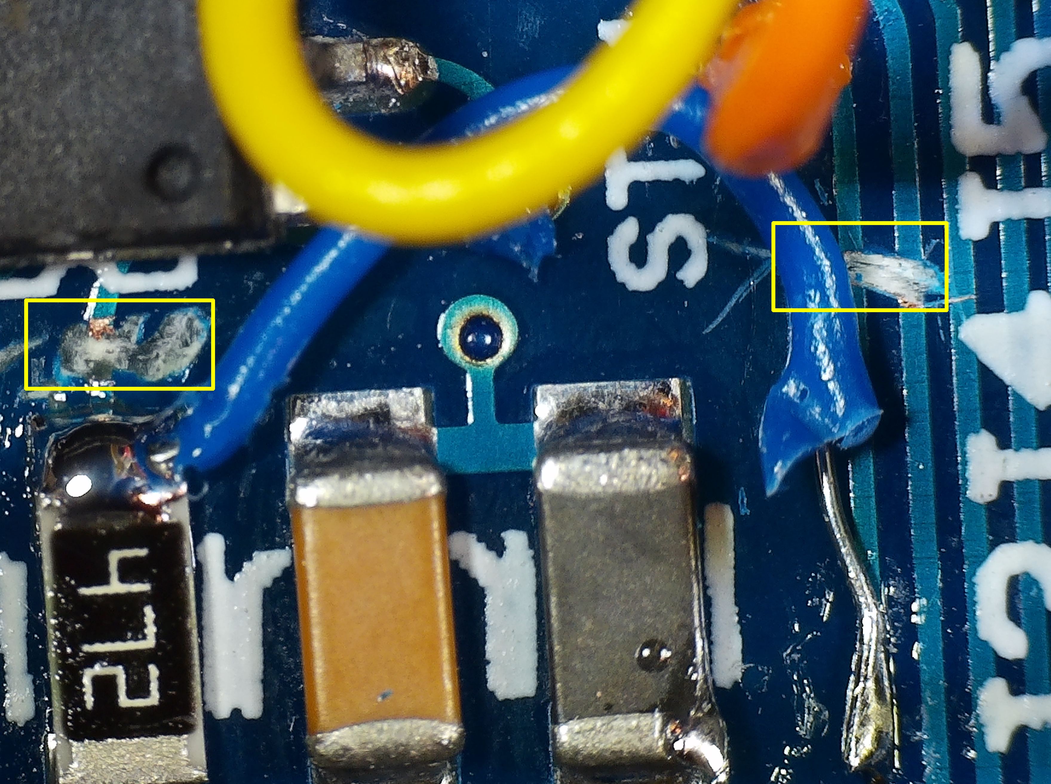

The trace cutting and I2C patching has been completed for the blue board. Where the cuts in the traces where made are outlined in yellow in one of the pictures below. Also, easy to see where I over-heated insulation on one wire when soldering it. Oh well, I will try to be more careful next time and set the iron temperature at the lowest temperature that allows soldering reasonably well. Reason the iron was set as hot as it was, was to melt the lead-free solder on the board. Too hot for that particular insulation though.
The wiring rings out okay, so the board will go back in the test system to see how much harmonic compensation it needs. Guess would be that it probably needs more than the first modded dac since the .1% metal film resistors this time aren't as good as some of the .01% thin film resistors I was able to use last time. If it turns out I guessed right, that might be a reason to consider using thin film resistors mounted on SurfBoards or some similar arrangement when building a nominally through-hole-component version of the dac mods. After all, Surfboards are through hole components 🙂

Seem to have run into a very worrisome snag here. Hooked up everything to start checking HD compensation, but thought the audio sounded a bit more scratchy and distorted than it should at this point.
Back when I installed the clock, I put it on its own voltage regulator which is the same as I did for the 1st board. However, on the first board I also put VCCA on its own regulator and I decided to see how this one sounded before doing the same on it.
Well, based on the sound quality as described above, I decided to go ahead and do it now. So, I cut the trace to the VCCA filter inductor to separate it from the dac board 3.3v bus. Checked with a meter to make sure it was cut all the way through, but it still showed as connected at about 4.7 ohms.
Troubleshooting a bit, I cut the trace just before VCCA goes to the dac chip pin. Turns out the short is either where it is soldered to the board or inside the dac chip. Not good. I will try wicking the solder off the pins in that area and see if any change. If not, then the dac chip/board may be bad.
That could cause a significant delay to my project. Don't know yet. In the worst case, we are about at the end anyway, so shouldn't hold anyone else up. More later as I know more.
Hi eslei,
@Markw4
es9028q2m v1.01 on left is avcc and vcca power connections outlined.
es9028q2m driver have a look this:
ES9028Q2M driver for Raspbian based distro
and this:
GitHub - VinnyLorrin/ES9028Q2M-Linux-Driver
it works for es9038q2m hardware volume as well.
