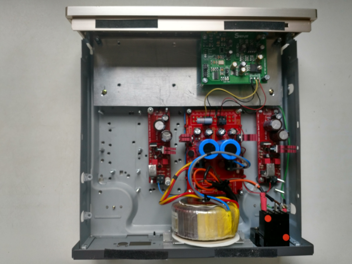

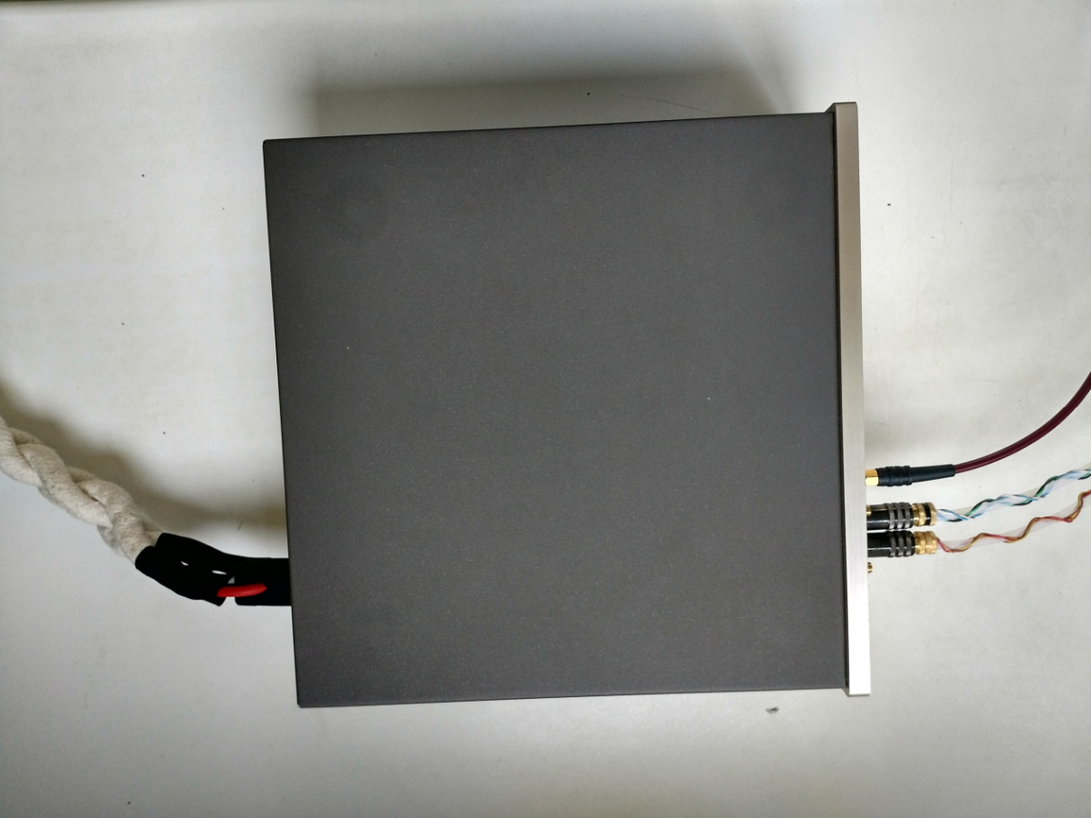

At the beginning of this thread I bought the basic DAC-board and boxed it into an old tuner case. Attached are some pictures. As a simple +/- 15V power supply serves a John Linsley Hood ripple killer followed by a classic LM317 / 337 modified as per JBeau in a hardly noticed diyaudio thread. The wiring is all solid core wire. As you may notice on the photo I am using my diy cables (also solid core) for mains, interlink and SP-DIF. I will not expand on that in order to prevent this interesting thread from the usual flames, but it merely illustrates my long quest in audio. As for the question whether diy’ers are interested in more specific ‘guidance’ in modifying, I enjoy the concreteness of the past weeks. A blog type write-up is excellent in a fuzzy front end, and now it enters a practical level where diy’ers like me can chime in. The build challenge is in the detail. In the past 35 years, as a non-EE I have learned how to read and understand schematics, and convert them into a working unit. A pcb-layout, or preferably a pcb, really contributes to a successful build. So please continue this adventure.
As for the sound of this – still unmodified – es9038q2m, I recently had the opportunity to compare it with several commercially available dacs of undisputable make, but containing a different kind of dac. The ES9038q2m sounded very much ok within the limits discussed in this very thread, be it that the mid/low area is somewhat shy. Alas, that is exactly where music comes to life. Some say it is inherent to this type of dac, but I am open to explore the diy-options for improvements. So yes, I am curious and prepared to heat the good old Weller. As you may see from the picture, lots of room available for adding some additional circuits.

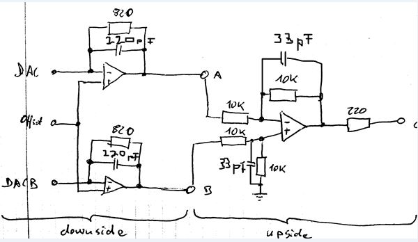

...Will you be making up a layout drawing to share with us here? ...

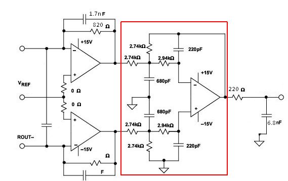

Yes I will, but until now, I'm not sure about the diagram for the I/V section. Is it one of those?
And witch opamps are recommended?
I can start with the design on a green hole board until my es9038 is from china in switzerland.
It is the printed drawing on the right with red box. There should be 3 sockets for standard pinout dual opamps. One dual I/V opamp per channel, and one dual opamp for differential summing of both channels. Add decoupling and local filter caps as appropriate/needed. Different opamps can be tried, but LME49720 should be good. Plan to eventually mount this board at the end of the dac board approximately as shown in the mockup back at: http://www.diyaudio.com/forums/digital-line-level/314935-es9038q2m-board-246.html#post5532648
