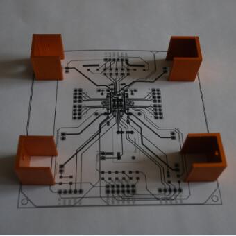

Attached are a 3D illustration of PCB that I have finished so far. Size is 10CM*10CM and can be reduced later if necessary. Nothing fancy. The circuit is pretty straight forward as provided by the factory (I might be able to post part of the schematics if the factory allows).

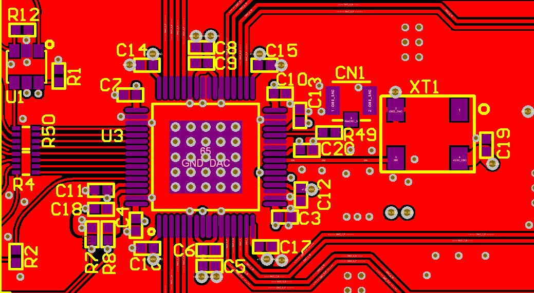

Eventually decided to move the digital ground to the third layer. So now the analog output and digital inputs traces are on top; (almost) all the power supply traces on the bottom; I2C traces are either on top or bottom or both through via depending on the ease of routing; a complete solid digital ground on the third layer; two analog ground split second layer; all SMD components on the back side (except the DAC chip) and footprints were purposely chosen to be reasonably large (1206 mostly).
A few more vias than before but I think the trade-off is reasonable. All the bypass caps and vias are close to each other and power pins. Force complete tenting on all vias.
Now that vias are unavoidable, the analog bypass caps will be through hole. Either film or ceramic caps are easily available.
Pretty much done with layouts.
Not quite sure if I need to connect the digital and analog ground planes in some way (small resistor / capacitors?). Need to read some further references.

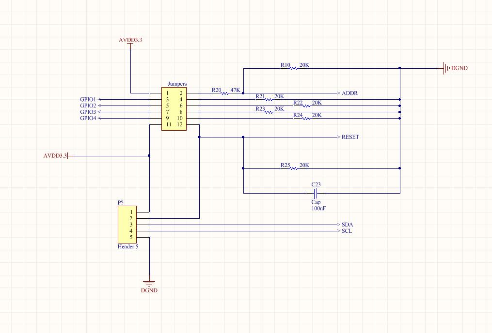

Control / Register Configuration
This is the part that I am most unsure about (though it affect the sound quality least in some sense). Like I said, the manual is hard to decipher and I might have to build or find one control module to make sure, but this is the current configuration:
GPIOs are pulled down to ground with 20K~47K resistor, but not directly. I put a jumper/header in between. When headers are shorted, GPIOs are pulled to ground; or one could instead install LEDs in between.
ADDR can be pulled up or down through jumper. Default is down.
RESET is pulled down in default. Can be pulled up through jumper (hold for long enough, and maybe a push bottom is better). For good looking I put it in a 6*2 headers.
SDA and SCL are connected to headers directly. Not pulled up or down.
I really am not sure if this setup is enough for most external control module. I will have to try. And inputs appreciated.
Attached is brief schematics about digital inputs and control.

For what its worth. I just finished laying out a board for this and I found it tricky. All the different power rails and the layout of the oscillator and digital I/O I found a pain. Seemed like everything was a compromise.
Not sure if this is helpful but I might:
1. I wouldn't do anything less than 4 layer for this chip. Too many power rails and digital I/O.
2. Since you have room on the board I'd think about putting on-board LT3045 or something from Analog Devices with low noise. Leave a header for a shunt regulator so it can be an OR power option. Looks like you have room for this. If the PCB area is free, seems like no harm.
3. Beef up all power lines. This is hungry IC. Thick power lines would be good.
4. Not sure if you want to make the jump to smaller by-pass caps but I put them on the same side as the IC close to the pins. 0402 fit onto the same layer as the ESS9038pro.
Looks like you got all the important stuff fairly close to the IC so it should work! Hope you have fun with this project. I put all the regulators on the bottom layer and cleared a space on the top for heatsinks just in case.
Attached is a small top layer short of what I did around the ES9038pro. I have not had a chance to get the parts on this board yet but looking forward your experiences with this.
