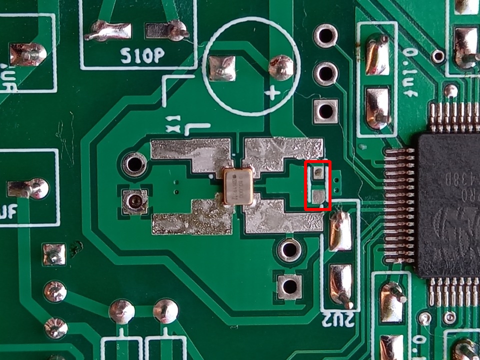

IME it means there are probably still other problems with the dac implementation, and or possibly with the clock power and or bypass implementation. May I ask how you are powering the dac board, and how are the power supplies wired up? What kind of power transformer? IME everything matters for getting a dac to perform well. Can you post pics?
Also, may I ask about the rest of your system (power amp, speakers, preamp, etc.)?
EDIT: There should be an SMD bypass cap in the location outlined in red in the pic below. One electrolytic cap to bypass the clock is not a proper implementation. You could use X7R, but IME a .1uf or .22uf film cap in SMD size 805 works best for clocks. Digikey carries some good ones from Cornell-Doublier or Rubycon. Up to you though.
Layout around this oscillator is terrible.

Maybe okay, probably not ideal. Could have ground noise problems too, IME it is not uncommon. Hard to say more without hearing it.
It would still be helpful to see pics of the dac with all the power supplies and interconnection wiring. Maybe some opportunities for easy improvements. Again, hard to say without seeing it.
