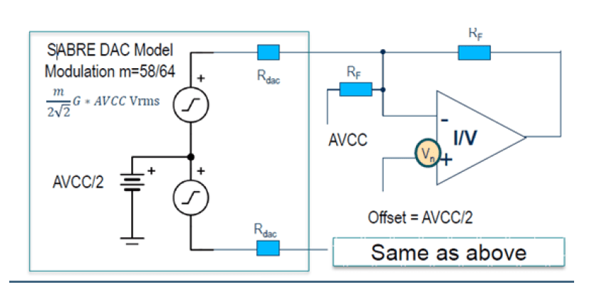

OK, the Norton vs. Thevenin equivalence 🙂Yes, because ESS9038Pro output is not real "current output" but voltage output with 200 Ohm series resistor.
I think real series resistor is unlikely because how could one establish constant voltage across it to avoid distortion from its large voltage coefficient? Clamping the output voltage to a fixed voltage by an I/V would increase distortion rather than lowering it.

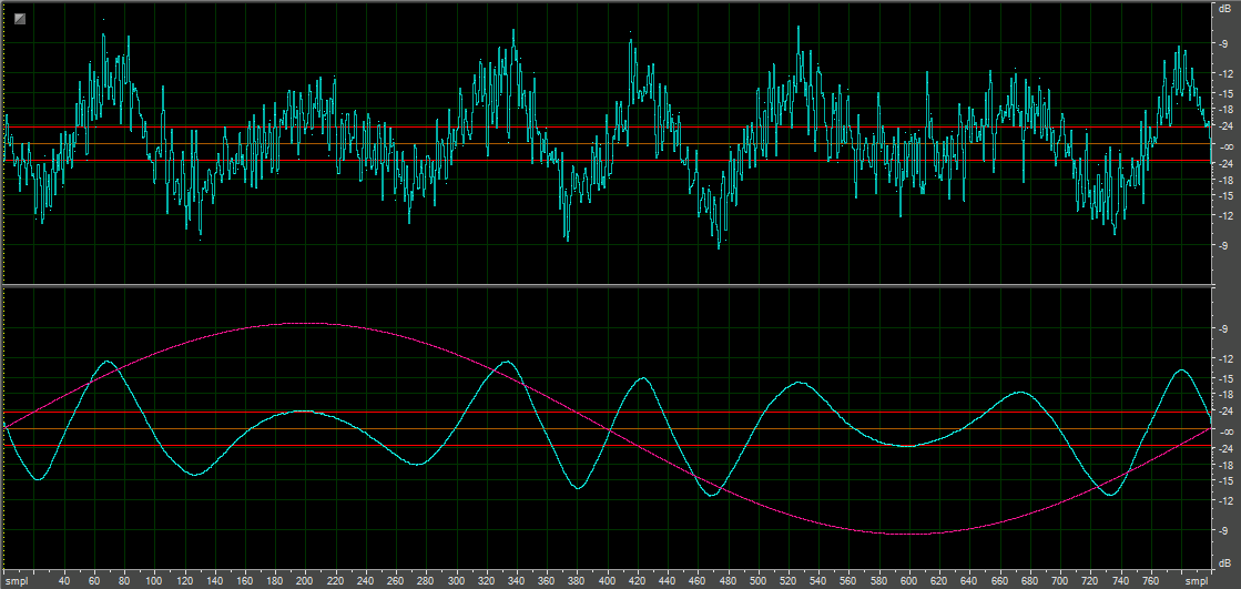

That plot always puzzled me. The glitch pairs appear to be systematic in that they happen at some offset at either side of zero crossing and in the glitch direction, but why is there no glitch pair at 40ms?
Maybe.I think real series resistor is unlikely
@KSTR I could take a guess about the plot and why it differs from yours, but it would just be a guess.

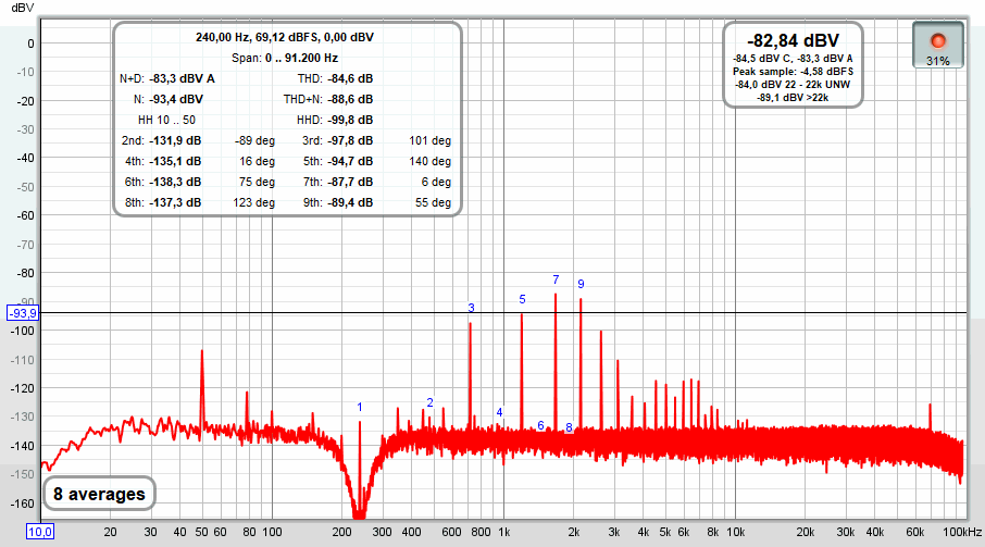

At least we know Hyperstream modulators are very unusual based on their noise vs DC offset plots. Don't know if there might be some modulator difference between ES9018 and ES9038Q2M. It has also been observed that ESS dac distortion and noise can vary depending on clock frequency. Probably a different opamp in each case too.
😃 I don't know russian laguage, is not my type. For a full schematic see the es9039pro datasheet.сan you insert a full schematic?
