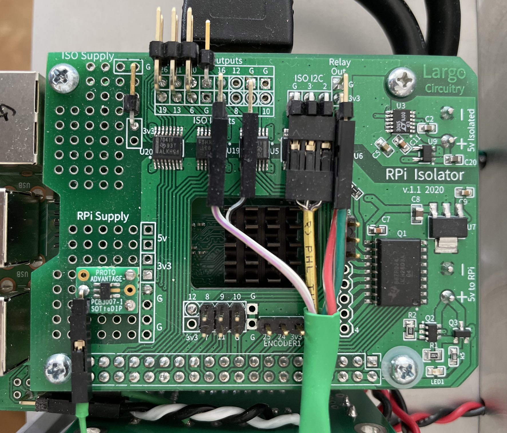

I am happy to participate in this discussion, though my own design priorities may not be widely shared. I made an isolated RPi interface simply for control purposes, and it is proving to be quite reliable and easy to work with (photo). It does not touch any music signal, it is strictly for control. But at the moment I'm fighting with Javascript, Ajax, and HTML to move my project along. Thus, I have not a lot of time to help others until some basic network functions are working well in the control system...

a) Python is fairly readable and therefore accessible for non-programmers to modify.
b) Any Debian-based OS on most of the SBCs should work with my code.
c) Galvanic isolation of GPIO controls is not required, though optimal.
d) My general-purpose GPIO isolator board will power any SBC with RPi pin definitions.
e) I’m happy to make the unpopulated isolator boards available to DIYers - all ICs and passives are surface mount.
f) As my hardware project winds down I’ll start a new blog-style thread on browser-based DAC controls for sharing and idea interchange.
