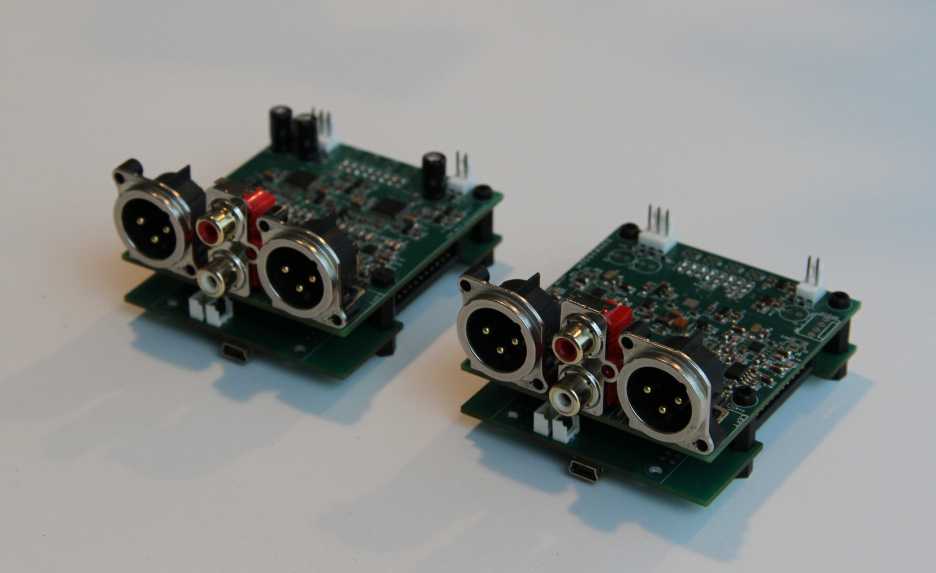

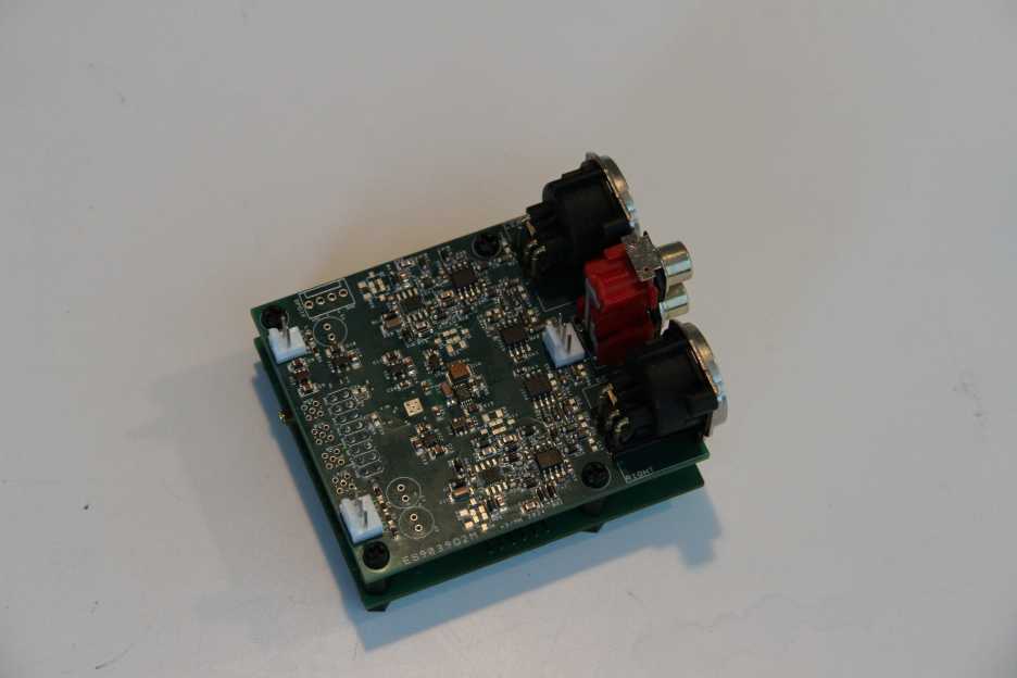

It may seem surprising but ES9039Q2M actually performs better than ES9039PRO. With proper output stage ES9039Q2M beats all current consumer dac chips (and MolaMolas) in the numbers game.
Here's mine at 0dBFS without any THD compensation gimmicks: https://www.diyaudio.com/community/attachments/es9039q2md_r_ak5394_r_0dbfs-96k-jpg.1337493/
(This is with Cosmos APU between DAC and ADC which explains the -11dBFS level).
did you publish more than the graph, e.g. a description of your configuration, a picture of the board or even a schematic? thanks
The output stage I'm using consists of just an I/V op amp stage but the op amp is a composite. There are many ways to implement a composite op amp. Mine is similar to what Samuel Groner and Martin Polak published in 2017 (https://www.diyaudio.com/community/threads/samuel-groners-super-opamp.337866/). That composite op amp provides the differential output and for single-ended output there is a summing op amp so in total 5 op amps per channel.
Attached is a picture of the ES9039Q2M dac and another with my dual AK4493 dac. The board below is my USB-I2S board. All my diy dacs have the same format so they can be fitted in the same chassis (shown here with RTZ dac).
Thanks for the link to the super opamp link. I was thinking along the same lines after seeing the output stages proposed by ESS for the 9039q2m and especially the PRO. Those OPA1612 see an awfully low load, so a composite will help just by removing the output stage from the input stage, even before the extra loop gain kicks in.
I am not too keen on using a resistive divider in composite op amps because it throws away gain, but I guess if you need to be unity gain stable, that may be what you have to do.
