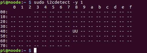

It seems like the DAC is not properly configured. The driver is developed assuming the DAC is fully controlled by I2C and the address should be 0x48 (ADDR of the chip == L). If yours is different I might need to recompile it for your case. We need to run some tests.
1. install I2C-tools by 'apt-get install i2c-tools'
2. 'modprobe i2c_dev'
3. 'i2cdetect -y 1'
You should see the i2c bus detection results and a 'UU' should locate at address 0x48.
If you do see it, then do
'i2cget -f 1 0x48 0x07'
This commend read I2C device at 0x48, register 0x07. Please post the result.

Ha, I see the reason. Your DAC is 9038Q2M, it has different internal register definition as 9028Q2M. The driver writes wrong values to the wrong register, causing the DAC's failure. To fully solve your problem, I need the datasheet of ES9038Q2M. If anyone can send me one copy I can make a driver for it. By the way I have already signed the NDA with ESS.
Yes 9038....thought it was worth a try.... happy to be a tester..
screenshot of i2cdetect attached. Seems at 0x48 so shall I try 'i2cget -f 1 0x48 0x07'
Dac seems to play but only 24 bit files.... resampling works but still horrendous switching thumps between tracks...
Yeap, the behavior is expected. A register needs to be set according to the input bit depth, and its default value is for 24/32-bit file, that's why you can still play it. You can try to resample everything to 32 bit then all the files should be able to play. As for the switch pop, it is because the DAC is not properly muted when the switching is happening.

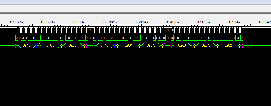

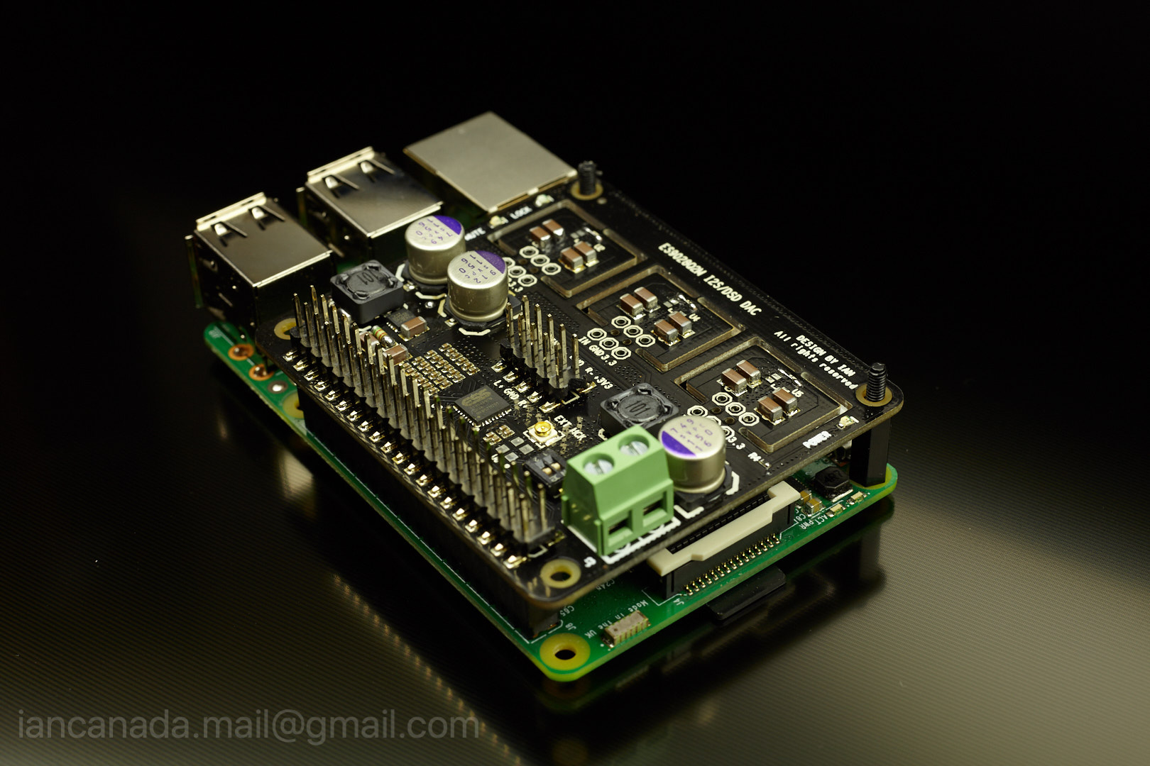

Hi, I have a good news:
I integrated gandolf Raspberry Pi driver with Moode4.0 today by following his instructions here
http://www.diyaudio.com/forums/pc-b...driver-raspbian-based-distro.html#post5361108
It works!
My ES9028Q2M DAC receives control package from I2C bus. Both volume control and 44.1KHz 16bit format are functional.
The sound quality is very good. I've noticed that you optimized filter settings, bandwidth and something else.
I'll go ahead with more tests. I may have some questions later.
Thanks gandolf, you did great job.
Ian
