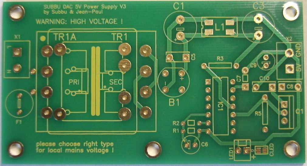

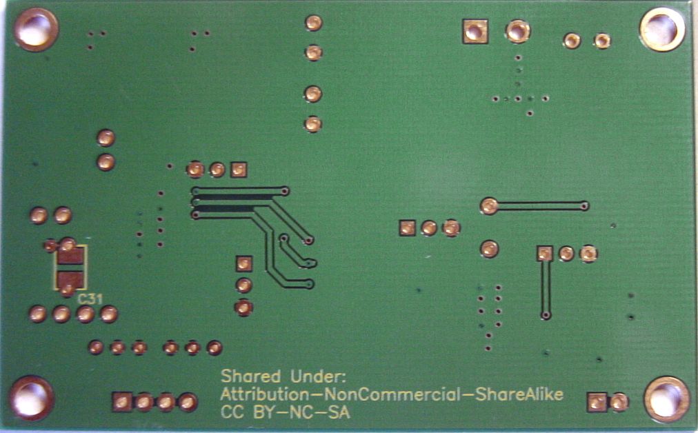

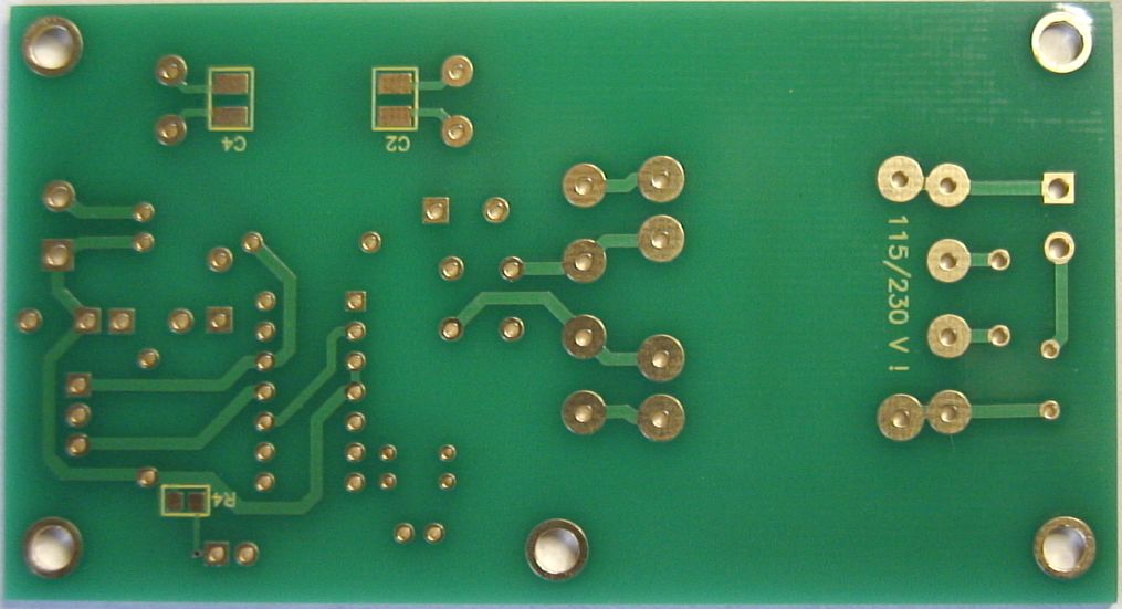

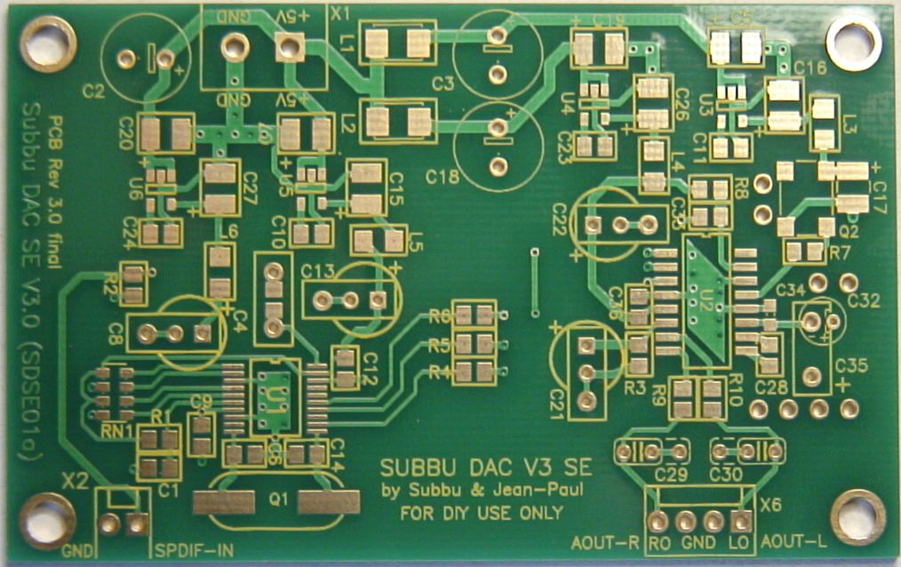

How do the PCBs look bcmbob ? Can you post a picture ?
Just got a letter the other day telling me that german customs has my package as it had no receipt with the value...Now I have to pick it up and they will charge for every day that have my package in stock 😡
They look clean, professional and sturdy.

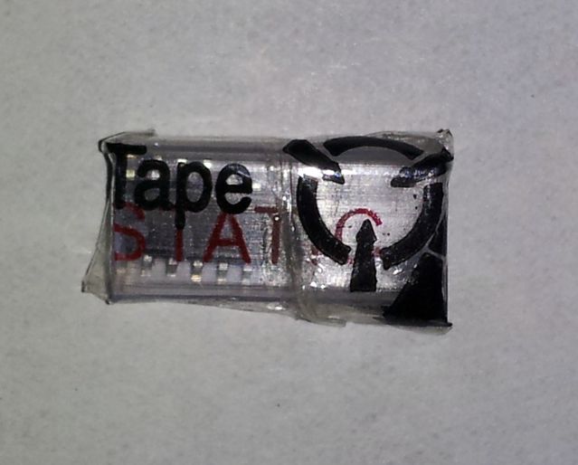

Also received what I believe is the DAC chip - But it's staying in the tape till assembly.

They look beautiful. Can't believe they are for real now.
BTW the "loose" plated through holes near the XO and Vneg are for experiments with shielding. Untested but some of you might want to try that. Please don't forget to connect the shield to GND.

Tip: start with soldering the resistor array, then MIC regs and then the WM8804. Those are the hardest to solder. Especially the resistor array is a tough one.
