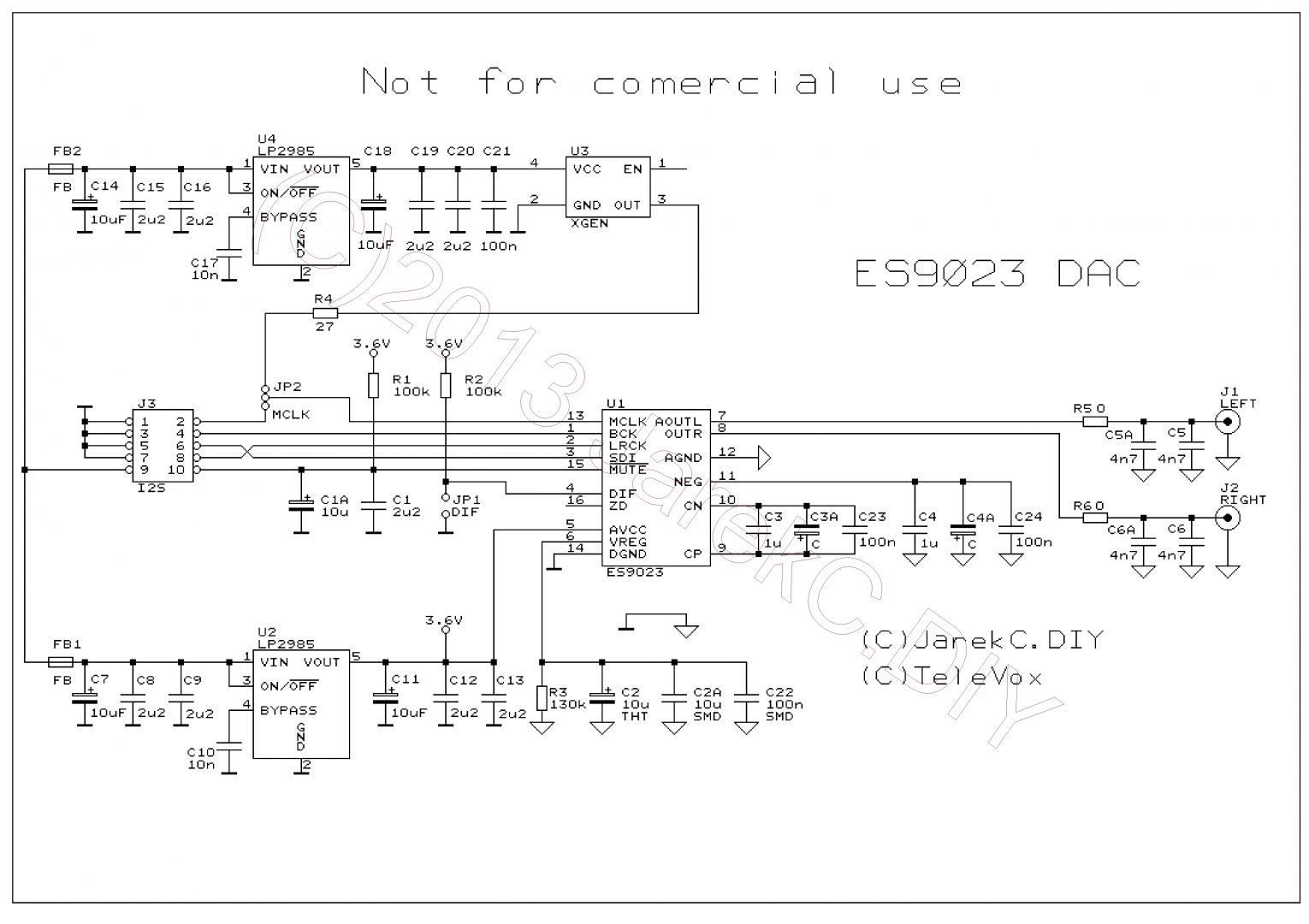

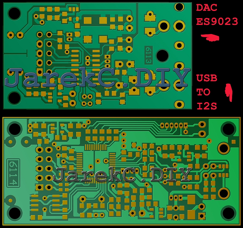

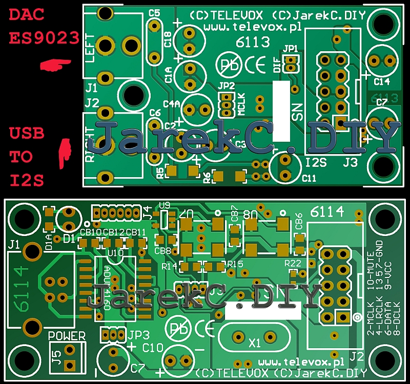

I finished project of the PCB for ES9023 Sabre DAC.
PCB is compatibile with my USB-I2S converter (TAS1020 based,asynchronous, low jitter XOs, galwanic isolation ADUM3160).
More info about converter is here:
http://www.diyaudio.com/forums/digi...pdif-converter-24bit-96khz-9.html#post3328142
- DAC can work with own 50MHz oscillator or synchronous witch MCLK from USB-I2S converter.
- Critical elements (capacitors) can be mounted THT or SMD.
- I2S connector is Pin2Pin compatibile with converter
- Boards can be stacked
Today I sent the board into production.
Prototype series (10pcs) will be available in about 2 weeks.
Best regards,
JarekC
