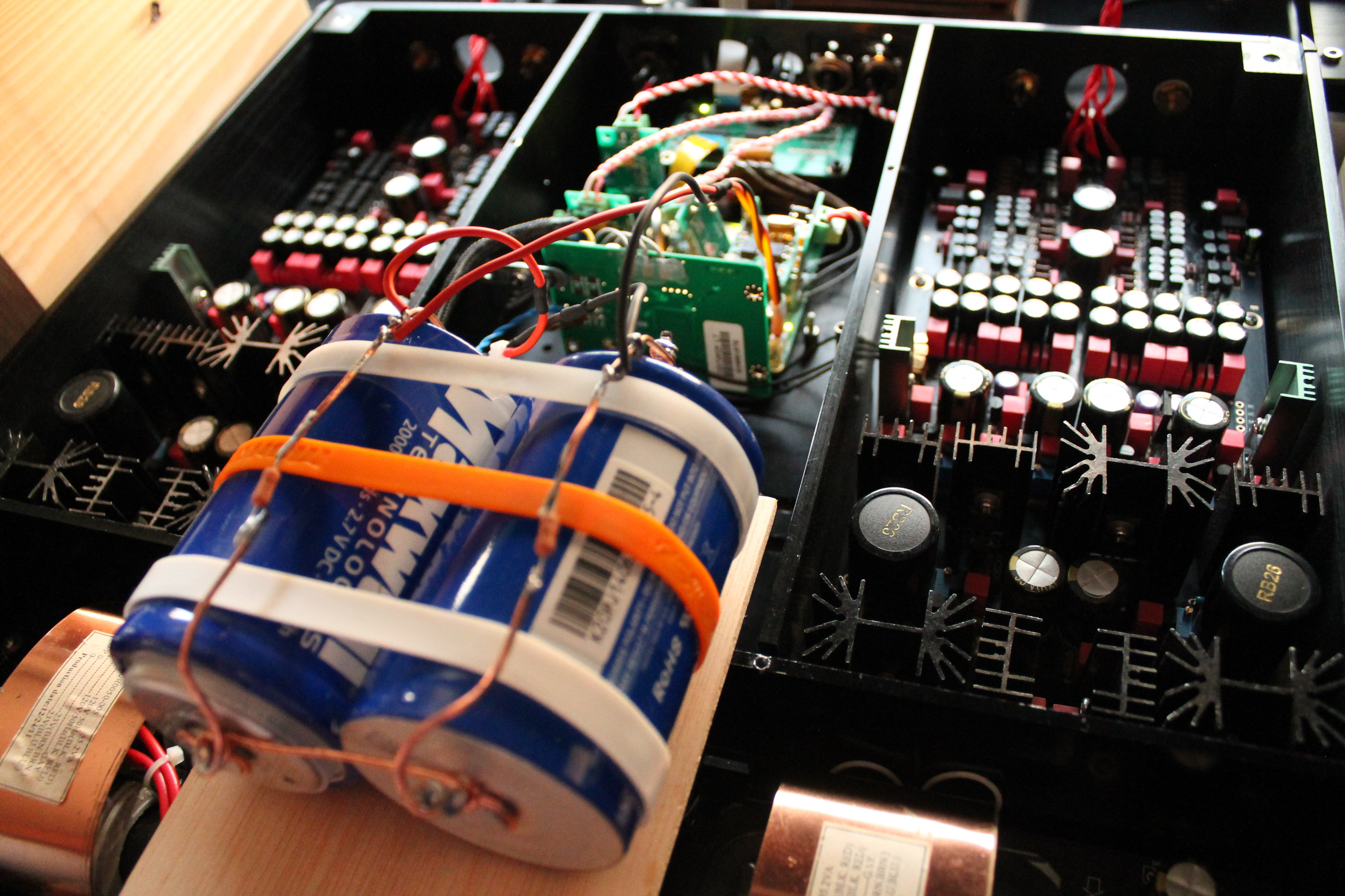

The connection between the 2 supercapacitor is also to see ,Maxwell recommended a bus bar which can be welded,but only by laser welding
that's the ideal connection
I feed the I2S to PCM converter and the clock board together at 3,3V,with the Maxwell 2000F it allows me 2 hours of music from 3.45V to 3.15V.
Compare with a Reflektor and Lifpo4 the vocals,low frequency,and depth are much better.
