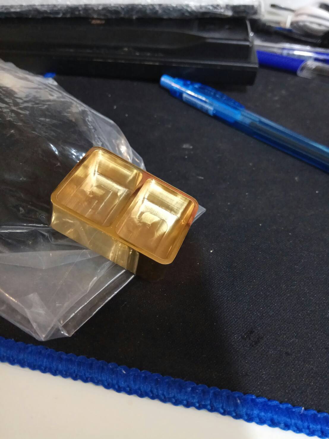

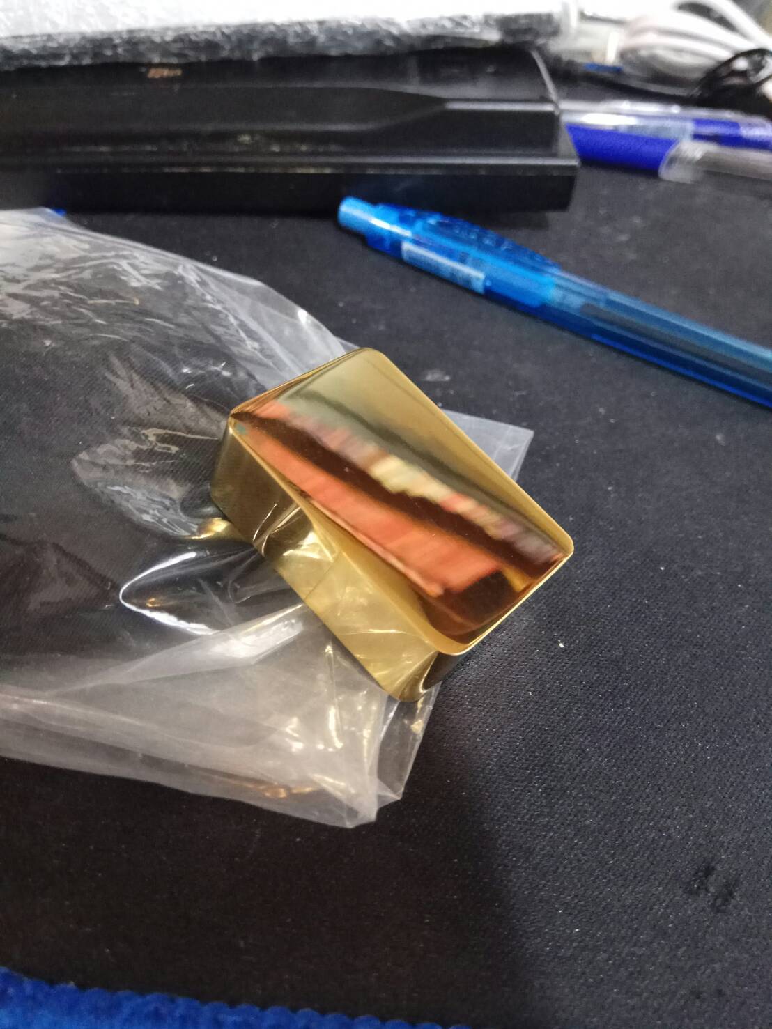

I have designed a metal cans for the clock chip. It was slightly affected on the sound, but it was not obvious. This means that RF noise isn't a big issue? The ground loop noise and cross talk need to consider?
