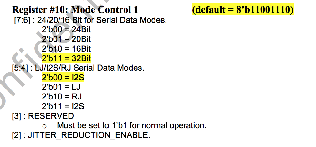

ok i have one more question.
case 0: // Auto detect which supports "32bit I2S, DSD or SPDIF"
// This is default conf. SPDIF can be connected to DATA_CLK line
bitClear(reg11S,4); // Default setting for SPDIF
bitClear(reg11S,5); // Default setting for SPDIF
bitClear(reg11S,6); // Default setting for SPDIF
writeSabreReg(0x0B,reg11S); // Reg 11: x 0 0 0 x x x x
writeSabreReg(0x01,0x8C); // Set to auto mode: 1 0 0 0 1 1 0 0
lcd.print("AUT");
break;
This screch do not setup format, yes?
I add new line:
case 3: // Auto detect which supports "32bit I2S, DSD or SPDIF"
writeSabreReg(0x0A,0xDE);
lcd.print("RJA");
break;
case 4: // Auto detect which supports "32bit I2S, DSD or SPDIF"
writeSabreReg(0x0A,0xEE);
lcd.print("LJA");
break;
Correct?
Register #10: Mode Control 1 (default = 8’b11001110)
[7:6] : 24/20/16 Bit for Serial Data Modes.
2’b00 = 24Bit
2’b01 = 20Bit
2’b10 = 16Bit
2’b11 = 32Bit
[5:4] : LJ/I2S/RJ Serial Data Modes.
2’b00 = I2S
2’b01 = LJ
2’b10 = RJ
2’b11 = I2S
[3] : RESERVED Must be set to 1’b1 for normal operation.
[2] : JITTER_REDUCTION_ENABLE.
7 6 5 4 3 2 1 0 bit
x x x x x x x x pos
1 1 0 0 1 1 1 0 def is2 0xCE
1 1 0 1 1 1 1 0 LJ 0xDE
1 1 1 0 1 1 1 0 RJ 0xEE

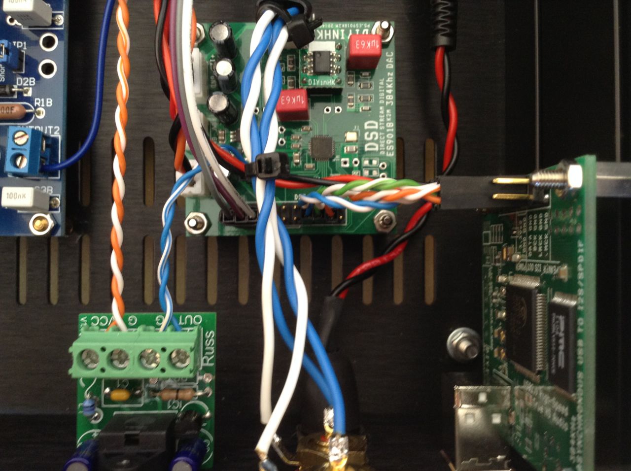

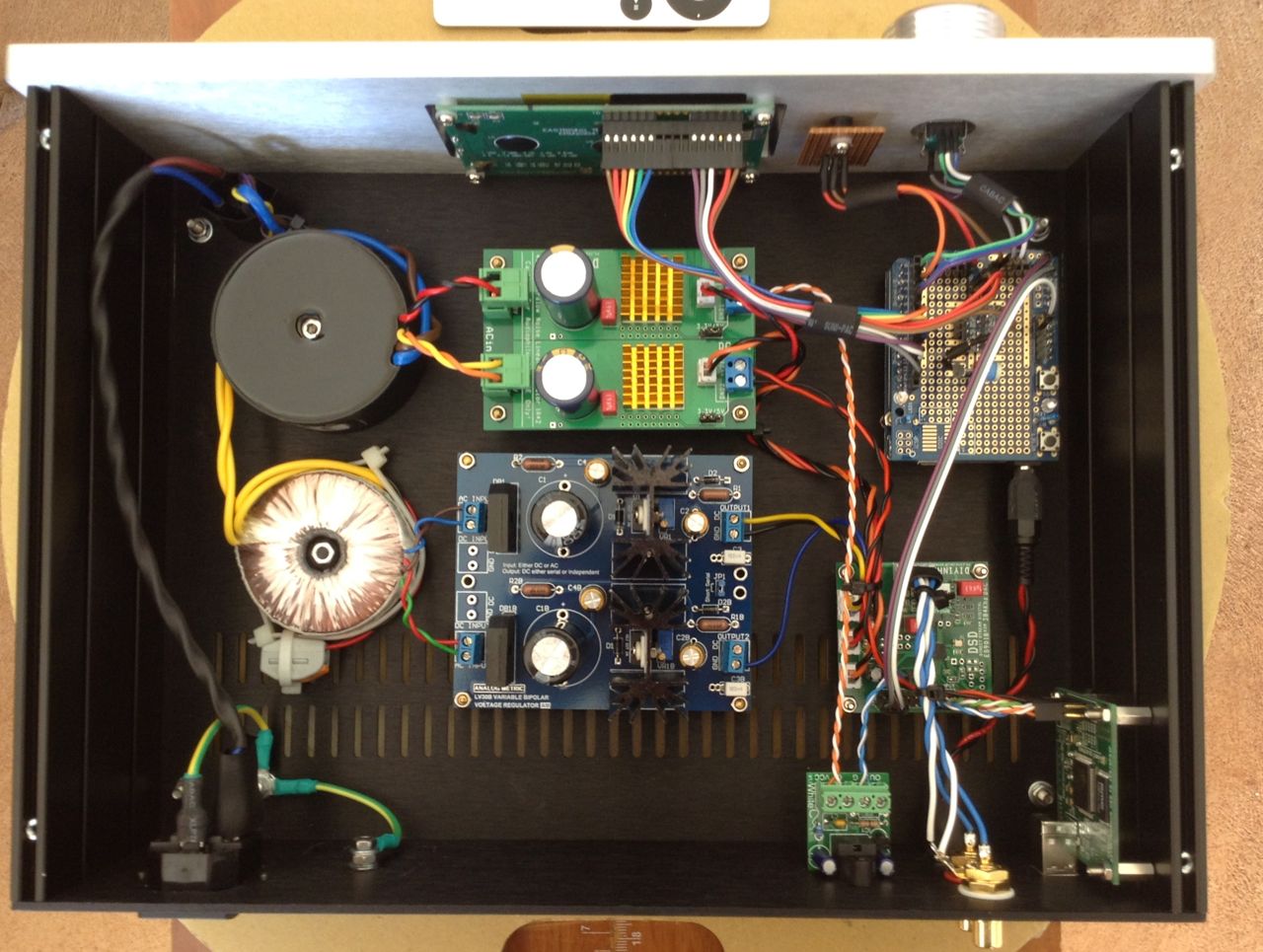

I thought I would post some pictures and info about the diyinhk ES9018k2m DAC that I just finished building.
I have an older board so there is 3.3v and 5v diyink TPS7A4700 power supplies. The opamp is powered by a fairly basic bipolar LT1084 supply from Analog Metric.
I am updating the PSU for a ES9038Q2M based DAC.
My search led me to the same LDO regulator IC that fluid used, but I got PSU boards from Chinese sellers and toroidal transformer from Antek. It is interesting to see how the power supply dominate the enclosure in fluid's picture. In my setup, the transformer and LT1084CP PSU will be in a separate box.
I'm not sure what it is exactly that you are trying to set.
It might be easier to just write a simple sketch that only sets the basic registers to the values that you want and change them until you get it working. Once you know the right values you could easily put them into the hifiduino code if you want the menu and volume control etc.
I have to have in menu RJ for my purpose.
I tested this 10 register but do not work.
This dac is not used for listen music, only for testing enduser device before sending.
At this moment i do not have any dac support RJ and i test then to LJ (wt32) and after sending i switch i2s on the wt32 to RJ (without confirm correct setup).
It will be great to test RJ to be sure,if all is ok.
Could you help to add this?
Register 10 is the one that will change the format of the signal the DAC is looking for. If that isn't working then it is possible the data coming out is not what the DAC expects to find and so it won't play. In the 9018 data sheet it has a diagram of the structure of the different types of data, short of trying the other types or analysing the data from the device to see what format it really is I don't have any other ideas, sorry.
