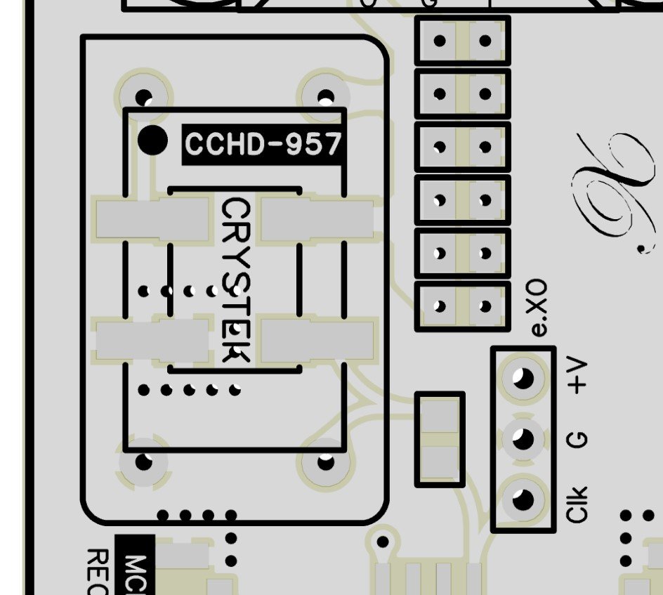

OK! This was missing in
"What else is needed to become an operational device:"
anything else?
anything else?
I've produced a little flyer for a better summary.
Basically you need proper power supply(s), a digital I2S receiver, reference voltage regulators (2 pcs of LT3042 pcbs I can send you free of charge) and connectors, wires ect. to make it work. Micro-controller is up to you...
OK, so 40€ is 3 unpopulated boards - right? Unpopulated as in - no components at all on any of the boards?
Yes, you are right. With components would be cost much more of course... If I have time I'll make a BoM and budget for components.
I'm not clear about how a hobbyist would use an I2S DAC. AFAIK, the digital output of consumer devices (bluetooth receiver, CD player, streamer) is S/PDIF. Would I need a S/PDIF / I2S converter to use with this DAC? And wouldn't that defeat the purpose of the I2S format?
Yes, you need a receiver chip that converts spdif or usb to I2S. I use actually one from DIYinhk (with XMOS IC). https://www.diyinhk.com/shop/audio-...8ch_out_8ch_in_spdif_out/141-fifo_option-null
This conversion is a must, does not defeating anything. The only thing, you have to use a very good master clock and perhaps reclocking circuit to avoid a possibly large phase jitter.
OK. does the board you're designing allow the builder to use SPDIF?By the way, the ES9027 DAC can receive spdif signal directly!
For use IN a device that has either no DAC or when it has a mediocre DAC/output section. Why convert I2S to SPDIF to convert back from SPDIF to I2S again ?I'm not clear about how a hobbyist would use an I2S DAC. AFAIK, the digital output of consumer devices (bluetooth receiver, CD player, streamer) is S/PDIF. Would I need a S/PDIF / I2S converter to use with this DAC? And wouldn't that defeat the purpose of the I2S format?
The spdif input is available through a GPIO pin header. But I have the layout not optimised for that. But for more details I must check it if I will be at home. Do you want to design such a DAC? Only stereo (2ch)? What is your design goal?
I won't be designing anything. I asked because I was deciding whether or not I wanted to get in on this group buy. All my digital sources are S/PDIF, so I would be interested in a S/PDIF DAC. I'm still not sure about this one. It sounds overly expensive and complicated for my modest needs. I would be interested in something like the Subbu DAC. (Thank you, Jean-Paul for that. Mine still sounds great after constant use!)
