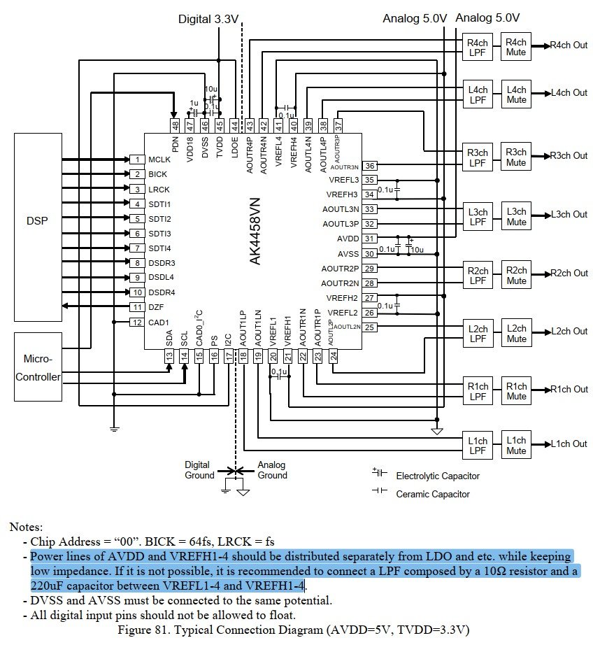

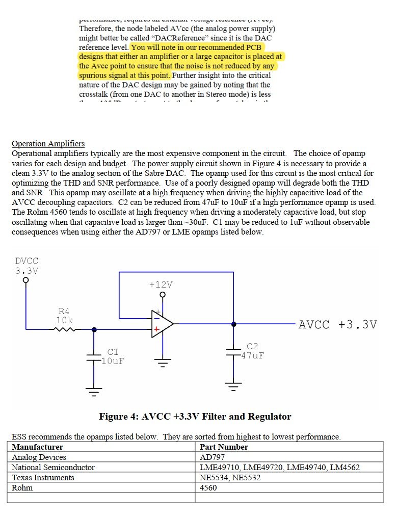

ESS datasheet recommends using ultra-low noise regulators for the critical AVCC supplies. Typically large output capacitors should not be used with ultra-low noise regulators.
Why? Because ultra-low noise regulators are fast devices and a large cap can not change fast enough its charge and this can end in resonance or overshooting? But if it's true, why not place the small caps directly close to the IC pins?
Typically ultra-low noise regulators require low ESL/ESR output capacitors due to high bandwidth. Of course you can and should add small caps (e.g. 100nF-1uF) close to IC pins. The critical supply in ESS dac chips is AVCC. Other supplies do not require ultra-low noise regulators.

There are two type of recommendations from the AKM and the ESS. The former recommends a large cap with a resistor bw. Vreg und AVDD, the latter only a small cap indeed. (see attachements)
As engineer, the "problem" could be solved if I know three things: source - transmission line - load. But sadly, the load side is not known exactly, because it is a manufacturer's secret what's in the black box. The short recommendations and block shemes do not cover up that is going on exactly, what type of load is present. Re-engineering costs a lot of time, money and understandings. So, not an easy task... Or: we can simply copy an existing desing from a well-known device manufacturer and we hope the best...😉
