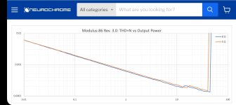

Do you know the THD+N @1W of Modulus86?
With Yewen as I need an input buffer, the THD+N of the amplifier will be that of the buffer. With a gain of 20, for 1W, the buffer must output 140mv rms. If I use an expensive jfet opamp costing about $5, the THD+N will not be less than 0.0006%. With OPA1632 is about half of it but needs a servo or manual offset adjust.

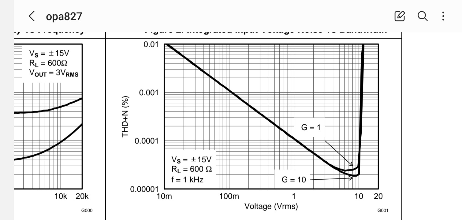

I tried the Yewen version. The OPA1632 can't work without feedback on the positive input. In other words it can't be used as differential output buffer. I switched to NE5532 as unity non inverting follower. This time I had hard time to struggle with the output offset. I could bring within 100mv to hear the sound.
Very disappointing, the grandiose sound got replaced with a mean greedy one although clean but very uninteresting to listen to. It is miles away to bring it to high quality grade.

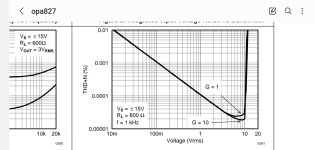

I will leave it for now and restart with NE5532 and servo with a good buffer maybe OPA827.

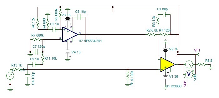

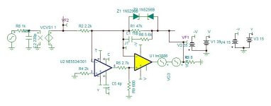

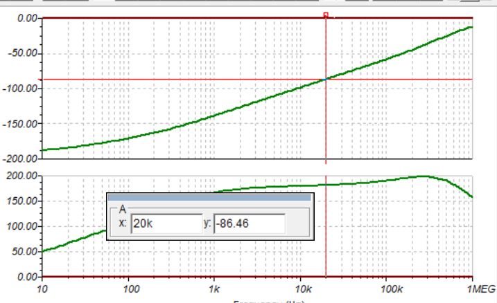

I replaced the AD829 with NE5534, it has -86db NFB@20KHZ. I will make a seperate model to compare them. This circuit is the simplest and most promising.

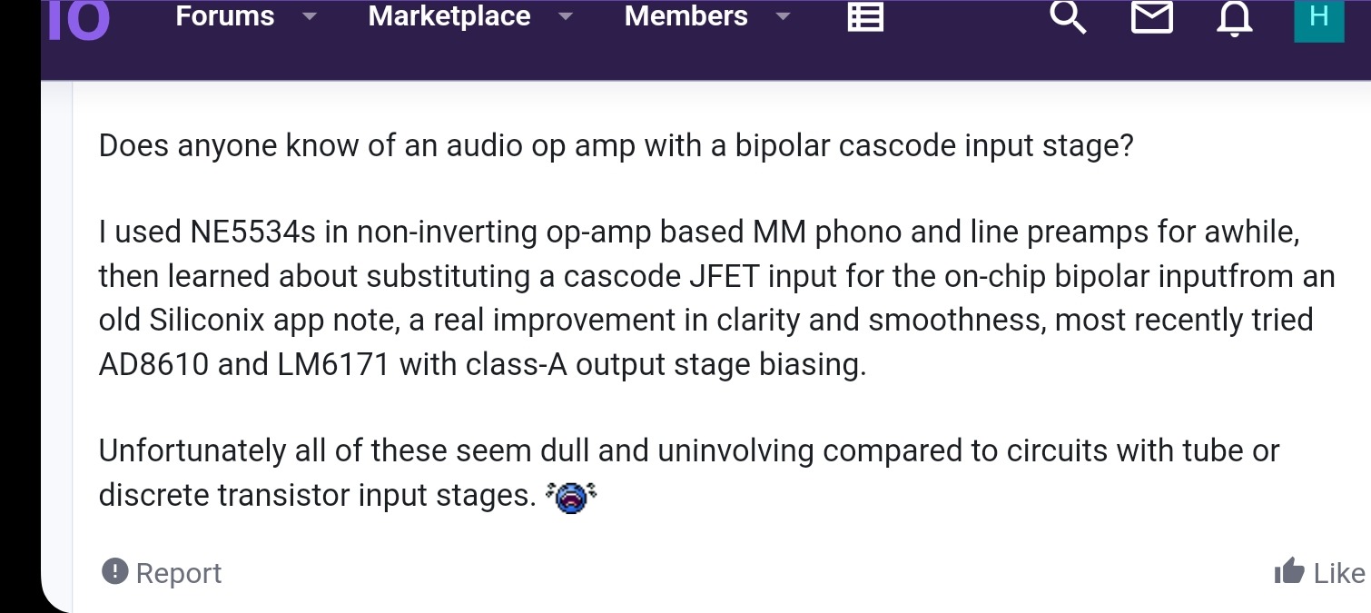

If someone can suggest other low noise opamps with compensation possible I'll try it.

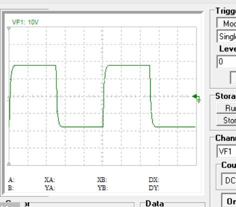

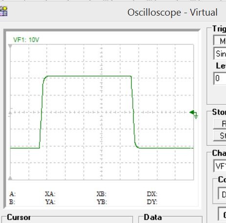

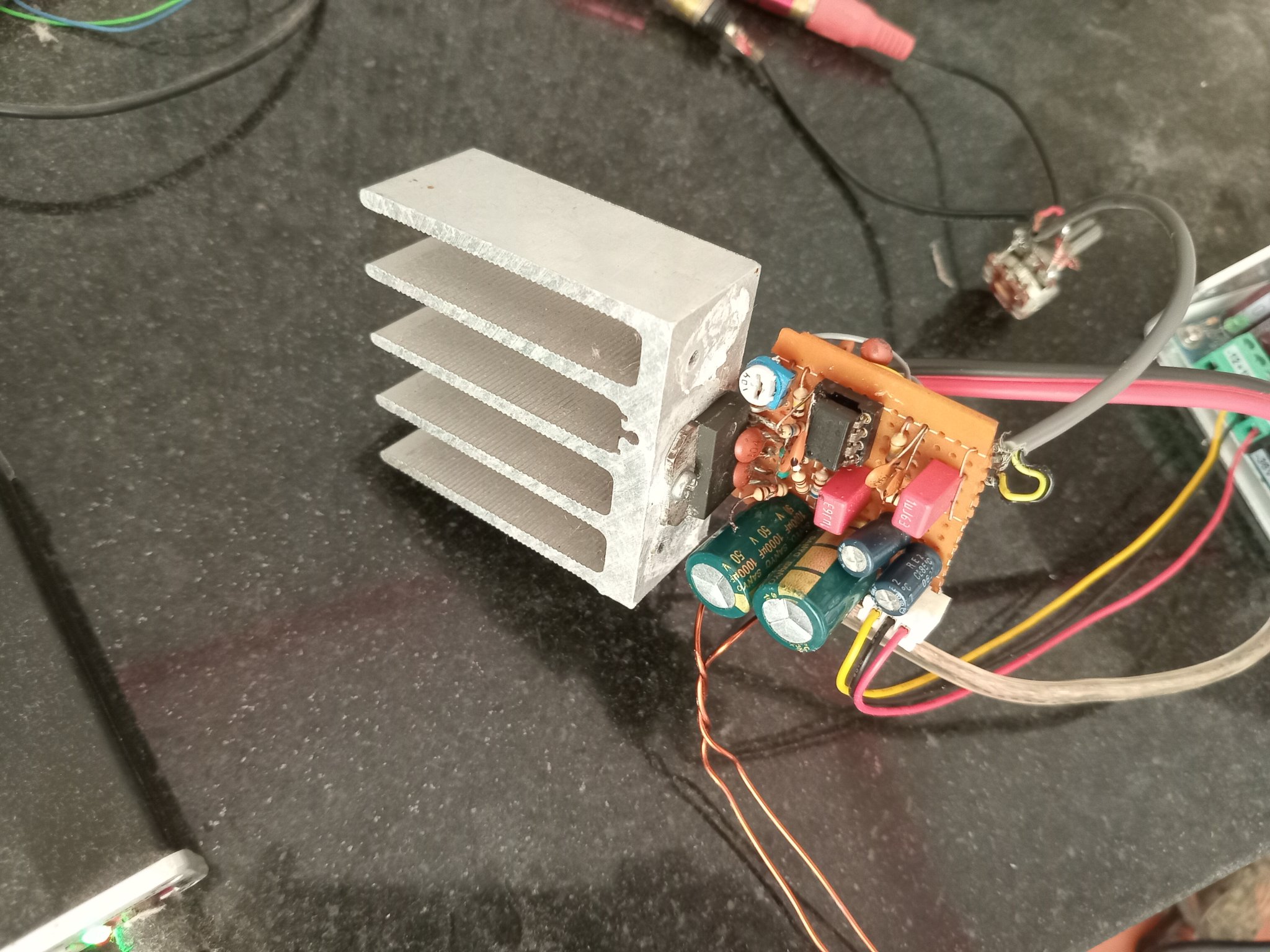

I wired it with ne5534, it needed only 5pf parallel to 120k R1 to be stable. Although I have very low gain , wiring fault, the sound is very clean, vivid, and particularly agreeable to listen.
I will keep this configuration and start from new with magnetic fields canceled to tune the sound correctly.

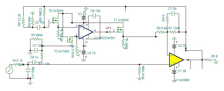

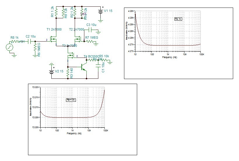

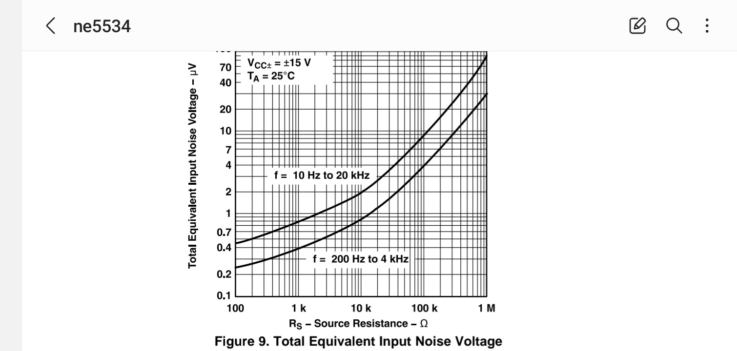

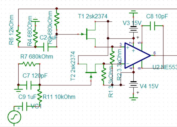

The THD+N with such amp at low powers is mainly noise. If the extra NFB reduces that of the power opamp the noise of the corrector remains the main issue. The NE5534 has ultra low current noise, the graph vs input impedance shows the noise decrease by decrease of input impedance. To take advantage of this character, I will drive the inputs by an ultra low noise jfets the 2sk3557. The simulator model is not correctly modeled as the graph shows but 4 fold decrease is possible.
Using 2n7000 or BF862 gives the same noise as it is dominated by the 10k input resistor. But for sure the noise of the 5534 will decrease considerably as the output impedance of both transistors is 25 ohms with 10ma bias.

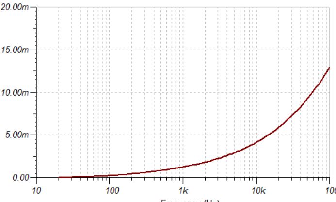

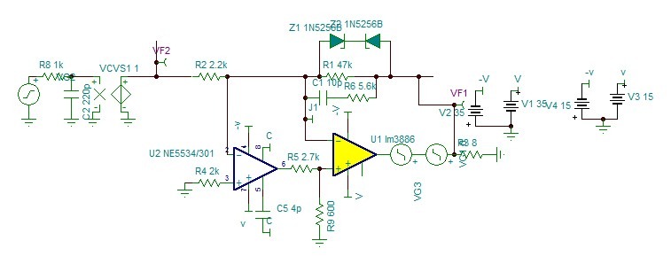

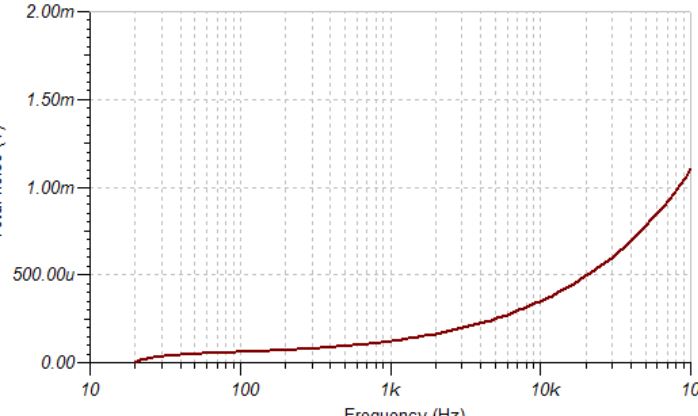

If I replace in the simulator the power opamp by a voltage multiplier, I get exactly the same noise, a proof that the nonlinearities of the power opamp are canceled. Unlike composite type the error corrector output is in mv range as it provides only adjustments, this why the distortion of the corrector itself is not important as is for the noise.

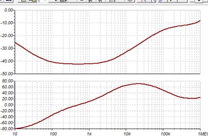

The NE5534 needed an output MOSFET buffer which allows to run in classA and offer low impedance to the power feedback. The graph bellow shows relative output of the opamp to be less than -40db in the sound range. It needs less than 2Vp input to saturate hence 20mvp max is the error output.
To notice that unlike Modulus86 publicity, we don't have here a precision opamp controlling a les precision power opamp.

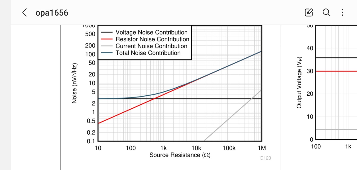

Opa1612 has very high current noise, opa2210 has the same current noise as 5534a but less voltage noise. With low impedance source 2210 and 5534a are nearly similar knowing that my 10k input resistance dominates the voltage noise
