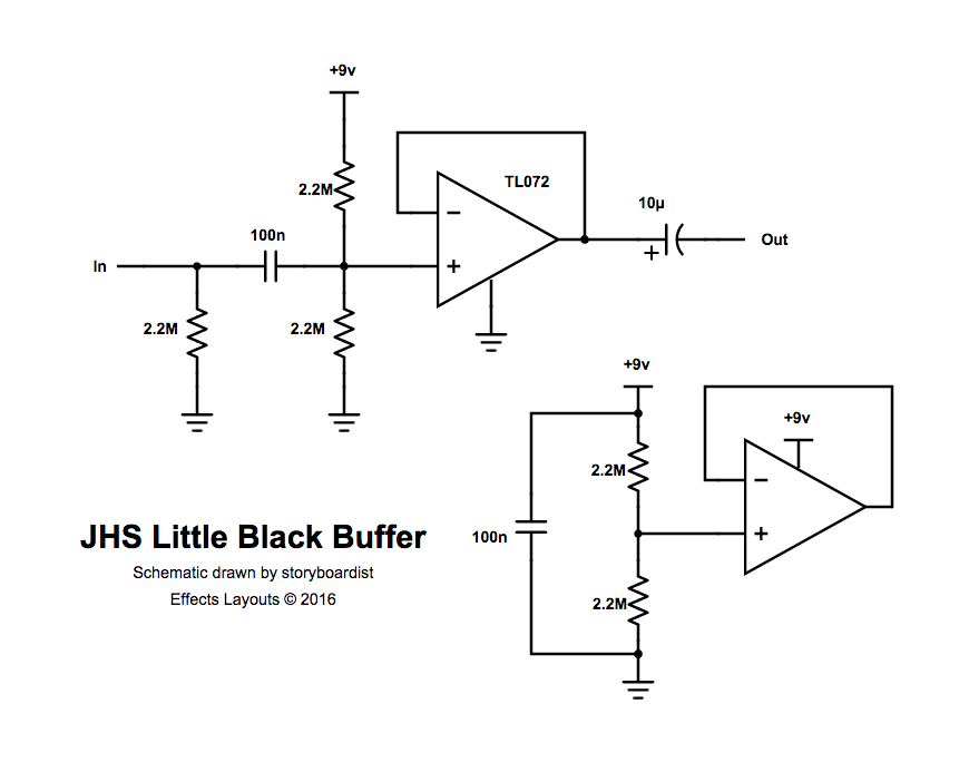

Well thanks to USPS not being able to keep there schedule, maybe I will get to play with that mod board today......seriously hate when things are sent via USPS.
But I did download the data sheet on the Quad Op-Amp it uses (attached).
I found a couple of other "buffers" that some others have used in the EB VP Jr too, also attached.
One thing I do see that they all use is the voltage divider DC offset they add into the circuit, totally understand the concept, but hate that way of doing it.
Much cleaner way is to use a Rail Splitter like the TLE2426.
Small add on circuit....
Less possible noise that way too.
I do intend to publish my circuit when done and a PCB file so others can build their own too.

The rail splitter adds its own noise and eats extra battery power. I do not see any advantage around a simple guitar buffer.
The old +9V standard for stomp-boxes made sense when it was introduced, but only because you could go to the store and easily buy 9V flat batteries.
But even in the 1960s, it wasn't enough voltage. There was very little headroom available. Not a problem when the only pedals on the market were fuzz-boxes, but as soon as pedals with "clean" tone arrived (for example, tremolo, chorus, reverb, etc), 9V became rather painfully inadequate.

I do have the isolated output power supply my pedal board uses, it has two 18 Vdc outputs along with the other eight 9 Vdc outputs.......never even crossed my mind to use a 9 volt battery, no room anyway. (well there is room, but why....cant play my electric guitar without an amp, that's plugged into mains....).
On the rail splitter, this does come down to room on the PCB. Board size is 71mm X 37mm (2.798 X 1.459 for the metric defiant). We have three 1/4 inch phono jacks and a power jack taking up a lot of real-estate, not much room to build a power supply and all the other circuitry needed.
So the 3 pin rail splitter and its supporting cap makes sense, I have used this on other designs. It's way better than injecting DC voltage into the signal path, along with all of the noise it has.
If I use 18 Vdc power that's +9 Vdc and -9 Vdc rails, way more than unity gain will ever need.....but think about the "boost" potential. Heck some pedal power bricks have 24 Vdc out. This makes the power input range 9-24 Vdc....
The Griffin Effect board made it to me last night too, not at all impressed....and they are using a TL074 now, not the TL084 in the picture on their site. Yep, voltage divider into the signal path, no DC blocking cap to the guitar input (wonder if the pickups care about the 4.5 volts on them...).
The whole purpose of the mod is to buffer the tuner and output to prevent loading of the pickups, so why did they put solder pads you have to short for either buffered or direct connection to the input jack to the tuner out? And the goofy LED light..again solder pads to choose color...why oh why?
Not a total loss / waste of money, at least I can use it to check my PCB layout against....and my biggest complaint, where are the instructions......
I now have a semi-plan:
Quad op-amp.
Rail Splitter to keep from injecting DC into the signal path.
Higher quality caps if needed in the signal path.
True buffered in with buffered out on both the tuner and line outputs (unity gain).
Volume control on its own op-amp with possibility of boosting the output.
Any other suggestions?

Electrically speaking, I don't see any difference. Either way, you generate a +4.5V DC rail, halfway between 0V and +9V. There's exactly the same amount of DC voltage involved in either case, no?3 pin rail splitter...way better than injecting DC voltage into the signal path...
Put a decently sized electrolytic cap across the lower of the two equal-value series resistors, and you can easily get negligible noise on the +4.5V node. The +9V should be pretty clean to start with, making this even easier....along with all of the noise it has.

A bit lower noise, I think. Probably not enough to matter.using a TL074 now, not the TL084 in the picture on their site.
I only remember seeing two buffers in your schematic - why a quad op-amp, and not a dual?
No cap? Really? That is an outright design mistake. 😱...no DC blocking cap to the guitar input (wonder if the pickups care about the 4.5 volts on them...)
With the guitar volume at full, that puts the DC resistance of the guitar pickup in parallel with the lower of the two resistors in the voltage divider. You won't get 4.5V bias any longer - you may get very much less, depending on the resistor values in the voltage divider, and the guitar pickup DC resistance.

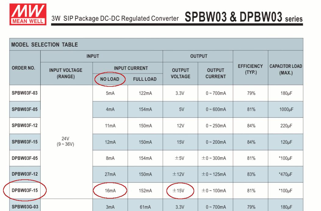

Going to leave this here for future discussion.....CUI PDQE20-Q24-D15-D
https://www.mouser.com/datasheet/2/670/pdqe20-d-1595964.pdf
Back to the research I went, all good points Gno.
The reason for the post above was to remind me to look up this....
DPBW03F-15 MEAN WELL USA Inc. | Power Supplies - Board Mount | DigiKey
+/-15 VDC out at 100mA, more than enough for the op-amp and other needs. 9 to 36 Vdc in 152mA max, most any pedal power brick can do this.
Much better than the rail splitter (only reason I knew about that was one project years ago that used it, a RIAA pre-amp that I built. Totally forgot it still had the "floating voltage one virtual ground....old age, lol).
And I think we cover the 10V peak pickup discussion too.....
Some may be thinking this is way overboard, probably is...but I really don't like sound being "coloured" by electronics that are not designed to do so, a volume pedal should just be that...and when this EB VP Jr sucked the tones away because I plugged in my tuner well it was time to fix it.
My other pedal effects can add the clipping or slewing of the sound, not this one.
Why a Quad, section one is the input buffer (to keep the input impedance stable). Section two can be volume and or gain (still haven't decided if a little boost would be nice or not). Sections three and four are the output buffers (tuner / out).
2 Watt max out. For one/few opamps this is gross over-kill. Like buying a 20-passenger bus to haul you and your lover. (Yeah, my neighbor does, but also to take motorcycles to Florida.)
Since we are not talking gallons of gasoline, the idle power "may not matter". However 150mA here 150mA there, collect enough toys and eventually your 1,500mA pedal-wart conks out and dies. Is there a 1W or 0.5W series of the same idea?
Agreed. (Actually it's 3W, a bit worse than you were pointing out.)2 Watt max out. For one/few opamps this is gross over-kill.
But: no-load current is only 16 mA at 24V DC input. (The datasheet doesn't say if or how that changes at 9 V DC input.)
This isn't wonderfully low, but maybe not terrible either - 16 mA is equivalent to worse-case current draw from a single NE5532 with no load on its output (TI datasheet.)
Even 16 mA is a bit much for use with 9 V flat batteries, but should be no problem with a 9 V power brick. For a number of years I've used a little One Spot 9V brick, bought for maybe $15 USD. Even that little PSU is rated for around 2 amps max output.
I would say the size is very nice, the price is very nice, and the idle current consumption is acceptable in some use cases. I wonder what the RFI issues might be like, though, if this is mounted in the same housing as the FX pedal?
-Gnobuddy
> Actually it's 3W
Actually, the first link is 20 Watt, and I slipped a zero when typing.
No strong objection to 3W parts.
