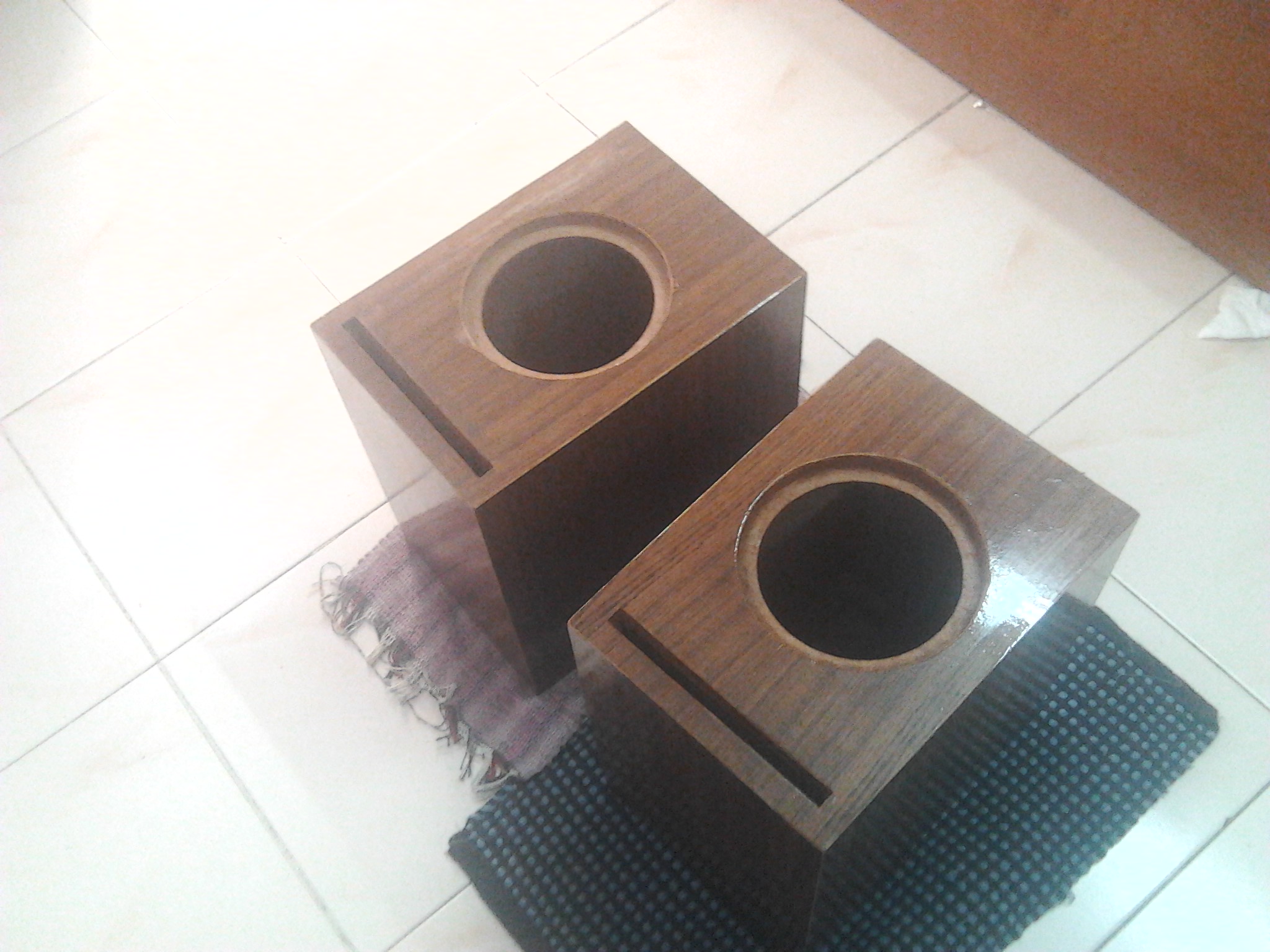

any reason going for bookshelf speakers? initially i planned to couple these boxes with woofers in 2way setup, but now after listening to them i have decided to go for pencil design as these drivers alone can handle lows pretty nicely. no woofer necessary.
I decided to use this design because it appears that Mark is using it as his reference enclosure. If there is an issue with bass (fully anticipate one because of my preference for classical music performed by a full orchestra) I have some subs that I can bring in under them.
this box attracted me for the same reason you mentioned. apart from that its very simple!
its bass performance is very good. clean and smooth. not sure adding a sub will be good as this driver alone in pencil can reach 30hz in room. go ahead and build these tiny boxes and you will be happy. for even better bass, i read pencils are recommended.

pencils are not big and not small. just of the size that my room can take without complaining (in other words...allowed WAF! )

I'm using Erich's box design upstairs with MAOP 10 drivers. They are OK, bass is a little tight, the vent needs to be a little bigger but no time to re-calculate/re-make.
As per others comments, to get the best from the Alpairs, use a bigger box (Pensil et al.)

today stuffed the boxes with 1" thick glasswool. not sure if this is too much but thats what i have at hand. there is considerable improvement compared to 1" think egg foam. glasswool does the job better!
i used 19AWG OFC wire for internal wiring and also for amp connection. is there any advantage going for lower AWG wire in this case?
do pencils increase SPL? i see similar MLTL by Bob (M10-A10) mentioned SPL to be 90dB which is 3dB more than the driver spec.
Only in their operating band, at the bottom of the frequency range. It depends on how you measure them TBH. And the MA units are a little unusual compared to some others in that they're usually somewhat easier to drive than the bald figures might imply.
19ga should be more than sufficient for internal wiring by the way. As for fiberglass, I'm not surprised -acoustic foam (egg crate foam / whatever you like to call it) is rubbish as far as I'm concerned. One point though: you might want to get some muslin or similar stretched behind the driver to prevent fibers getting into it.
thanks for muslin tip. despite of careful cnc cut baffle hole/flush mounting, still i feel there is edge discontinuity, so thinking to glue felt ring around the periphery of bezel edge. will this actually work?
Pantyhose works very good and is pretty much acoustically transparent.
