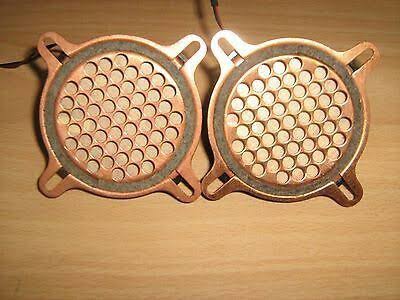

I tried out a vintage pair of Siemens electrostatic tweeters, to assist with vertical dispersion.
Lucked out, they are audibly a good level output match with the mini panels, unobtrusive on axis, and maintain a good treble balance above the panels.
They are monopole, and include internal transformers.
