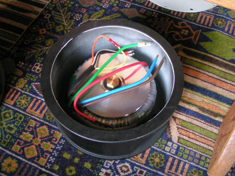

For power amps, a nice big round steel foot does the trick.
I made this one myself, and the amp has been held away from the floor for several month by now.
I think if it does not hit the floor in another couple of month, I'd say it's a real good equipment foot.
Sounds fantastic, with an open sound stage, and great transparency, maybe lacking a bit of air, but not much.
Ohh, and it contains the PSU as well, neat huh?
See pic.

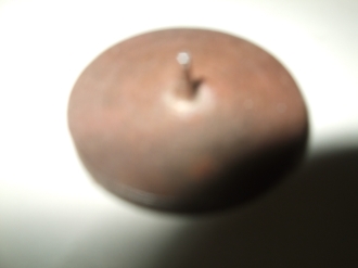

I made some simple feet many years ago from 25mm steel bar.
Mount the bar in a lathe and machine a simple point with a parting off tool , then slice off the back disc with the same tool. The points were case hardened.
I place 3 of them under the equipment point down. The disc makes them self-aligning.
Easy, simple and safe.😀
