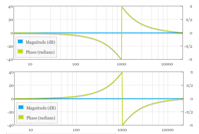

Does anybody know how to create an inverted all-pass filter in EQ Apo? (just like the compensate all-pass filter in rePhase)
In the documentation link I see only normal all-pass.

Hmm... dunno if this trick is OK or works (Example):
fs=44100, fc=1000, Q=1/sqrt(2)
b = [1.2232 -2.2007 1.0000]
a = [1.0000 -2.2007 1.2232]
b = [0.81751 -1.79910 1.00000]
a = [1.00000 -1.79910 0.81751]
You can try these coefficients with EqualizerAPO custom IIR command.
If trick works then I'll share it.

Plots well but is unstable (poles outside the unit circle) ...
"Generally, strict all-pass filters have reciprocal zeros and poles. This will always result in 180 phase shift per filter order"...
