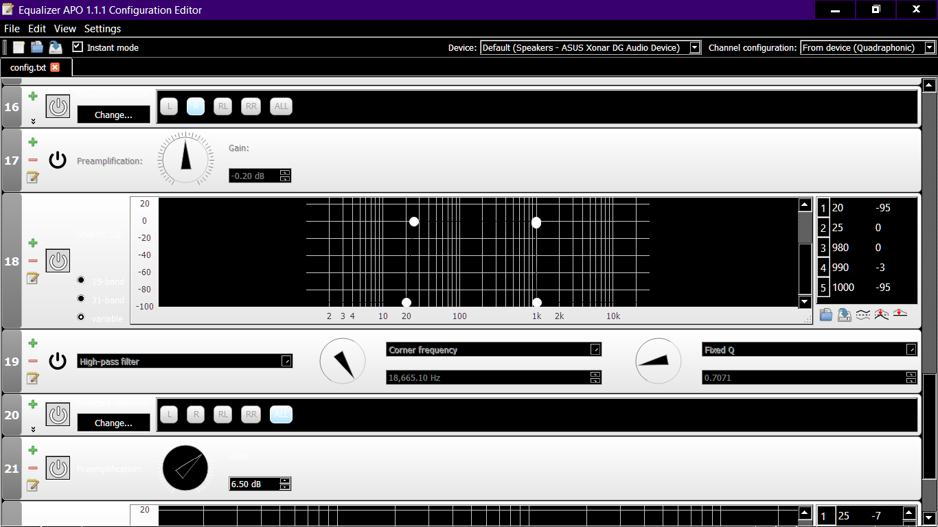

You can also change in EQ Apo quickly if you edit config.txt file, just have in clipboard prepared different setup, change the file, save it, and instantly it is active configuration.
I am very aware of this. It's still more work than changing setups with pedalboard. It really is 4 mouseclicks to replace the whole setup with another pre configured one. Very handy when comparing different xo slopes.
Ryan:
That was my intention. To use eqapo for phase corrections only, but still stuck in happy mode after finding some good xo settings, so not very motivated to make the final measurements needed. It's on the (very) long list of stuff to do though.
You can do that in EQAPO with include files. 2 clicks, actually.It's still more work than changing setups with pedalboard. It really is 4 mouseclicks to replace the whole setup with another pre configured one.
I did not know that. Is that if you choose to use the gui?
I am not compatible with the eqapo gui, much easier to edit the text files.

What I had in mind was building 2 additional config files with the different settings. After including BOTH in config.txt, you can simply choose which one is enabled. This is 2 clicks in the GUI. If editing config.txt manually, you'd need to comment the appropriate line & save, obviously.I did not know that. Is that if you choose to use the gui?

You can also do this with one double click on a desktop shortcut. Just create shortcuts to batch files that simply use the copy command to overwrite config.txt
eg: copy /y config1.txt config.txt
Thank you for this. No need to open the gui at all. 🙂

Trouble getting EqAPO to work
I having a hard time getting this software to work properly as an active crossover. I'd like to power my 3-way speakers through a 7.1 receiver (Pioneer VSX74-TXVi).
My file syntax is below. I receive weird results with the treble and midrange, but the bass seems to work just fine. Anyone willing to take a look? Note that I have not measured my speakers yet, so this is a quick-and-dirty attempt at a crossover. I am reading Joe D'Appolito's book on how to conduct measurements properly, and also working with VituixCAD.

This is what I do on my two way set up. The soundcard is set to quadraphonic so theres no center or sub channels. I think it will work with more than 4 channels but haven't tried it.
Copy: L=L+RL R=R+RR
Copy: RL=L RR=R
This mirrors the rear channels with the front.
Then I use a channel selector, an equalizer and preamp on each of the channels to control the two sets of drivers independently.
Last I switch the channel selector to all and use an equalizer to apply baffle step.
After some experimentation I've found that just a straight drop (infinite slope) down to -95db sounds the best. Overlapping the drivers creates lobing which hurts imaging (unless drivers are playing low frequencies)
I've attached a picture of a woofer.
Copy: L=L+RL R=R+RR
Copy: RL=L RR=R
