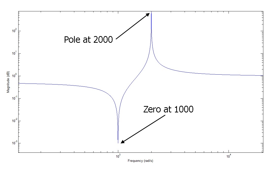

I don't see how it applies when we have a collection of data points that we need to fit.
What I meant is:
If you have a function of frequency, it is possible to find exactly where the function has poles or zeroes. But, since measured response is just an array of complex numbers (constants) and not a function of anything, you would have to fit a function to the said response and then analyse that function for poles and zeroes (which should be straightforward).
Thus, if you can somehow "fit a function" to match a measured response, I could easily show you the poles and zeroes on your screen.
Can you explain or expand on your proposal?
For the time being, let's just assume that you've somehow managed to find (or fit) a function that tracks the measured response. And, just as sweeping across the frequency range would give its Bode plot, sweeping across the "complex frequency range" would give clear visual indications for all its poles and zeroes.
For example, if F(s) = (s+1000) / (s+2000), please see attached picture.

What I meant is:
....you would have to fit a function to the said response and then analyse that function for poles and zeroes
Yes, but how to "fit a function to the said response" is exactly the problem!
Once I have fitted a rational polynomial then the poles and zeroes can easily be determined.
If all that you need is transfer function, which can be converted to poles and zeroes...in the z domain instead of the Laplace domain, then this often works: Precise Filter Design.
