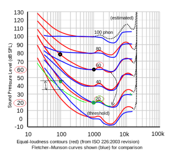

You don't need time average, just the loudness ratio between live/playback at a reference frequency. Think about it this way:
- the original source (say a piano) plays a 1000Hz note at say loudness 60phon. According to the 60phon equal-loudness curve in the FM model, this requires 60dB SPL.
- same orchestra now plays a lower 100Hz note, equally loud: according to the 60 phon curve, at 100Hz it takes a higher SPL to generate the same loudness sensation, around 75 dB.
- now you are playing the recording of the above such that the 1000Hz note plays at 20dBSPL, 40dB lower that "live". The 1000Hz note is now 20 phon loud (corresponding to 20dB SPL at 1000Hz)
- this means that now the 100Hz note plays at 75-40 = 35dB SPL.
- however, in order to preserve the same 20 phon loudness of the 100Hz compared to 1000Hz you would need to follow the 20phon loudness curve and see that it would actually require ~45 dB for the same loudness. That is 10 dB higher than uncorrected !
Because the phon scale at ~1000 Hz roughly corresponds to the SPL scale, the correction you need when lowering the SPL from "live" levels to playback can be obtained by superimposing the 2 equal-loudness curves at 1000Hz and computing the SPL difference elswhere (see picture).
Now comes the part where you need to "scale" sounds of different loudnesses this way. Generally, as you pointed out, that would require a different correction for each loudness. But: if, in addition, the equal-loudness curves are equi-distant at all frequencies, then the absolute loudness level is no longer relevant and the difference between 2 curves which are say 10 phon apart at 1000 hz is the same no matter their absolute level. This is key for implementing a "static" equalization and, according to the ISO model, - but not to the original FM model ! - a reasonable assumption.
Unfortunately, the live vs. playback loudness ratio is content and recording dependent and cannot be trivially computed out of the recording. Secondly, the recording contais some equalization which is difficult to factor in. If you solve this problems, you can, in theory, implement accurate loudness correction.

That is precisely because IMHO nobody did it right so far, for the reasons I outline in the previous posts. You need to know the the original-to-target ratio and assume that the curves are equi-distant (they are in the ISO model, which is pure-tone based, but who knows how accurate that is for music ?)
