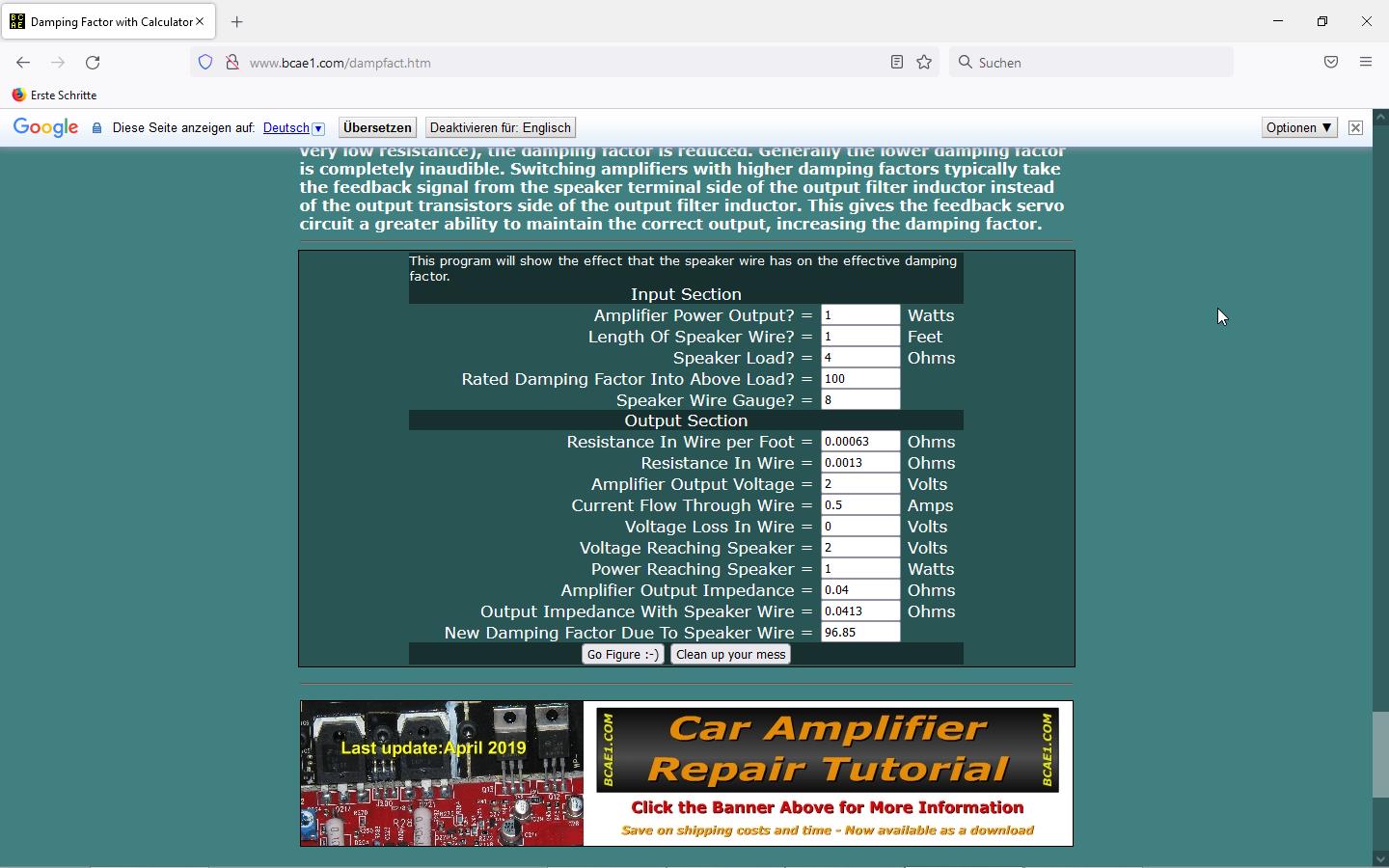

Just this. Each Cable has a resistance, right?
Each material in a cable has a resistance, right?
Do you think, increasing the length of that material would increase resistance?
I give you a link where you can see this in FACTS.
Damping Factor with Calculator
Then scroll down until you can see that picture I send with this
Then change the to three to following 1 1 4 100 24
24 is the gauge of a Tweeter Wire for about 25 Watts..
hit "Go figure and read the outcome" Now change the length of Speaker wire to .5 and look whats happen. And read all these Parameters, it might be interesting for you. it is certainly for me.
This will show you that length matters.
May you like to read about AWG some to compare with resistance. If there is a change in resistance for 1meter the change will be there for 1cm as well this is 1/100 of a meter.
AWG Wire Gauges Current Ratings
If the length of the cable differs and the diameter does NOT differ, also then Length matters.
I do not have more or better examples than this. So, Thank you for this interesting communication.
BTW I didn't write this what you can read in all these links, I just pasted them for you.
To accept or not accept that is up to you, and not all what one reads on sites needs to be true. This also counts for myself. But I did measurements, and I have to equipment todo so here at home.. and if wouldn't had run into problems, then I would not write here.
But may I'm completely wrong. That's another possibility. So,no offence meant..
Have a nice sunday.
Respect Regards
Chris Hess
Nobody disputes the fact that every conductor is imperfect and has electrical resistance. Silver is the best common electrical conductor and copper is also pretty good, Aluminum, steel and gold are not as good but have some other properties that make them useful as wire.
The length and diameter of a wire will determine it's resistance, and of course a longer wire will have a higher resistance than a shorter wire. It is well known that long or small diameter speaker cables will cause power loss, just as a long extension cord will cause a drop in line voltage to a high current load.
Any resistance in the path between the amp and the speaker will influence the damping factor seen by the speaker, as does the components inside the speaker cabinet itself (crossover network).
All of the above statements are based on sound engineering principles and not disputed. Whether or not they make any difference in a typical home HiFi setup (especially a few cm of wire inside an amplifier) is a matter of personal opinion and marketing skill.
