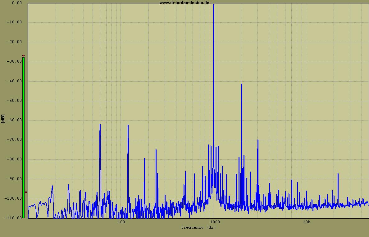

Then consider other sources of a signal with which we can intermodulate. One of the most important will be the 100Hz (120Hz in the US etc) residual power supply ripple
This is a big part of an amps sound. Ever get an old Fender Champ to growl. Under the right conditions lead guitar cranked into distortion, but not to extremes will tax the wimpy power supply enough to cause some pretty serious 60 Hz, 120 Hz and 180 Hz ripple. The wimpy OPT and smallish speaker doesn't reproduce the 60 Hz, and the 120 Hz is masked by the cranked guitar, but the IMD created by the power supply and guitar notes create a growling lead sound. Many clones use larger values electrolytics in the power supply, and thus don't growl.

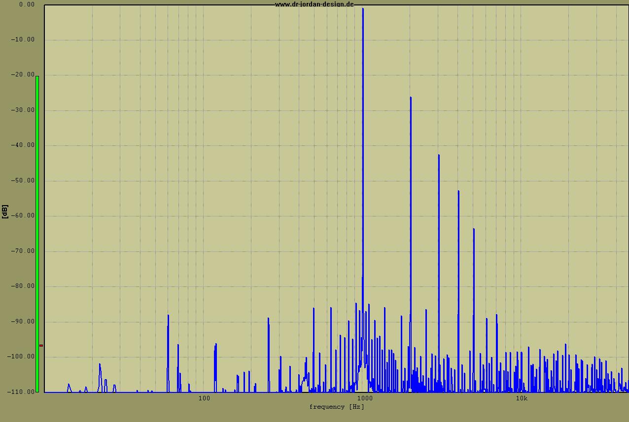

Here are the FFT's from two amplifiers that I built about 12 years ago. Both are SE designs, one, a TSE with 45's makes 2 WPC, the other an 845 SE makes 40 WPC. Both amps are DHT's with DC heating. The 845 amp actually uses a duplicate of the 45 amp as a driver, with a 3rd stage added.
The power supply in the 40 WPC amp is taxed to produce 1100 volts at 200 mA using a voltage doubler made with Sovtek 5AR4's. The power supply IMD products are about 10 db larger than the 2 WPC amp. The big amp is awaiting a power supply redesign. The little guy still gets used quite a bit, but the CRC power supply became a CLC bower supply with better caps about 10 years ago.
The 845 SE amp sounded nice, but listener fatigue sets in after an hour or so, as you stated it's worse with complex music.
