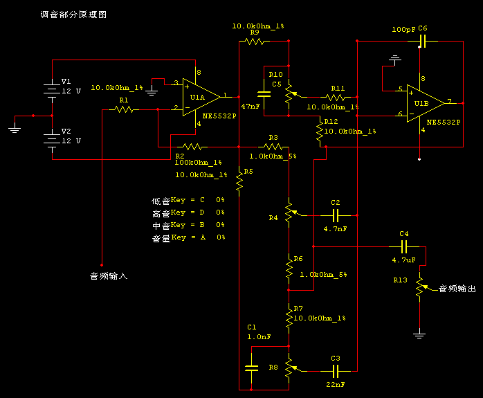

Thanks for that info, Duncan Amps looks like an awesome site, it will make a great referance page. The design I am working on is a front end for an amp that will be used for with an emulator so I would like a fairly linar resopnce with as little coloration as possiable. I have attached a potental design as an example, I am testing this circuit now. I am lwill most likley look for an active design and go with that.

The typical 3-band Baxandall looks like a potential candidate, likley would need to tweek the crossover bands to make all three bands useful, thanks for that info....

Sounds then like you don;t want a guitar amp tone stack, you want more like a hifi stack. Not my area of expertise. Instead of looking specifically for tone controls, maybe also look into graphic EQ circuits, make them low-Q enough. Or for that matter, three parametric circuits set up to meet your needs.

If you're running an emulator into it, then you probably want something closer to the tone controls on a mixing console. As you can tell from Duncan's app, regular guitar tone controls have heavy speaker EQ built in. I assume you'll be using a FRFR speaker? (Full Range, Flat Response)
