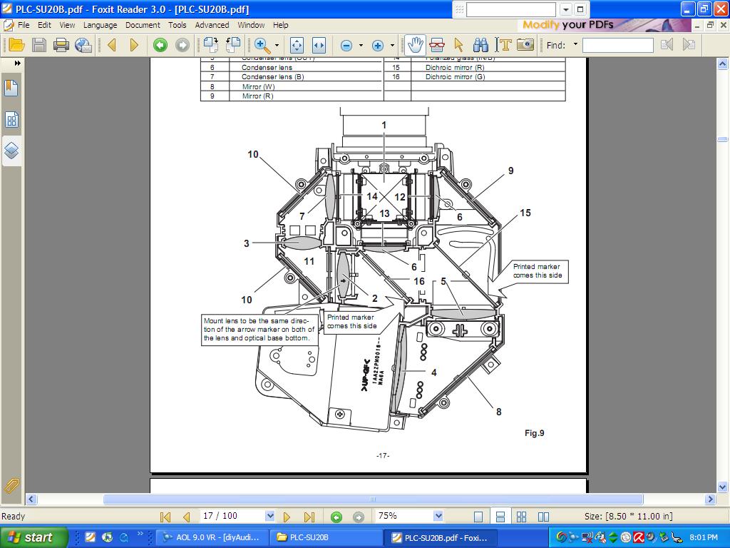

Nope I think not. Mount one LED panel behind each of the three (RGB) panels/They are ALREADY lined up. All you need is a light source. It has nothing to do with controllers. All the mirrors do is channel the light beam within the projectors light chamber after it has left the lamp and gone through the fresnel/Fly eye lens. People have already tried to retrofit a single source LED but it is always to dim to compeat with a UHP's beam. I am suggesting trippling the light power and placing it much closer to the output lens.
I have attached a diagram of what I am talking about. You can mount the LED's at point 6, 6 and 7. So they shine into the LCD's at point 12,, 13,, and 14 . The rest of the light engine would not be needed as it is what is used to bend the light around the inside of the projector. also the 3LCD have a fan already mounted below them that could be used to cool any heat the LED's produce. You can also channel any exhast heat the LED make through the now empty light chambers with a small boxer fan
Bohanna

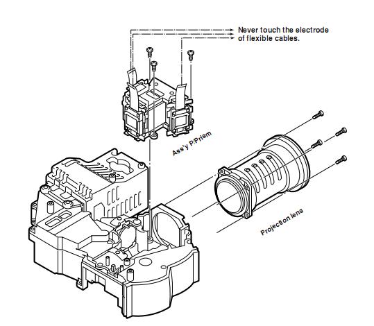

another prism shot
Here is a another drawing and view of the actuall LCD prism array. It is from a different projector but it is pretty much the same.
Bohanna🙂
Currently I have the light tunnel removed completly and will try led's with lenses going right into the 3 LCD panels. Pics soon...
Cool!! If you want to get a better set of picts of the projector I uploaded Try Googleing PLC-SU20B.PDF service manual and see if you can find it. Make sure you get the SERVICE manual and not the user manual. It has a very detailed set of drawings Here is the link to where I got it.
Service Manual free download,schematics,datasheets,eeprom bins,pcb,repair info for test equipment and electronics
Good Luck
Bohanna🙂
I am gonna start with 3 200 lumen luxeon LED's one for each color. The image will be in greyscale but its brightness were looking to test for now. I think some sort of Lens will be needed but we will see. If no lens is required I can work on an array of colored LED's.
