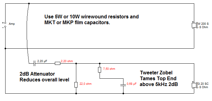

I read up last night an introduction to crossover design and yeah it seems pretty logical for simple hi pass and low pass filters with 6dB/octave slope.
I was thinking I could add a low pass to the woofer as it hasn't got one.
But then again I would rather put the effort into shiny new speakers.
The Epos has a design that doesn't really need a bass filter.
It probably depends how good your ears and experience are with these sort of mods.
A harsh metal tweeter will probably most benefit from a Zobel at the top end.
An overly bright tweeter will need a little attenuation.
A single 2.2R resistor will only really reduce the very top end, rather like the Zobel.
Using both resistors and a Zobel will probably do too much, and take the tweeter down 4dB.
But what you may be hearing by way of harshness may be breakup coming from the bass unit. It's tricky.
The 2R2 I have fitted goes before the 2.2uf cap where I have fitted it. Does it make a difference?
The additional 22.0 ohm resistor would make an L pad wouldn't it? Does it matter that network is fitted before or after the cap?
Also the resistors I ordered were metal film 5w, not wirewound. Is that ok?

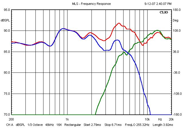

I dug up the frequency response of the similar Epos M12.2 here.
I think my comments still apply. From what I am reading, the tweeter gets a 2.2R resistor in later versions to tame the top end.
The Zobel is guesswork and I calculated it with a typical 6 ohms DC and 0.05mH. I see the tweeter is actually 5 ohms DC from the review. You should measure it with a simple multimeter. But you won't break anything with the values I gave.
Impedance Equalization (L-Pad) Circuit Designer / Calculator
A harsh metal tweeter will probably most benefit from a (7.5R/0.68uF) Zobel at the top end.
