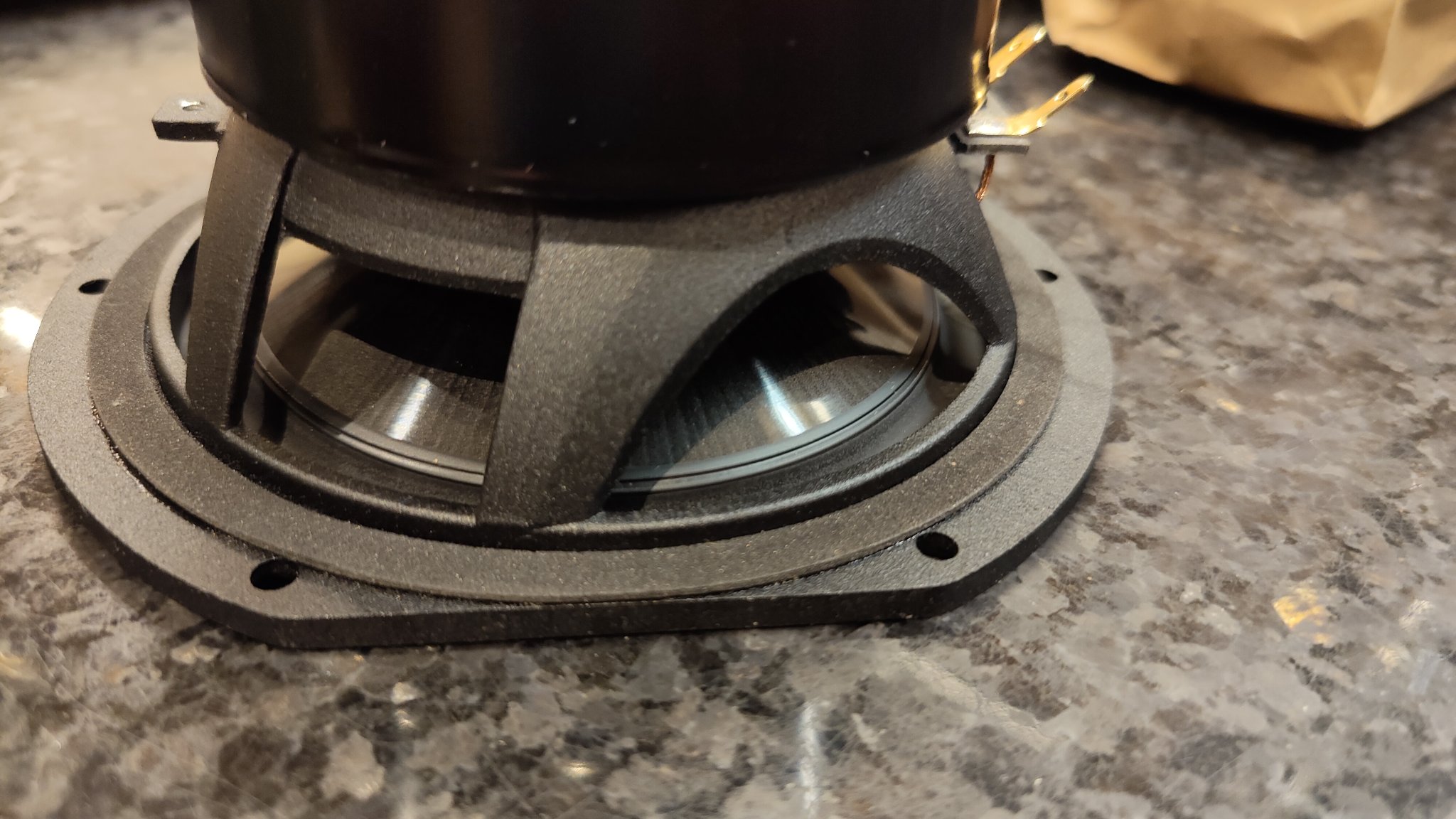

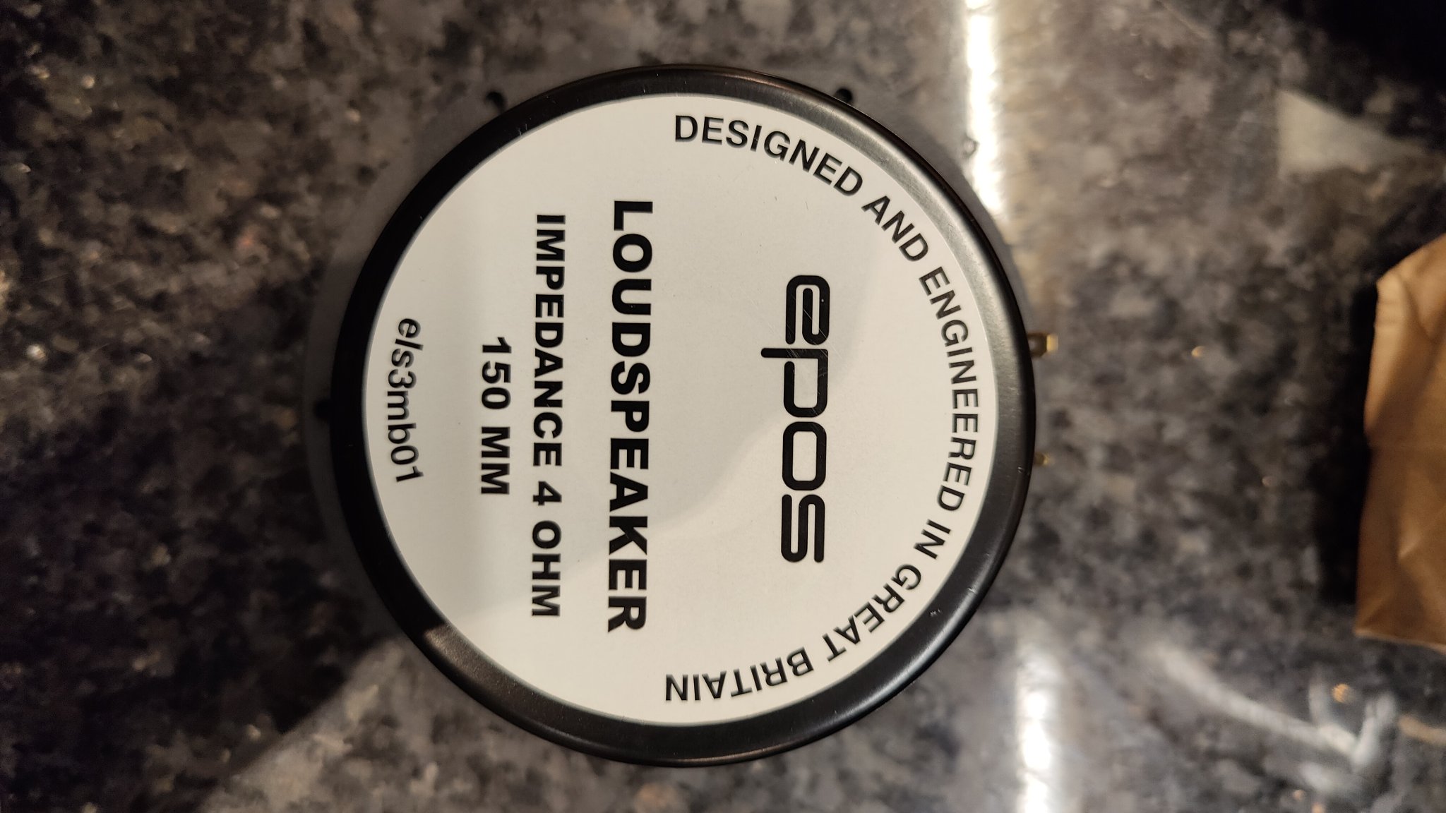

I bought a pair of these new unused, just out of interest. EPOS seem to have a following and they seem to employ simple XOs, so I am hoping these are quite easy to implement.....into what I don't know yet!
Anyone know who made them?
Part no. ELS3mb01

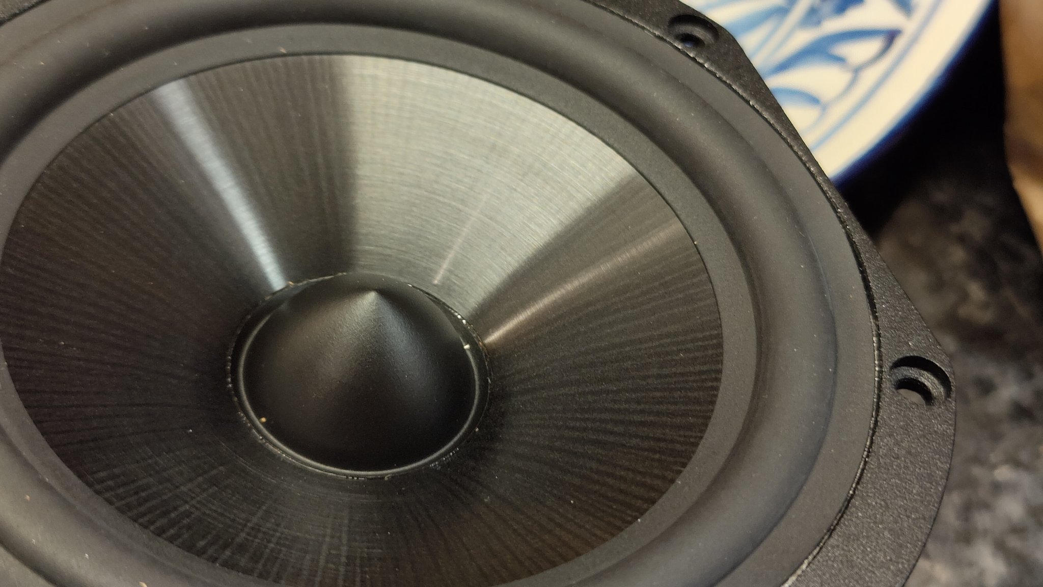

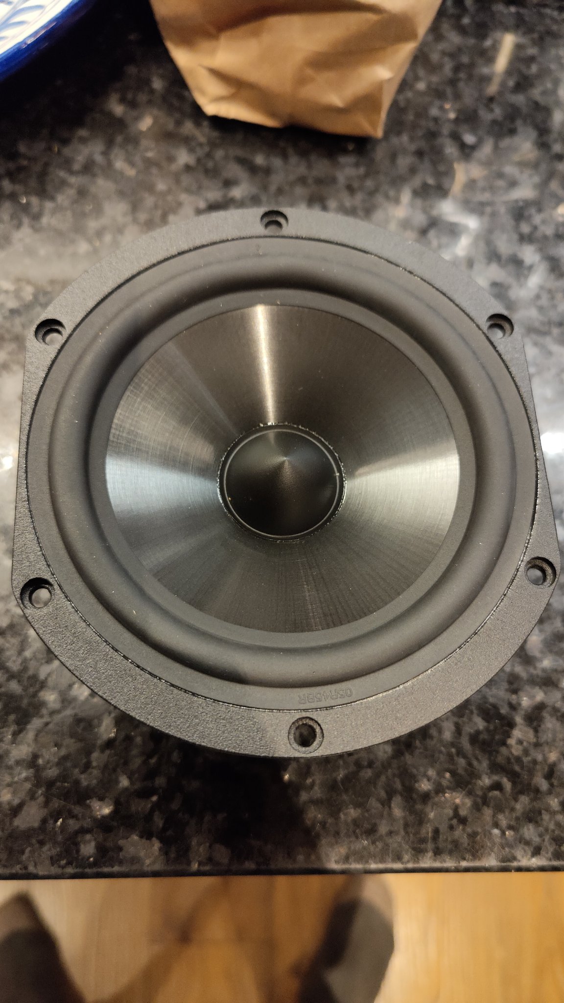

They're a 4 ohm driver. Cast chassis. Not sure if the cone is aluminium, though it doesn't feel cold enough as it's been sat outside?! Maybe a coating.
Nice looking things and seem well built.

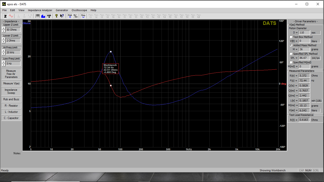

TS Params to follow.
The low order xos would be bad to combine with a aluminum cone/breakup modes typically.
The cone is made from polypropylene / moulded plastic. Possibly with Mica fill as that is what they do these days.
They're driver are "unique" for Epos. Wether assembled from parts or bought as a OEM part from mfg. I dont know.
Don't know the mfg. So cant answer much more without research
