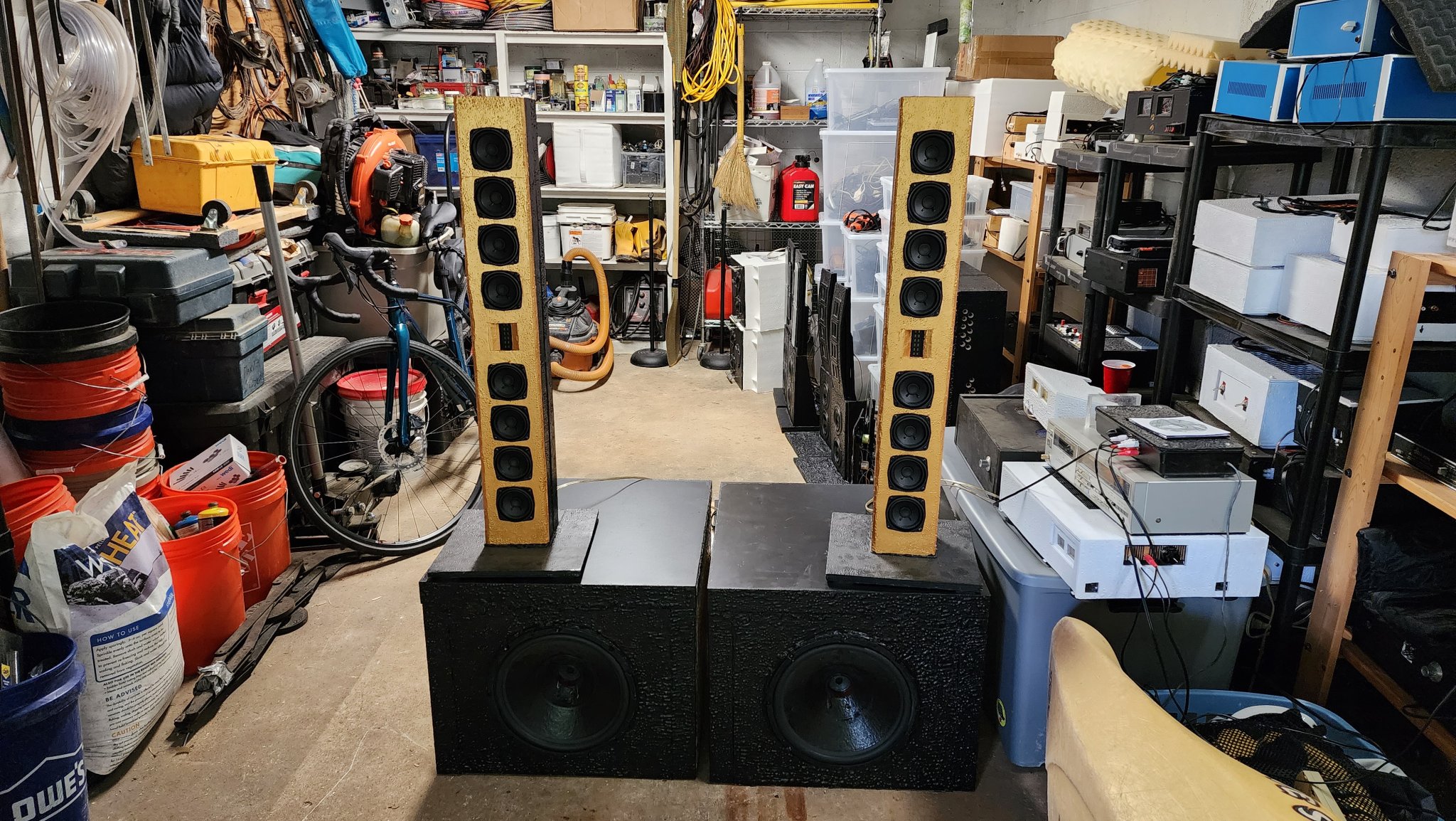

I am quite surprised by the sound of this cheap WMMMmtmMMM speaker. Top is 2.5 way for better coherency. System is biamplifier with 150Hz active crossover.
Reactions: 1 user
