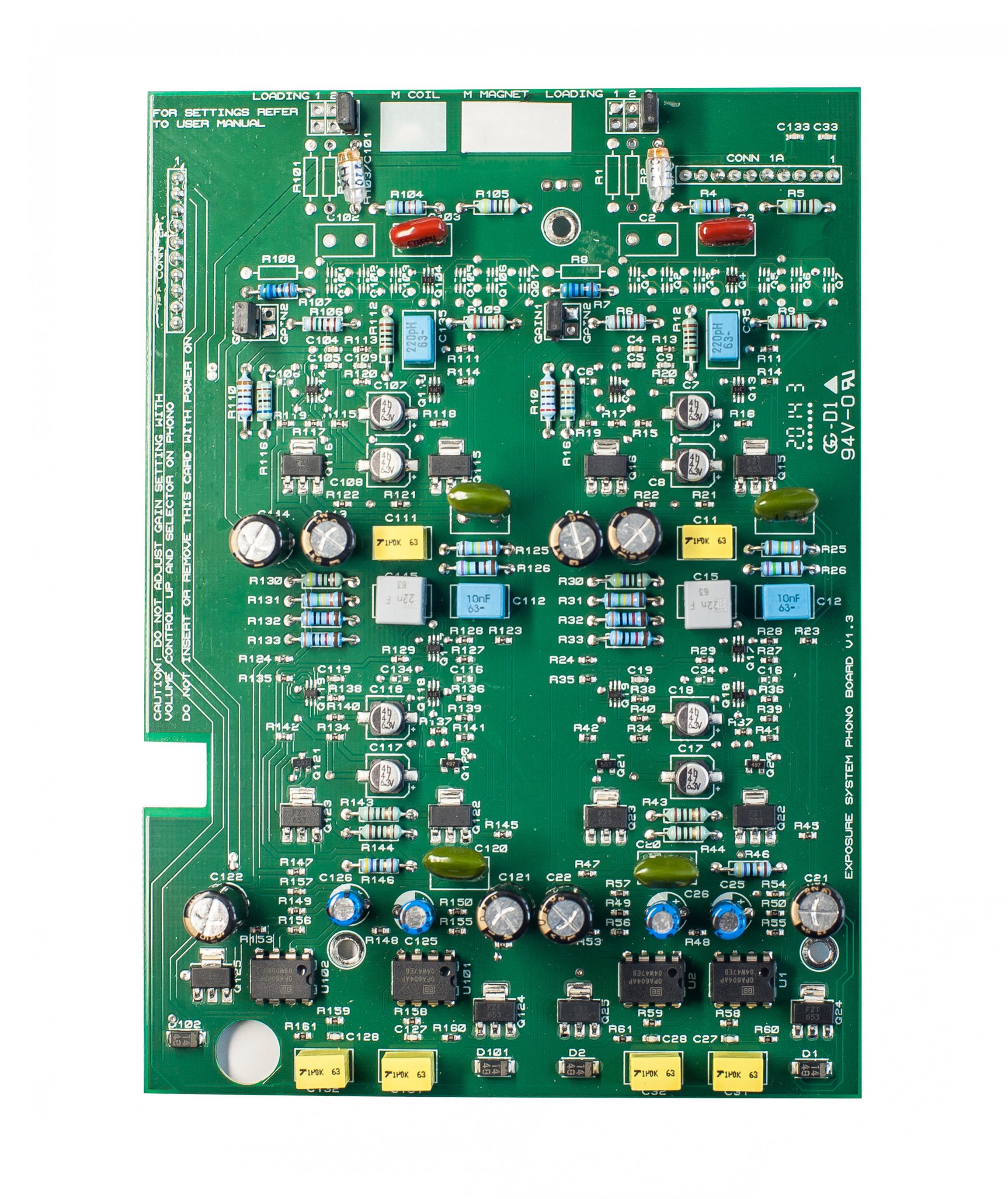

I would like to change the integrated amplifier to my Exposure 3010S2 and get a MM board upgrade to it. In the amplification point of view it's a reasonable upgrade to sound. I could listen a bit louder. In the phono section point of view, is the Exposure better sounding than Rega?
Considering that the Exposure costs three times more than the Rega, I would hope it has the more refined phono stage.
However the following extract from a review states that the Rega Brio-R has an excellent phono stage - for the price!
The phono stage delivers a great performance too. It’s impressively transparent, and consistent in character to the line stages. And that means that it’s vastly better than what we usually hear – or expect – at this price point.
